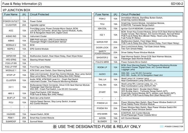

I am not able to get a reading off of the obd 2 port. it activates the scanner and does the scan but comes up with a error message which I think it isn't making a connection when plugged in.
Jul 11, 2022 at 8:13 PM
  • 55,224 POSTS

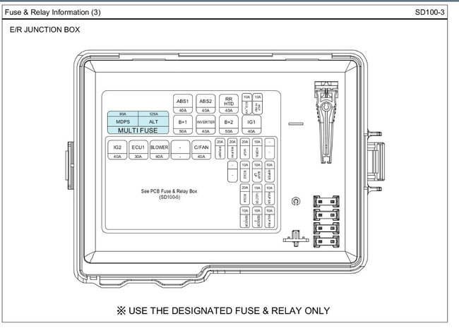

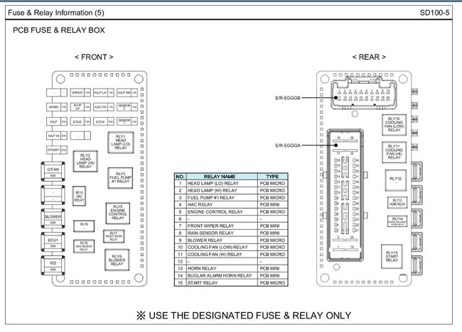

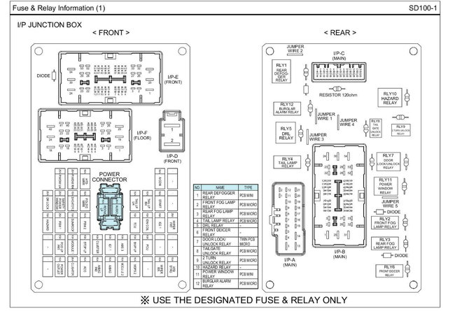

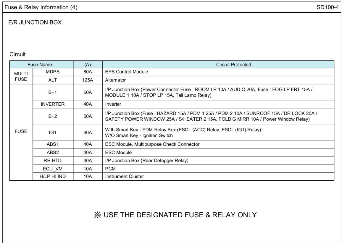

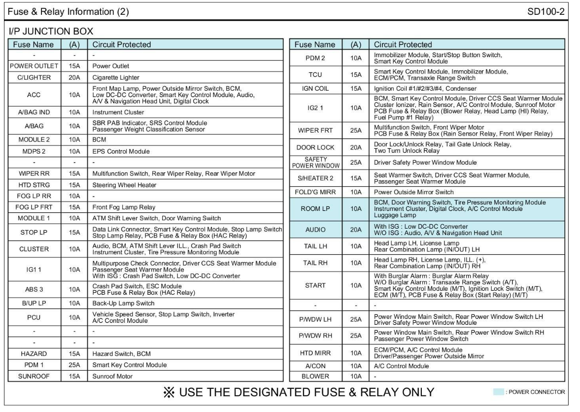

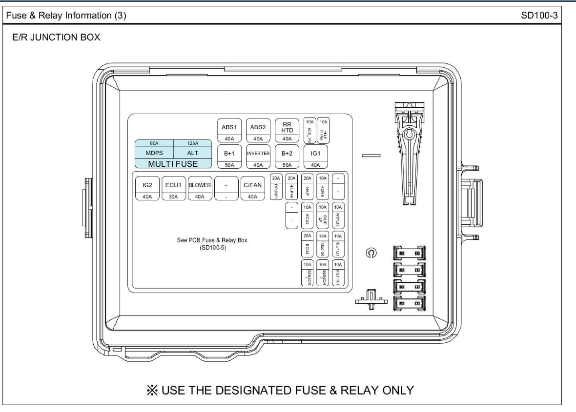

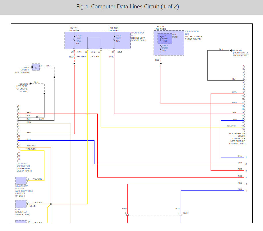

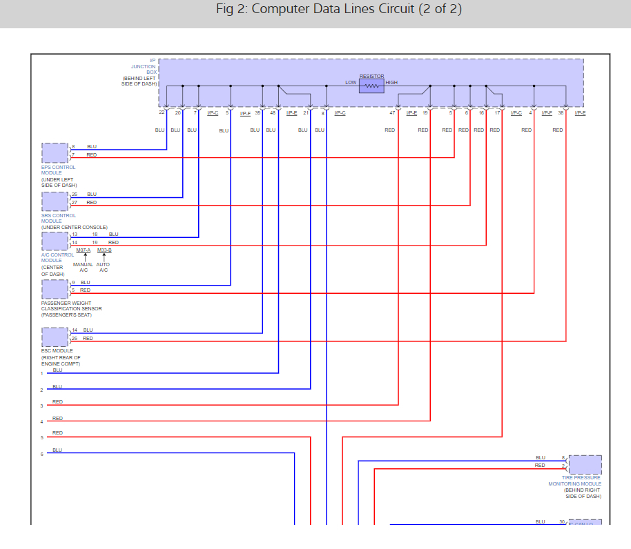

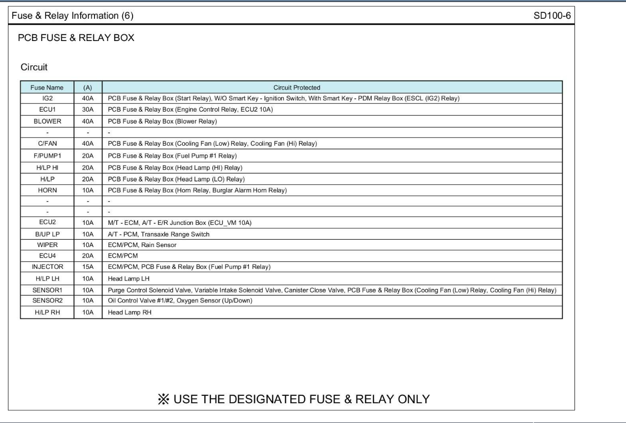

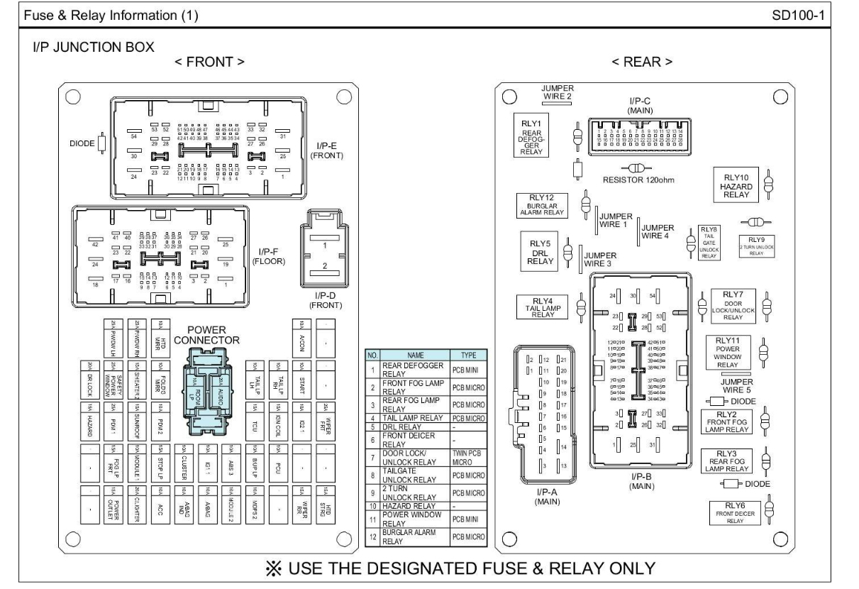

The first thing you want to do is make sure the scanner reads in another car to confirm the scanner operation. If so, then let's look at the fuse (stop lamp and NGI1 fuse in the interior fuse panel.

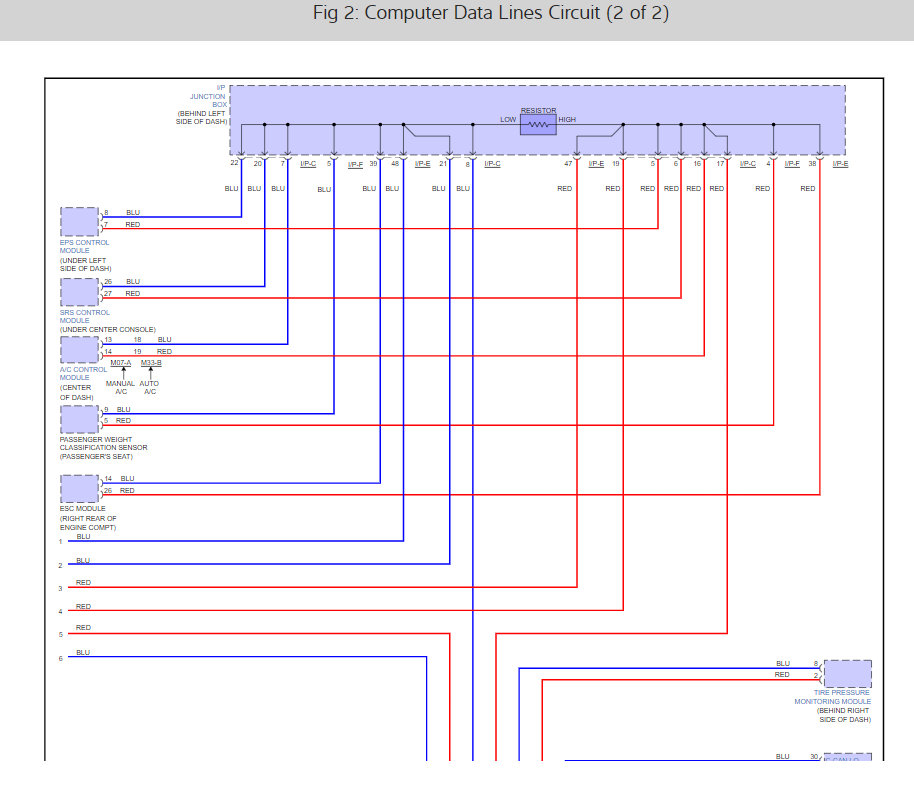

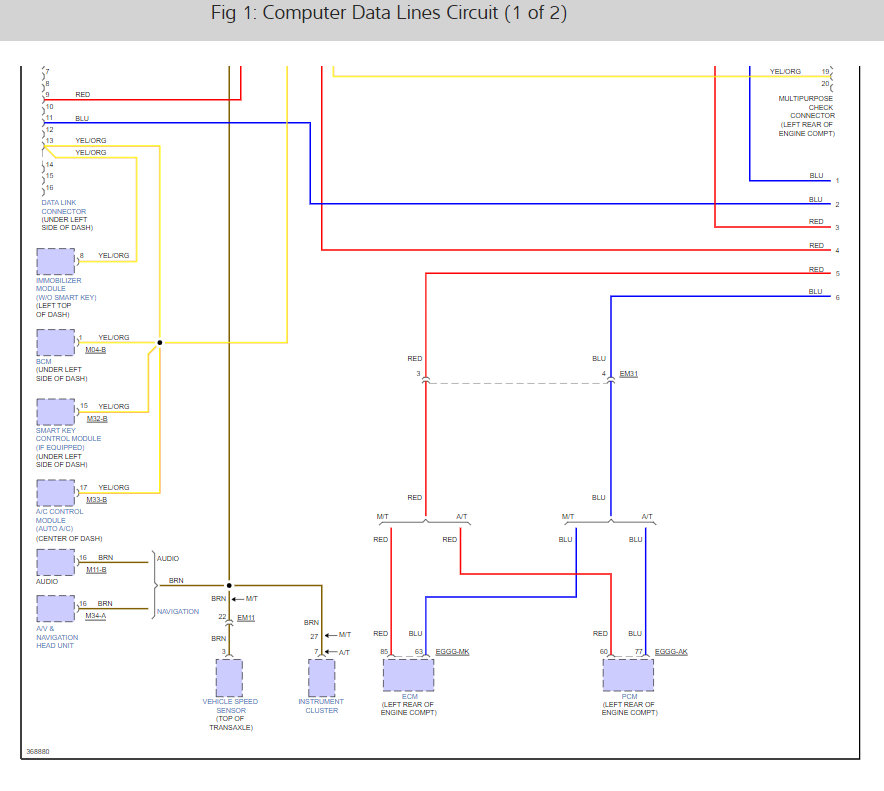

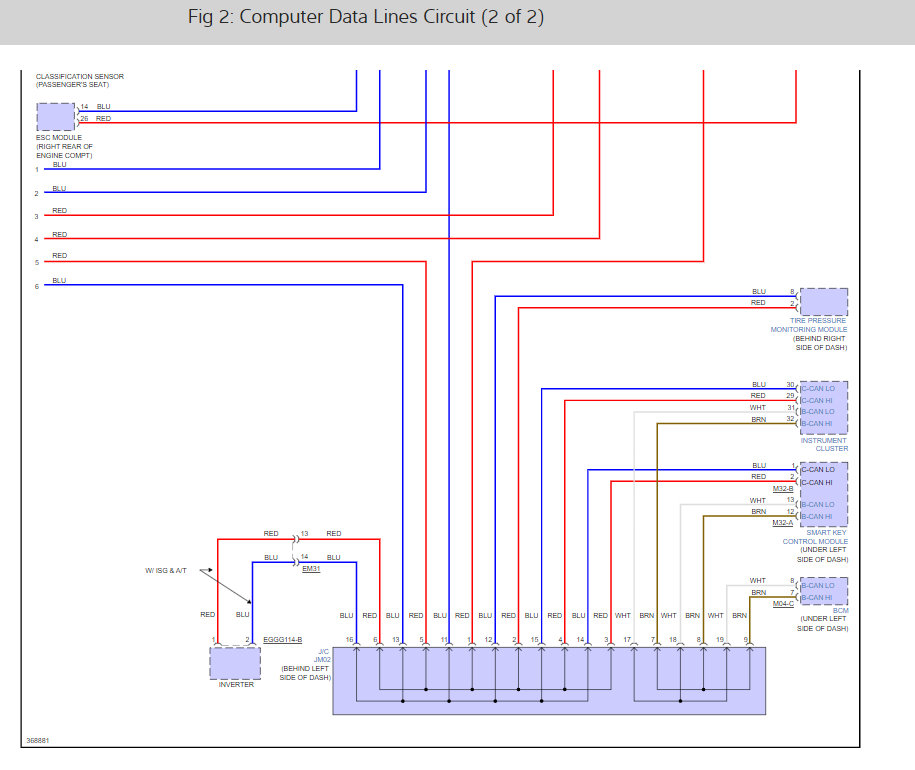

Here is a guide to help and the wiring diagrams so you can see how the system works and the fuse location as well:
This video can help:
https://youtu.be/6Tlg3JmgNSQ
