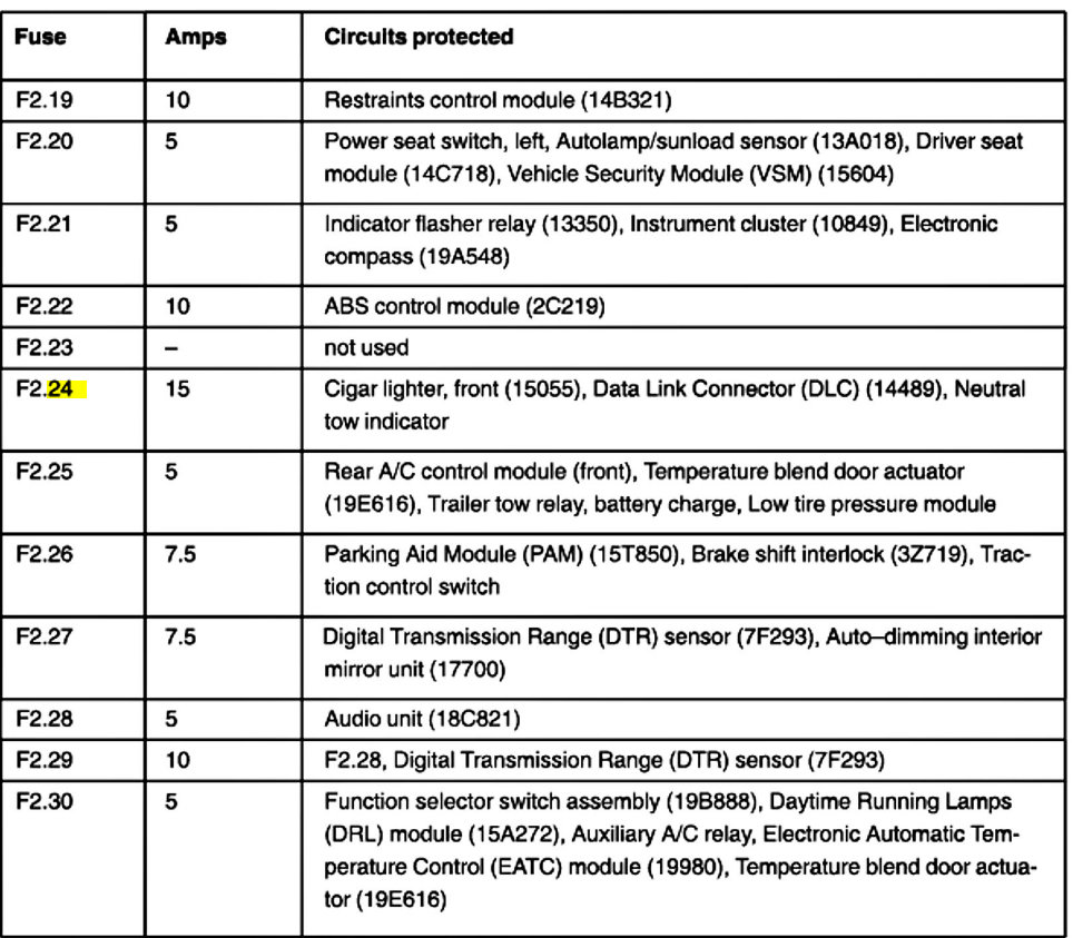

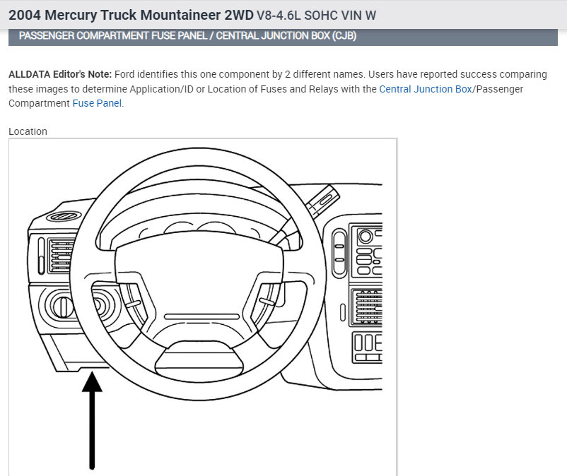

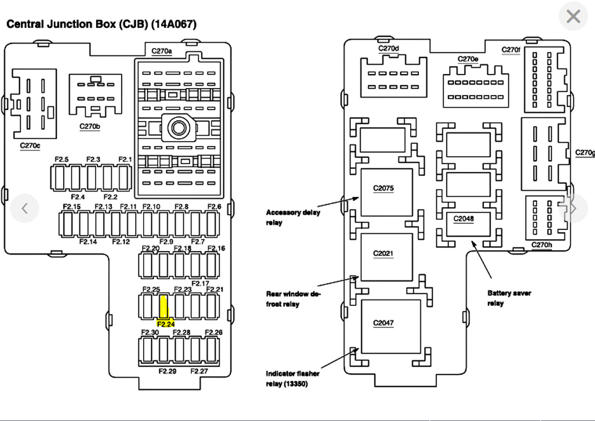

I think I’m not getting power from the port, and I don't know where to find the obd2 thing on the fuse box.
Jun 27, 2022 at 3:25 AM
SQM
Experienced Mechanic
6,383 POSTS

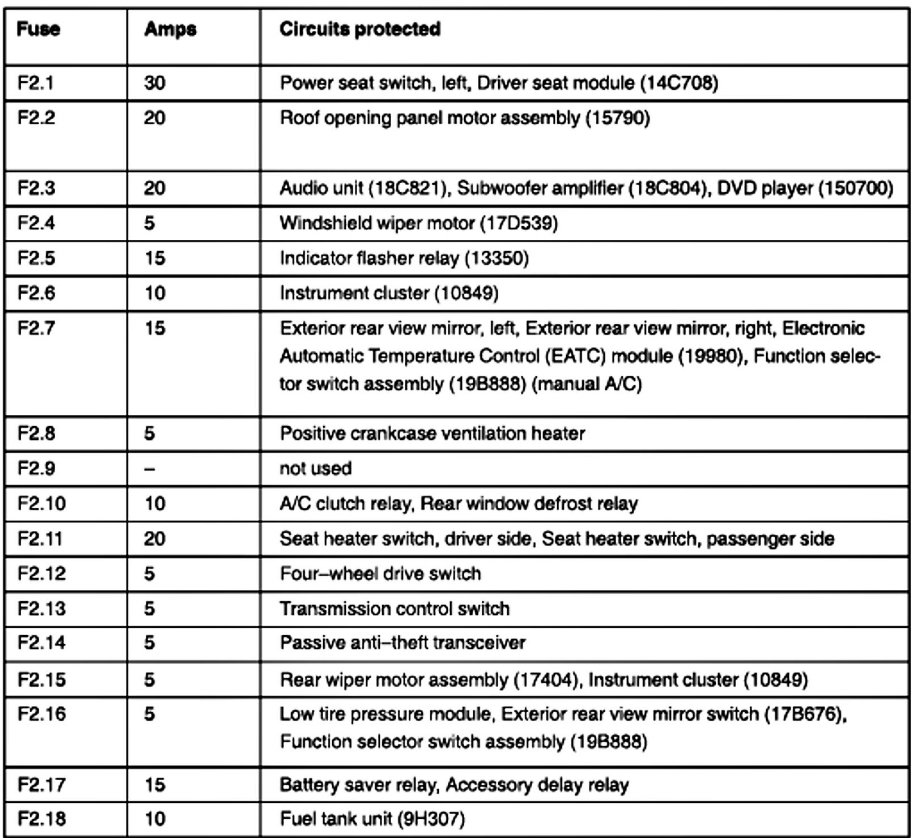

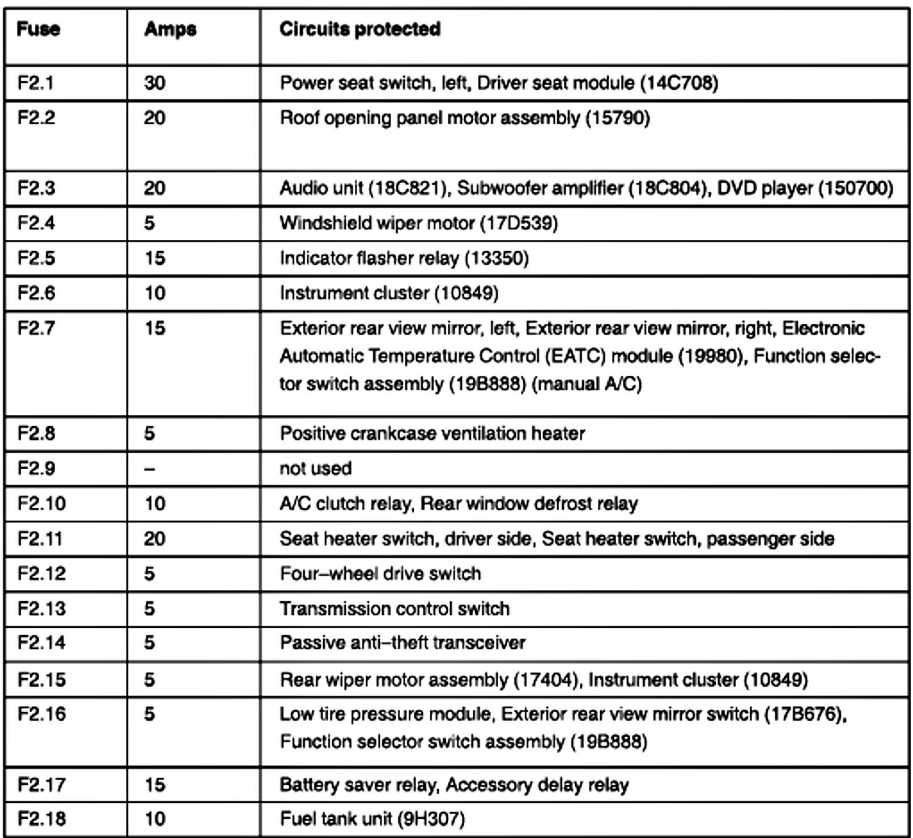

There is a fuse that powers the OBDII port.
It is located in the fuse box located under the dash.
It should be the number 24, a 15A fuse.
Check out this helpful video:
https://youtu.be/6Tlg3JmgNSQ
I have attached diagrams below for your reference.
Let me know of any questions.
