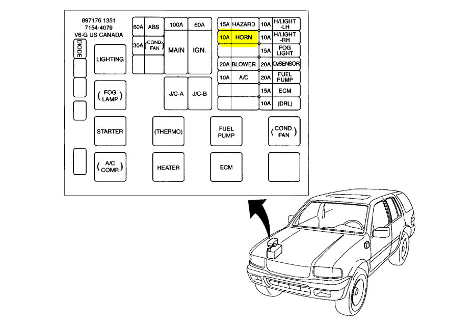

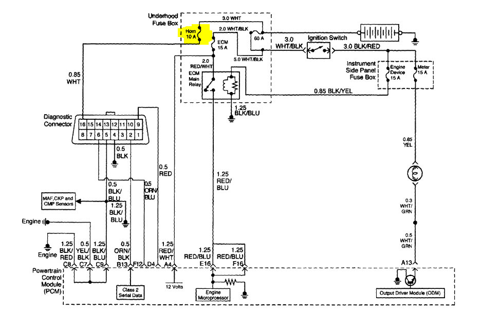

Does the obd2 port has a fuse or relay? If yes where is?
Oct 31, 2019 at 11:48 AM
SCGRANTURISMO
  • 4,897 POSTS
Hello
Yes it does. It is the horn fuse[10A] in the Under hood Fuse Box. In the diagrams down below I have included a wiring diagram of your vehicle's Data Link Connector[DLC], as well as a diagram showing the location, layout, and callout of the Under hood Fuse Box for your vehicle. Please go through these guides and get back to us with how everything turns out. I hope this helps.

Oct 31, 2019 at 6:23 PM
ANGEL0324
  • 26 POSTS
You are right thanks.
I have a stuck horn and I pull that fuse out, now I just have to inspect what's happening with the horn.
