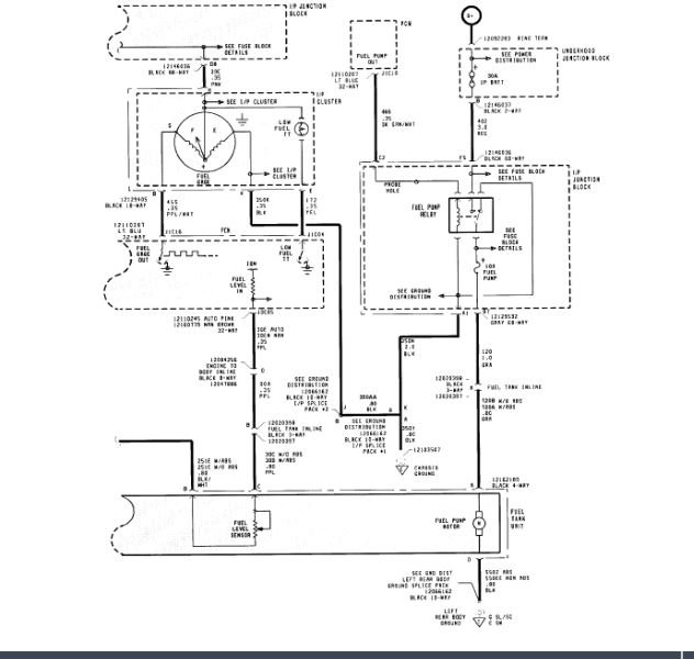

Obd2 power but will not connect. I have a will crank but no start.

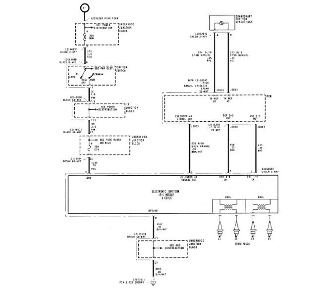

I have a tech 2 and a smaller Mac the obd2 port has power and ground but will not connect. Yes and relays. I can jump across the fuel pump relay to get it on it has 55# pressure. But no spark or fuel when cranking through, good compression too.

Okay, check for powers to the PCM. Make sure you have ignition and battery power.
I attached wire diagrams for you to view of the fuel system as well as the ignition system.
