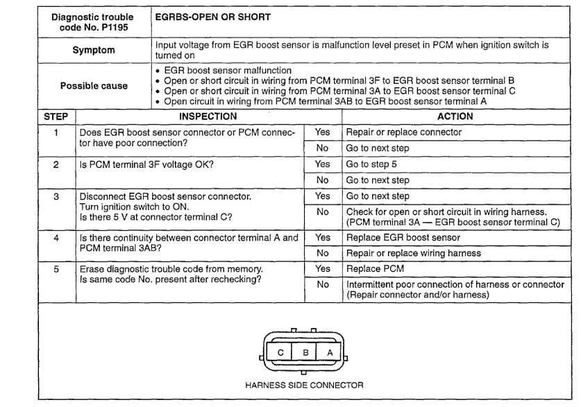

OBD II reading P1195 EGR Boost/Baro sensor open or short. Can't find anything wrong.

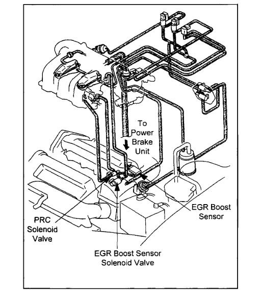

I attached a TSB on the 1195 code. Follow the TSB for the hose routings.

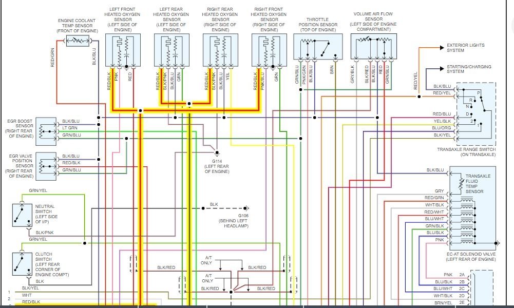

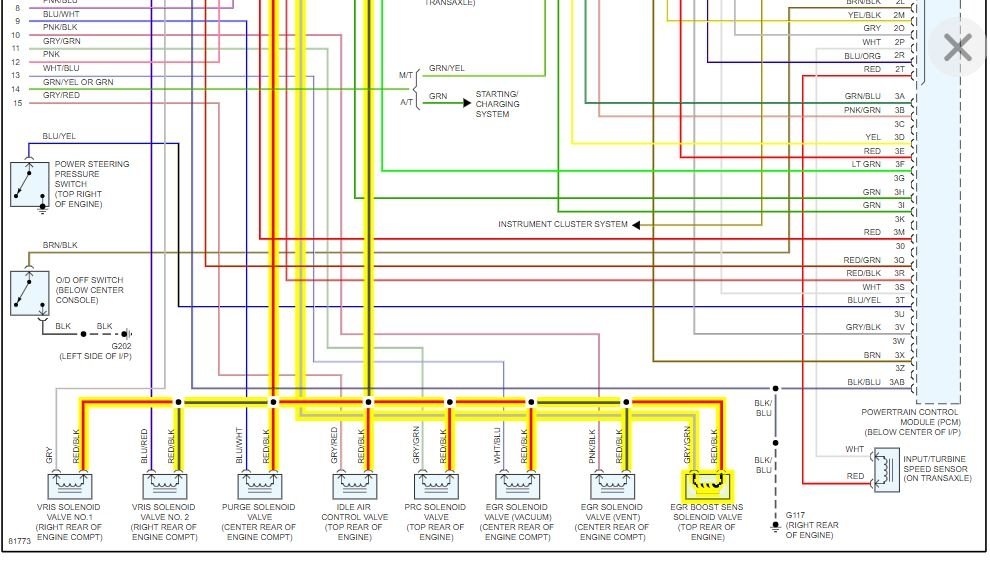

I also attached a wiring diagram of the boost solenoid as well. I would verify power to the solenoid with the key on.

Mis-routed, twisted or kinked vacuum lines
Swapped Pressure Regulator Control (PRC) and EGR Boost Sensor solenoid connectors

1. Verify that all vacuum lines are properly routed, not kinked or twisted.
If properly routed, not kinked or twisted, proceed to step 2.
If not properly routed, repair and proceed to step 4.
2. Locate the PRC and EGR boost sensor solenoid valves on the right side of the air cleaner housing.
3. Verify correct connector placement at the PRC and EGR boost sensor solenoid.
If the connectors are not in the proper position, correct their placement and proceed to step 6.
If the connectors are in the proper position, proceed to step 4.

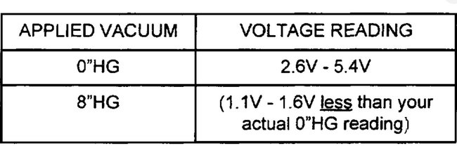

Measure the voltage between the signal wires (B/L & LG) from the rear side of the connector.
Use a vacuum pump and apply vacuum to the EGR boost sensor according to the table.
5. Record the voltage. Refer to the table shown.
If the voltage readings are not within the specified range replace boost sensor and proceed to step 6.
If no problem is found with EGR boost sensor, perform the DTC troubleshooting procedures (refer to Workshop Manual section F2).
