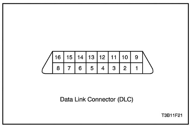

Please help me. the DLC connector in my car is broken and i have 2 loose wires that i don't know where they go. any help please is welcome. thanks in advance.

If you look at pic 1 below, it shows the actual plug connector. There are a total of 16 pin locations, and not all are used.

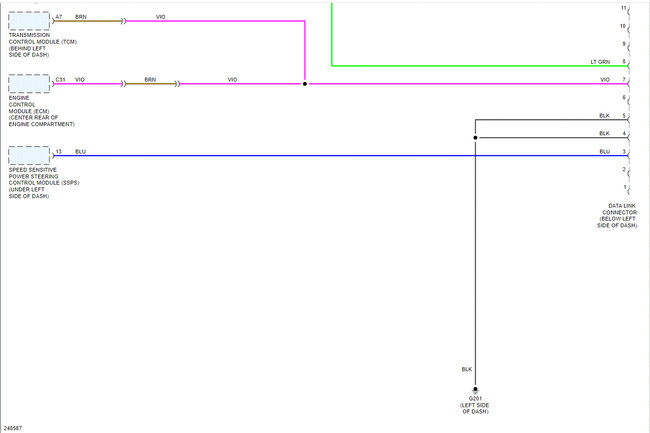

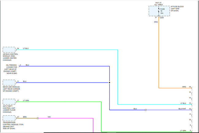

Pics 2 and 3 show what color wire goes to which pin connector.
