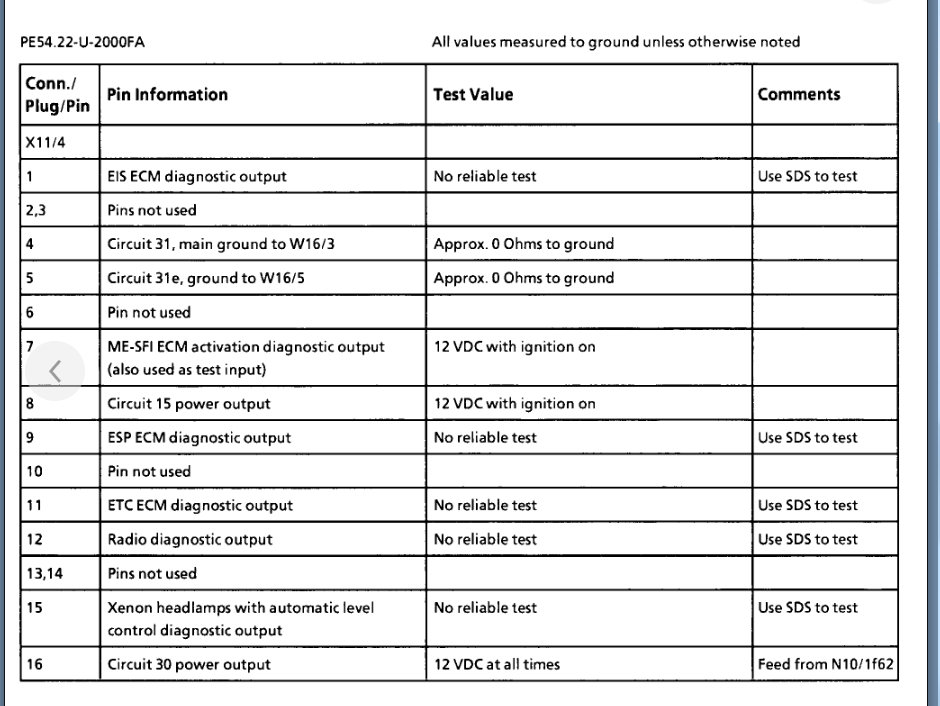

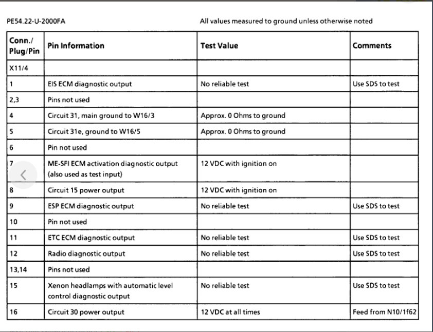

We then checked the continuity of the OBD2 pins. 7 and 8 had 12 volts, but 16 did not. We then checked the Ohms and Continuity from the port (16) to the wire that plugs into the ECM and got OL on the meter and no continuity. Car is still in limp mode.

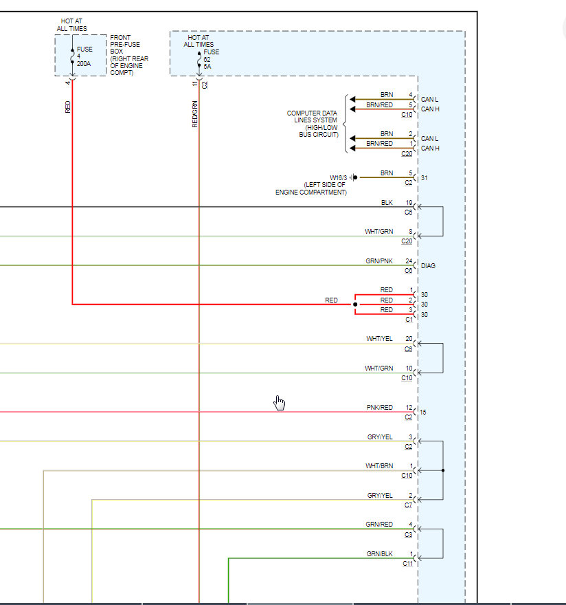

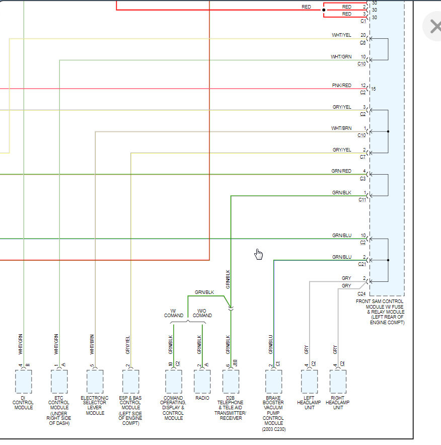

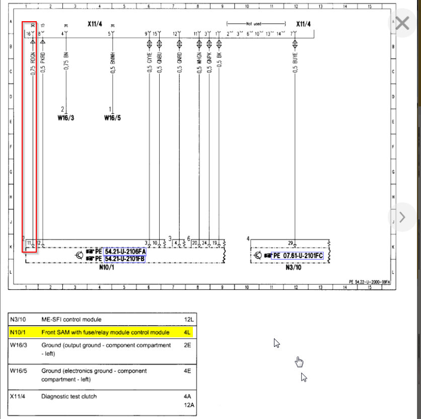

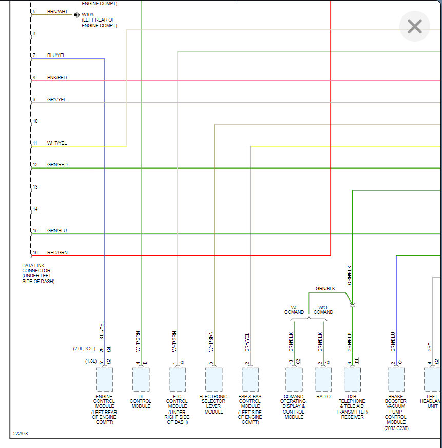

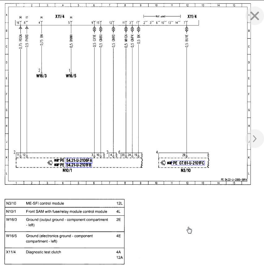

If you look at the diagram, pin 16 of the DLC goes directly to the Front SAM module. So you need to test resistance/continuity from the DLC to the SAM module pin 11.
If you have an issue here then clearly that needs to be fixed but I suspect those bent pins may still be an issue. Usually when they bend they are difficult to fix. It may be worth while to recheck them to make sure they didn't bend again.

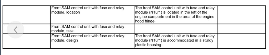

Also, how do I test the Sam module? Can I pull the entire thing out and test it or is there a specific way to get to that pin?

As for the SAM module you just want to unhook the connector and measure resistance from the DLC to that connector on the same wire.

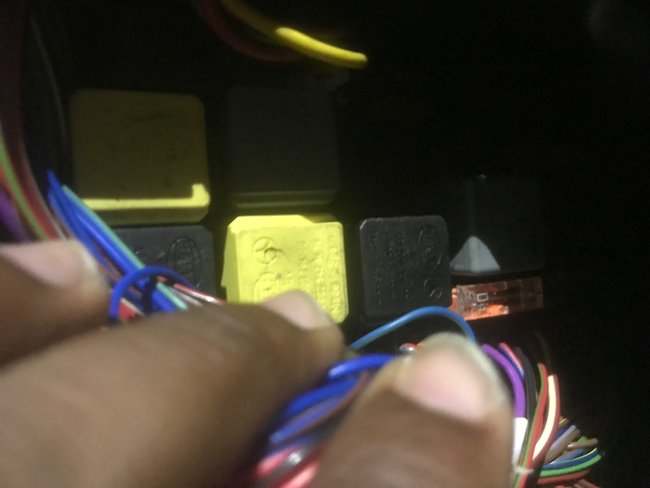

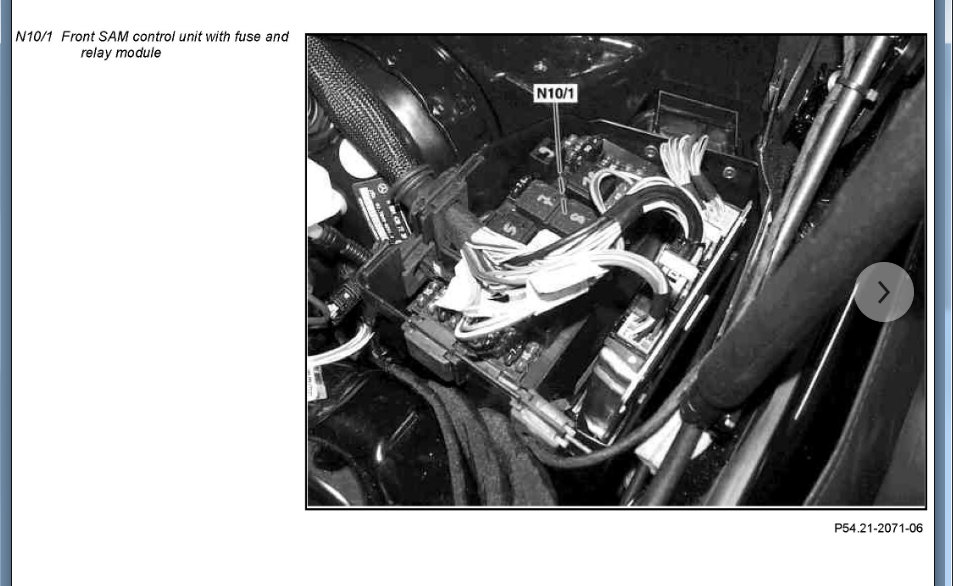

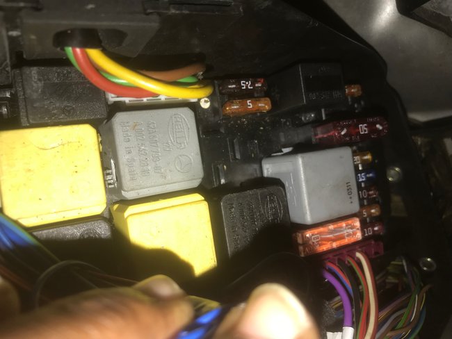

Okay, i don't want to sound extremely ignorant, but i'm very confused about the specific location of pin 11 and how to get to it. And on the picture below where the 7 and 8 is written on the relay, there is a relay where 8 is but no relay where 7 is. Is there a diagram or schematic that you could send me with the information of what relays/fuses should be there and what they control.

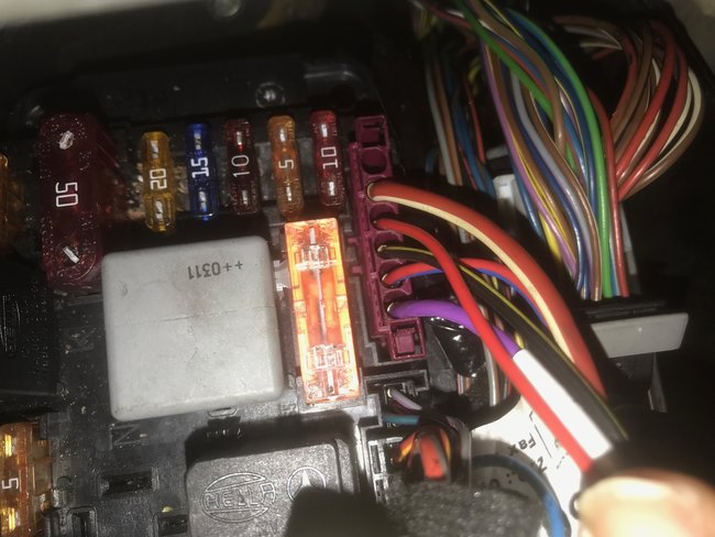

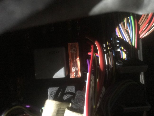

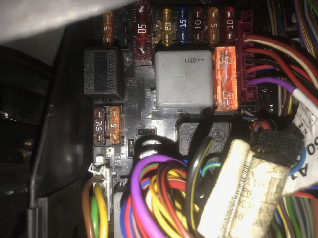

Here are some pictures of what my SAMS module looks like to get you an idea of what im looking at.

Okay. I would get a relay and put in there. It does look like there are metal tangs in the cavities which means it is not an empty cavity. As for the battery draining, that would not be related so we will need to figure this out and then start a new post on finding the possible cause of the drain.

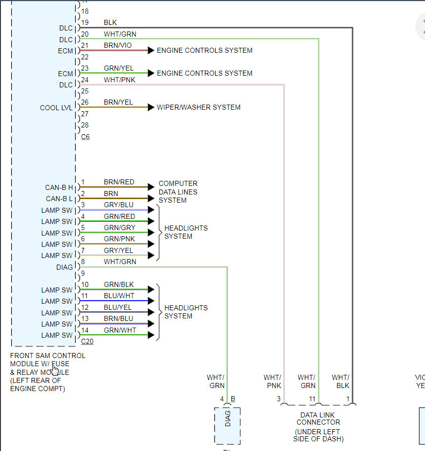

Okay, im still having trouble finding pin 11. Could you possibly offer some more information to help me find it?
Dec 13, 2019 at 12:03 AM

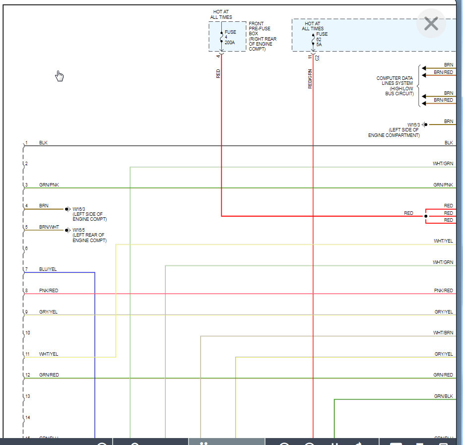

So the OEM diagram showed the pin 11 on the SAM module but the AllData wiring diagram shows the DLC goes to pin 19, 20 and 24 or the SAM module C6 connector. At this point, I don't know which one to trust however, since you are having an issue finding pin 11 maybe the OEM one is wrong.
