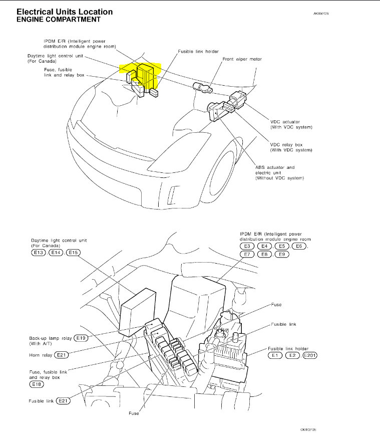

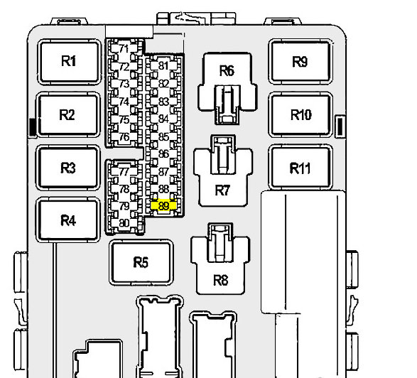

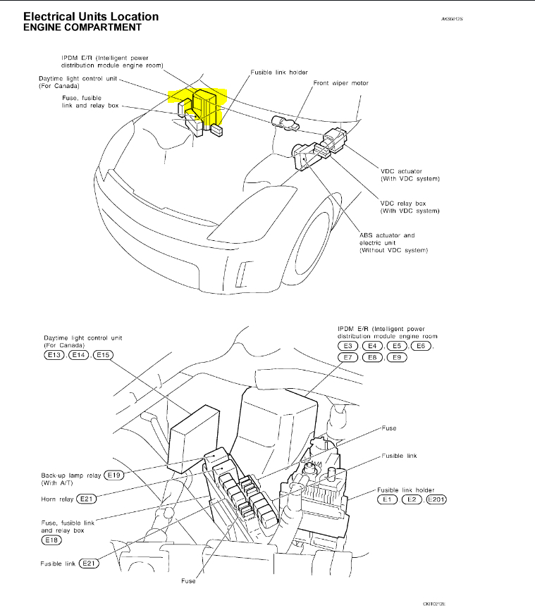

I can’t seem to get any power out of the OBD2 power. What can I do?
Feb 18, 2022 at 10:17 AM
SQM
  • 6,383 POSTS
Check the fuse located in the under-hood fuse box, which is located close to the fire wall on the passenger side (see diagram below).
It should be number 89, it is a 10A fuse.
Please let me know what you find or if you have any questions.
