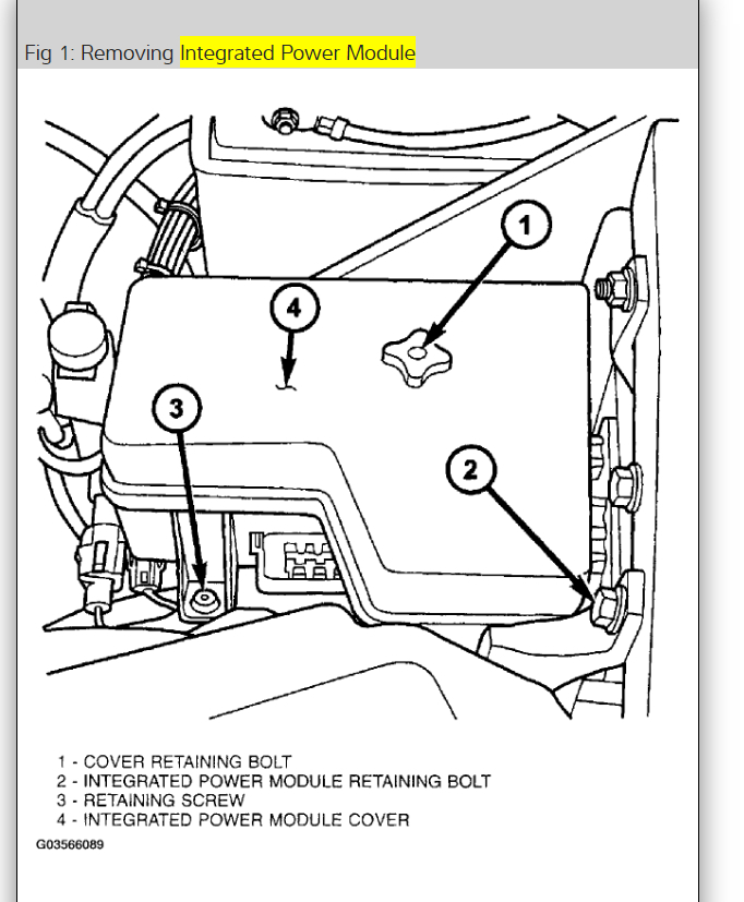

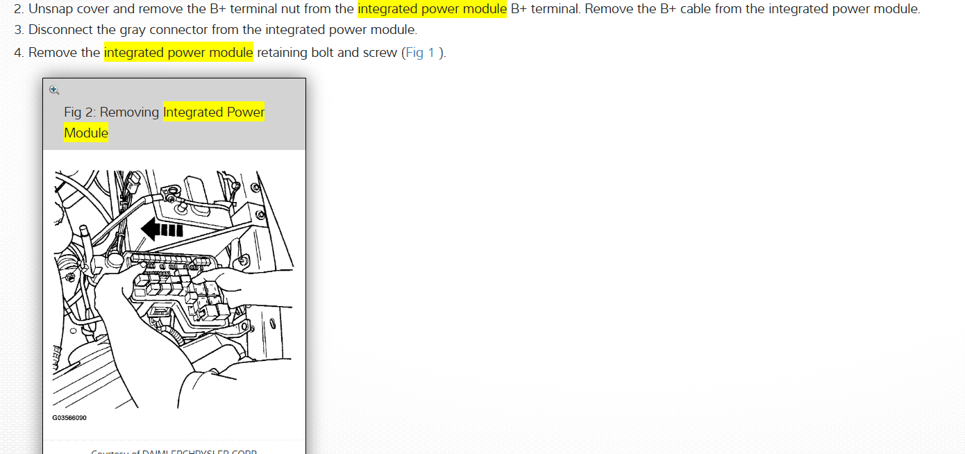

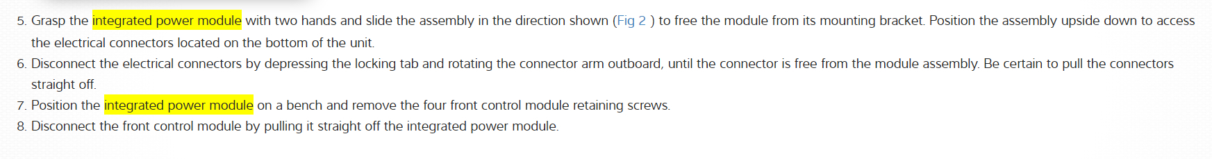

This happens when the TIPM goes out. here is how to replace it which is easy because it-self learns. The location and instructions are in the images below. Please let us know if you need anything else to get the problem fixed.
