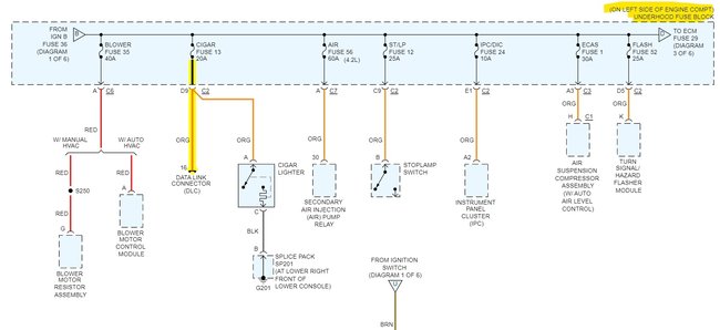

Where is the fuse that powers the OBD2?
2005 GMC ENVOY
160,000 MILES • 6 CYL • 4WD • AUTOMATIC
KSCARQUES#1
OBD2 has no power when code/diagnostic plugged in.
Mar 17, 2022 at 9:39 PM
WENDY W
  • 86 POSTS

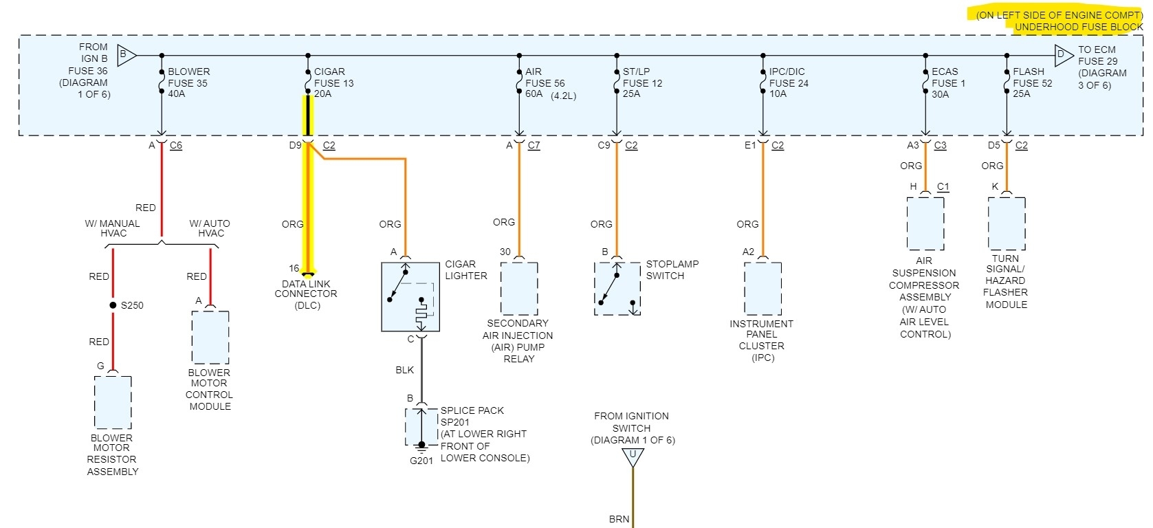

It looks like the data link connector should be fuse 13 in the underhood fuse block on the left side of the engine compartment. Please see the diagram below.
