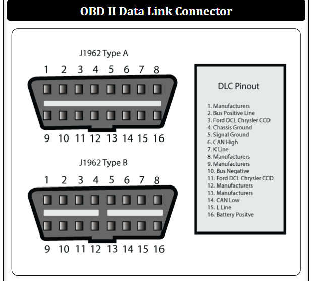

Check for power to pins 1 and 16 on the connector at the car. 16 is power and 1 is ground. you can use a voltmeter to check. if this is good, then it can be either a serial data line issue or the PCM itself.

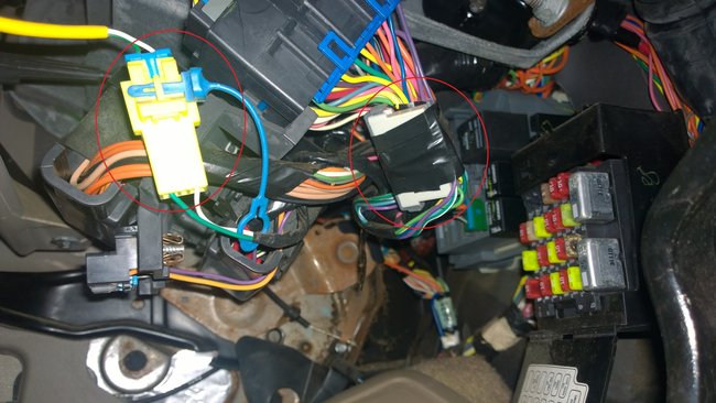

Thank you all! I started to check pin connector and I have a question. Here is a picture . What I this yellow connector? And those taped block? I were looking for any switch maybe, too, but found these things. Maybe something wrong with this taped black block? And what is this yellow connector?

I am sorry, there is no picture attached. Can you send it again so we can view it?

Sorry, I thought it was sent. Here it is.

Yellow connectors indicate air bag circuits. Do not touch them for the risk of inflating the airbag.
Not sure of the other piece. Let me check and see if I can identify it.

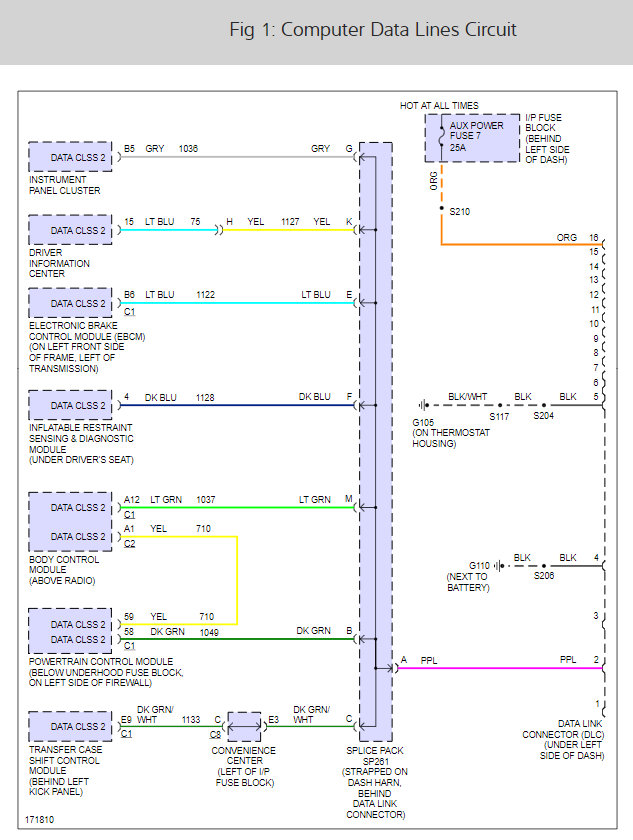

I think we should back up and see why there is no communication which is job one. Here is the wiring diagram for the ALDL connector you should check all of the fuses as well:
Check the fuse (aux power).
If everything checks out it sounds like the PCM is bad and needs to be replaced which you can do by getting a used one and plugging it in, (this sometimes works) if not you will need to have it programmed.
