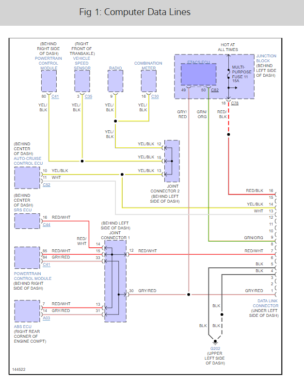

If you connect MUT-II original Mitsubishi diagnostics to je port, it starts to blink out the codes to dashboard, but we are unable to connect to the ECU.
Jul 21, 2022 at 11:21 PM
  • 55,500 POSTS

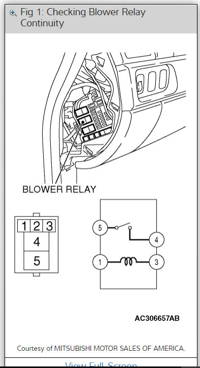

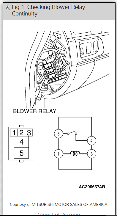

Can you connect with a regular scanner? Your MUT-II original might be bad, also check the fuse #11 the Multipurpose behind the left side of dash fuse panel. here is a guide and the fuse location in the diagrams below:
Here are the wiring diagrams for the ALDL connector so you can see how it works. Check out the diagrams (below). Please let us know what happens.
