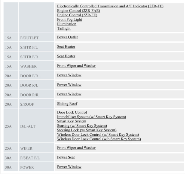

I accidentally touch the remote amp wire to ground on the amp and by doing that it shut off my radio and my auto windows do not operate. When I turn on the car it does not want to go into any gears, it just stays in parking.
Dec 27, 2014 at 1:27 PM
  • 55,710 POSTS

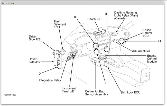

Yes, it does sounds like you lost a fuse. here is a guide and the power distribution wiring diagrams to help you test the fuses and the fuse locations also there is an accessory relay I would check as well:
and
Check out the diagrams (below)

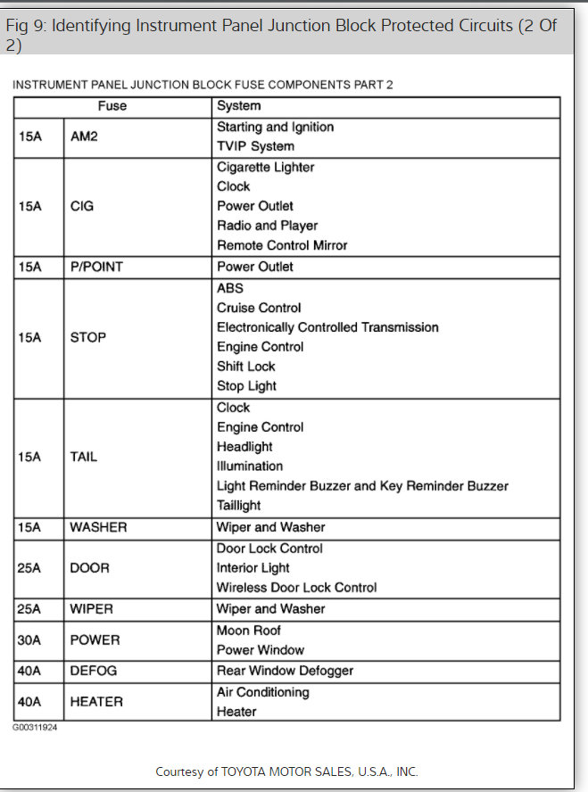

  • 55,710 POSTS

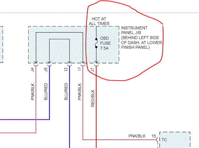

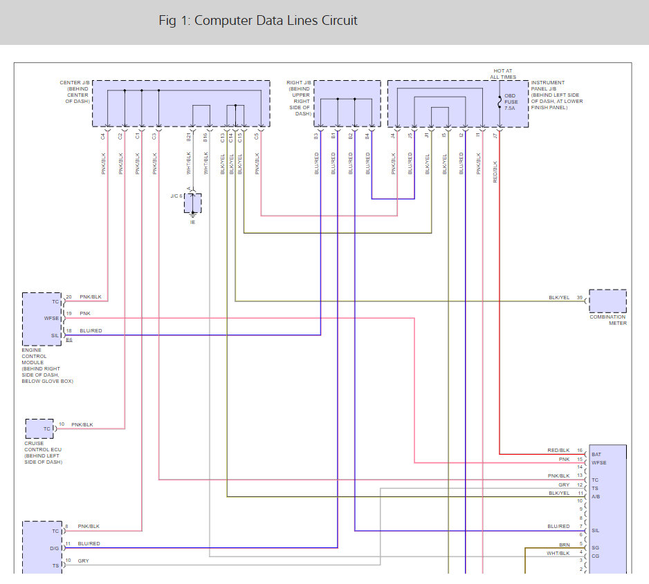

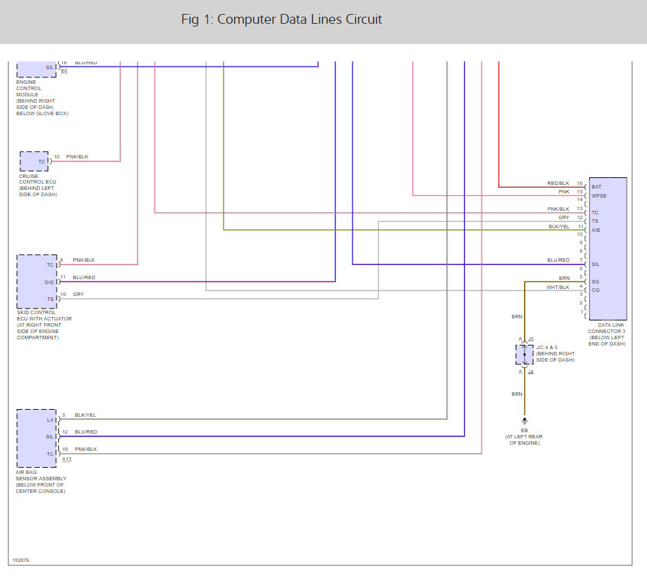

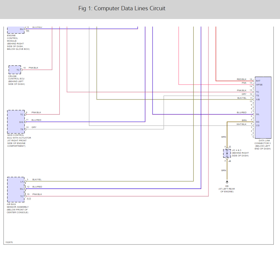

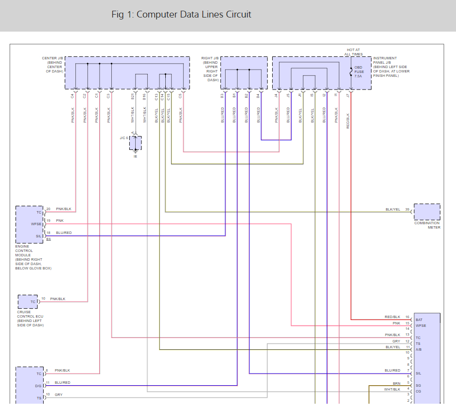

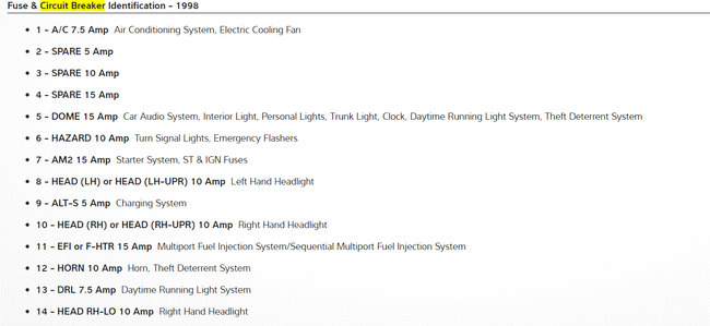

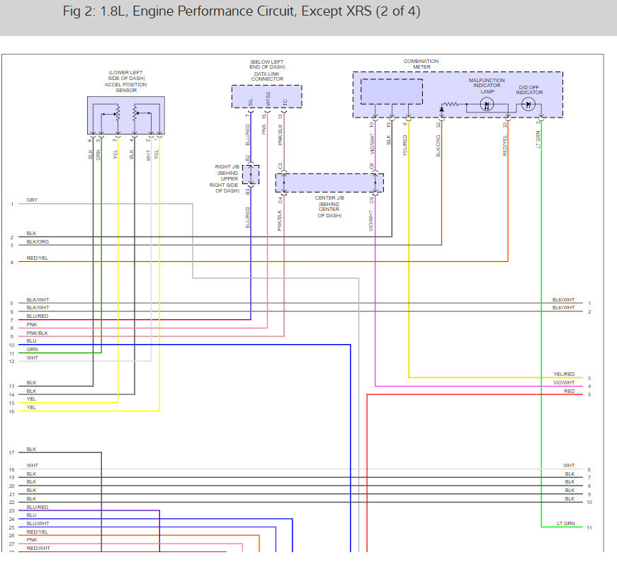

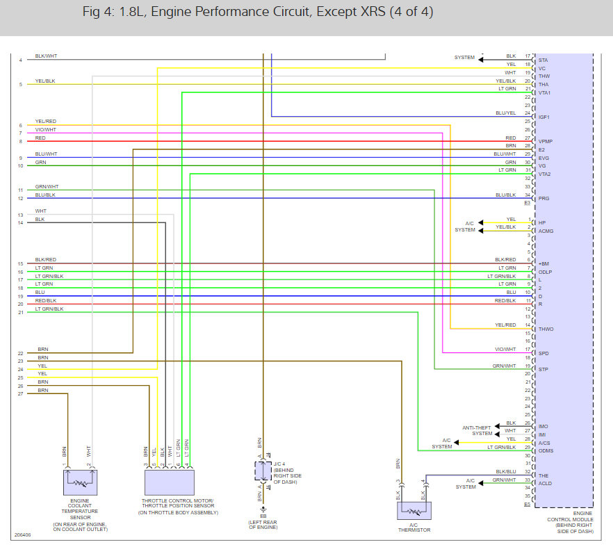

There is an OBD fuse that I would check first, check out the wiring diagrams for the ALDL connector so you can see how the system works.
Check out the fuse panel and ALDL wiring diagrams (Below)
Aug 9, 2020 at 4:56 AM (Merged)
POWERMOTORSPORTS
OBD fuse is OK, check the power of OBD port is also OK, since OBD is directly connected to ECU for memory, I wonder why it does not respond since it is already new ECU. check the lline an everything is ok

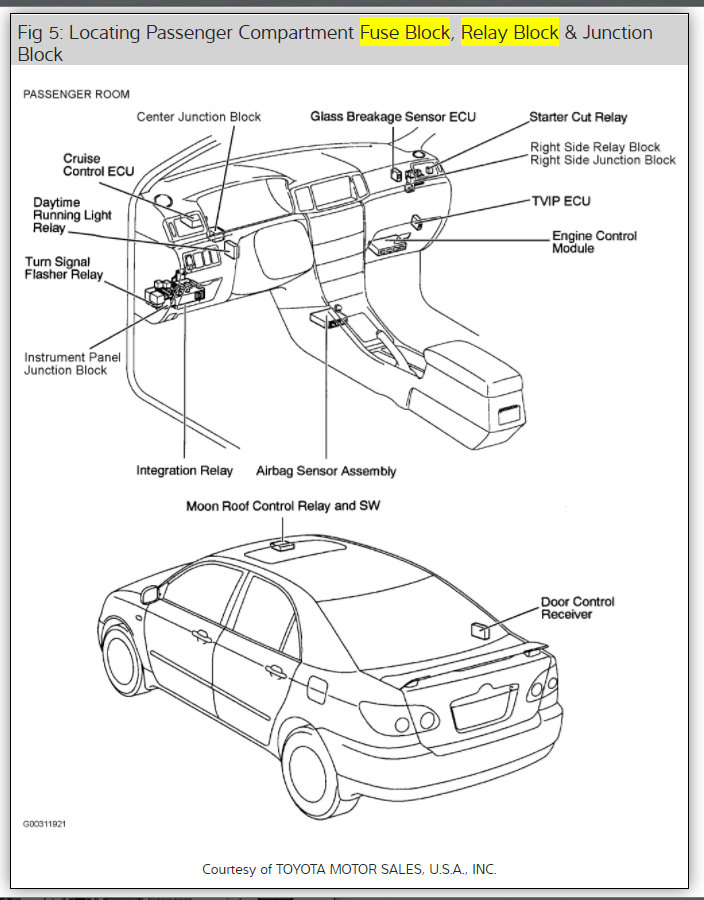

NIXO22
Hello house, I just joined. I have the same ODB2 connection problem. I have a 2006 Toyota corolla and each time I tried connecting an ODB scanner to it, I always get an "error in connection". Where do I start from?
  • 55,710 POSTS

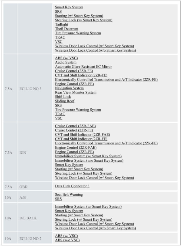

Have you looked a the OBD fuse? 7.5 amp.
Check out the diagrams and guide in my above post and get back to me.

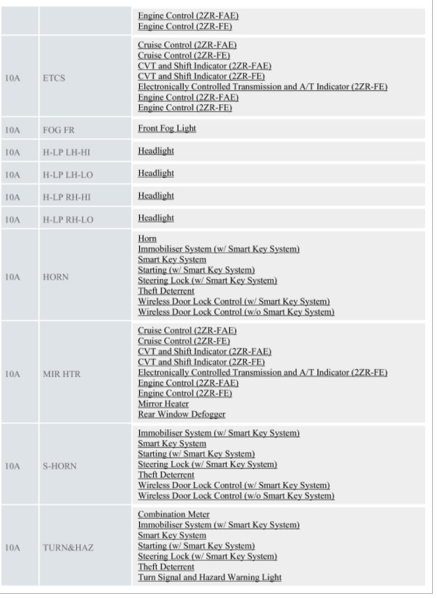

NIXO22
Yes I did check the 7.5A fuse for OBD and the fuse was ok though I didn’t test with a test indicator to confirm. The metal strip in the fuse was still intact.
However the round illuminating light around the cigarette jack does not come on when I switch on my lights.
I have both the ABS and Brake check light on in the dash.
  • 55,710 POSTS

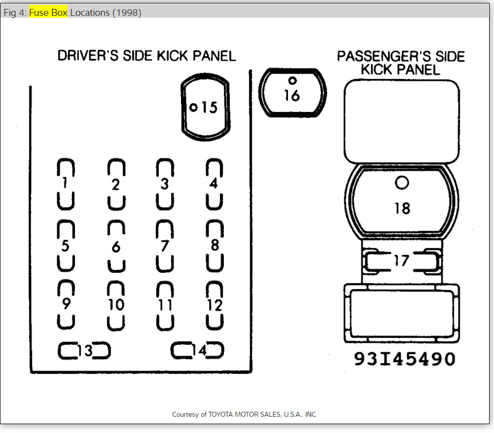

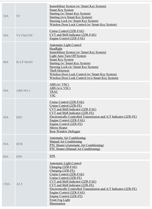

There is a 30 amp fuse in the passengers fuse panel that powers all of the systems you have mentioned.
Use the post above to see how to find and test

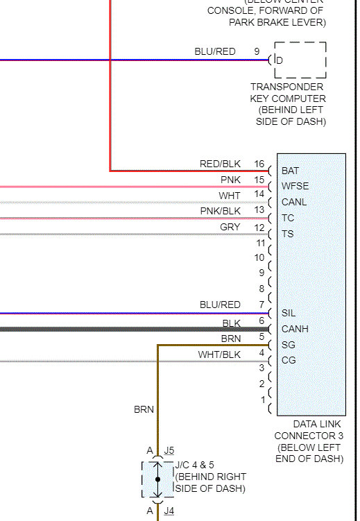

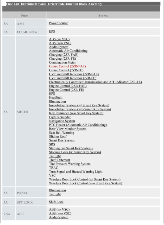

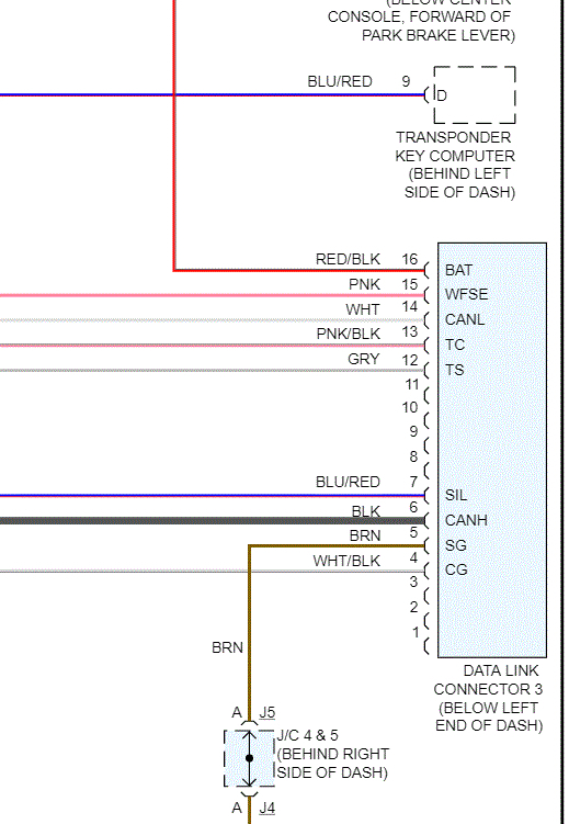

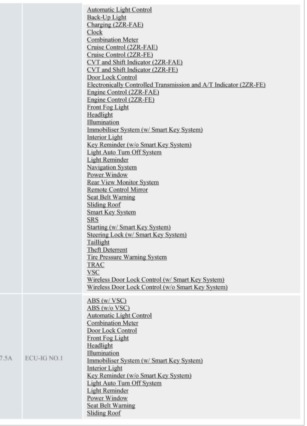

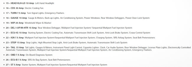

  • 110,248 POSTS

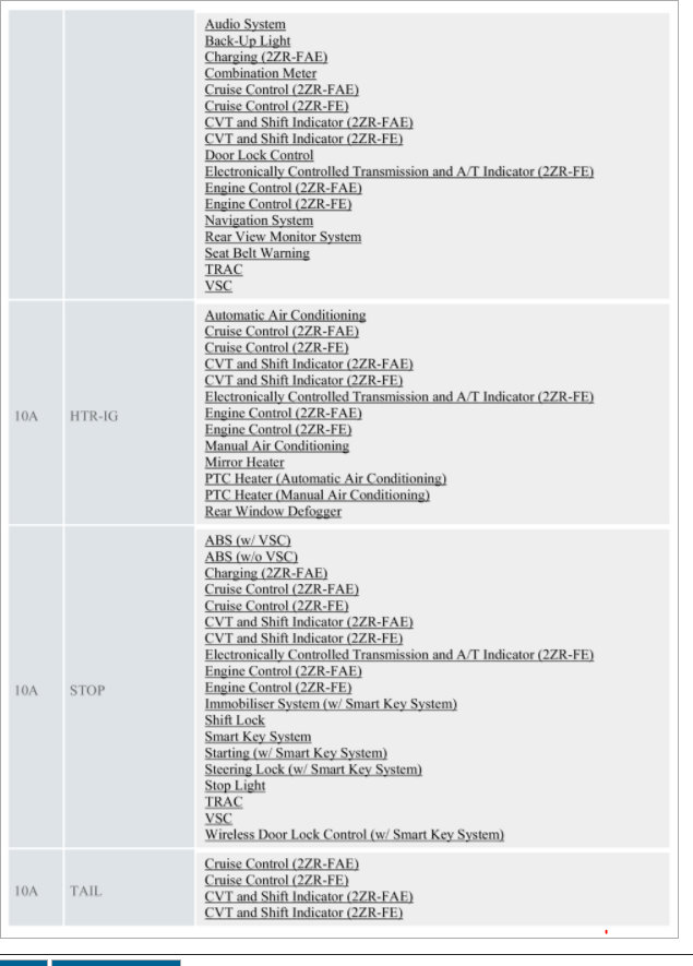

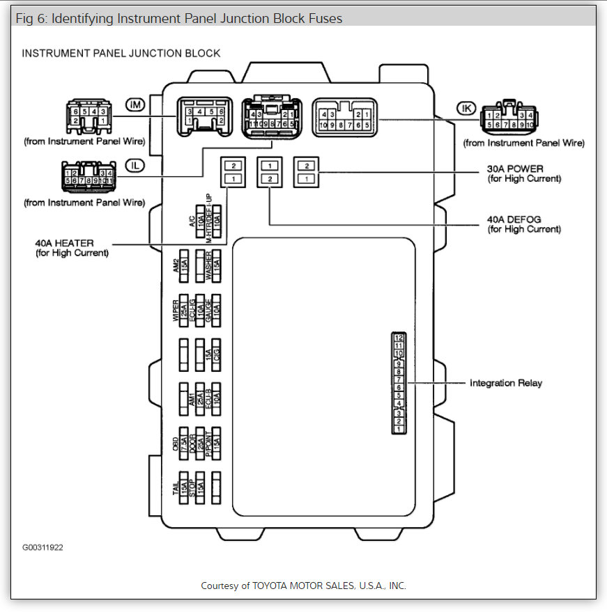

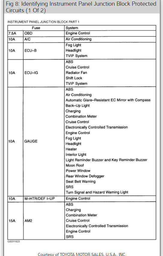

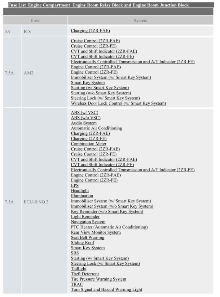

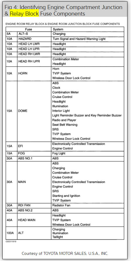

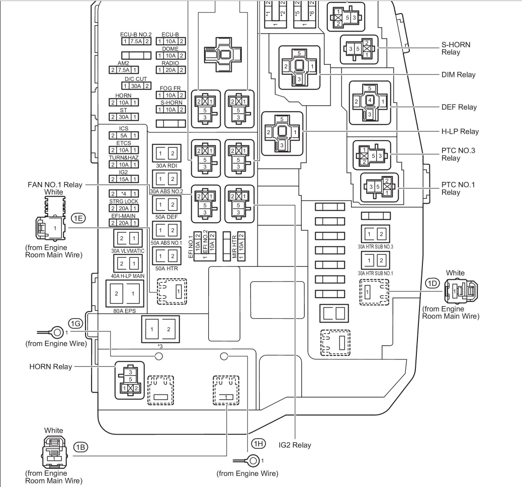

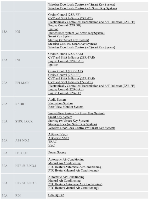

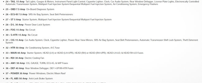

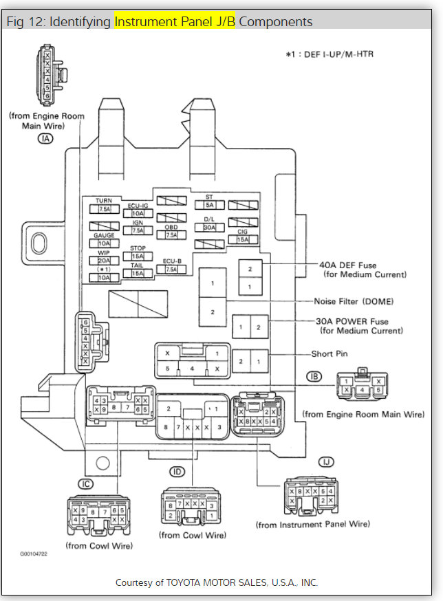

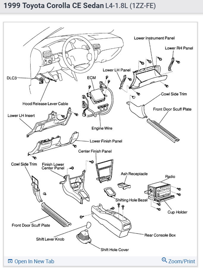

Okay, lets start at the data link connector (DLC). If you look at pic 1 below, it shows the connector. Pin 5 (brown wire) goes to ground. Confirm there is continuity to ground via that pin. Also, check pin 4 for ground. Pin 4 is chassis ground and 5 is a signal ground.
Next, pin 16 is constant 12v. Check to make sure there is power. If there isn't, check the fuse identified in pic 2.
Let me know what you find.
Jun 25, 2021 at 10:10 AM (Merged)
SCHO1RYAN
  • 5 POSTS
Using a test light I confirmed pin 4 and 5 continuity to ground. Pin 16 also had constant 12v.

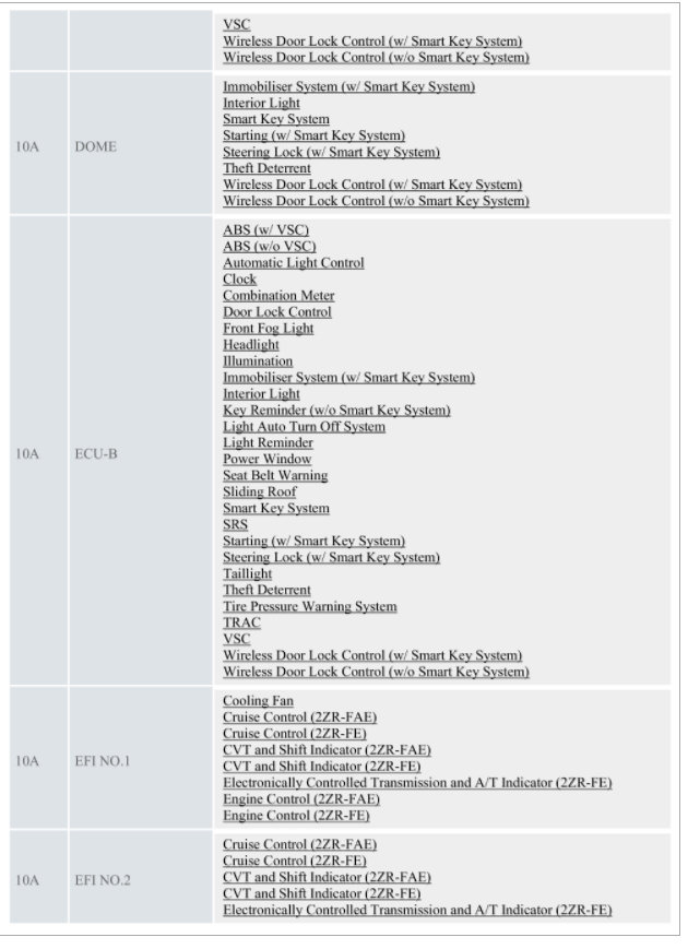

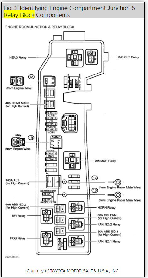

  • 55,710 POSTS

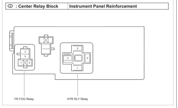

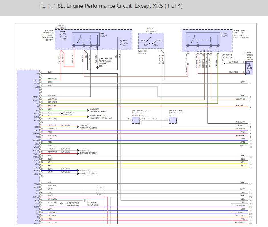

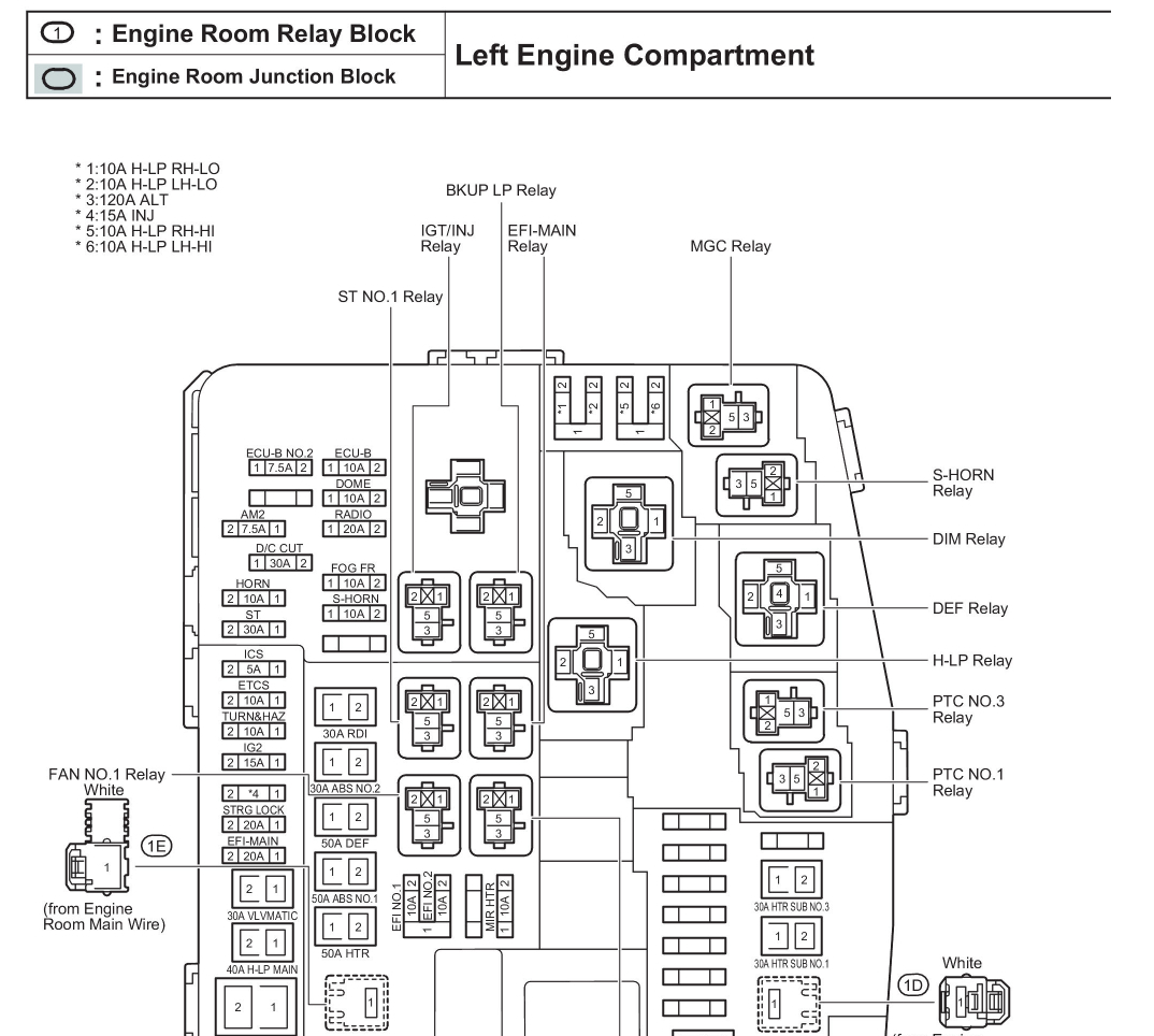

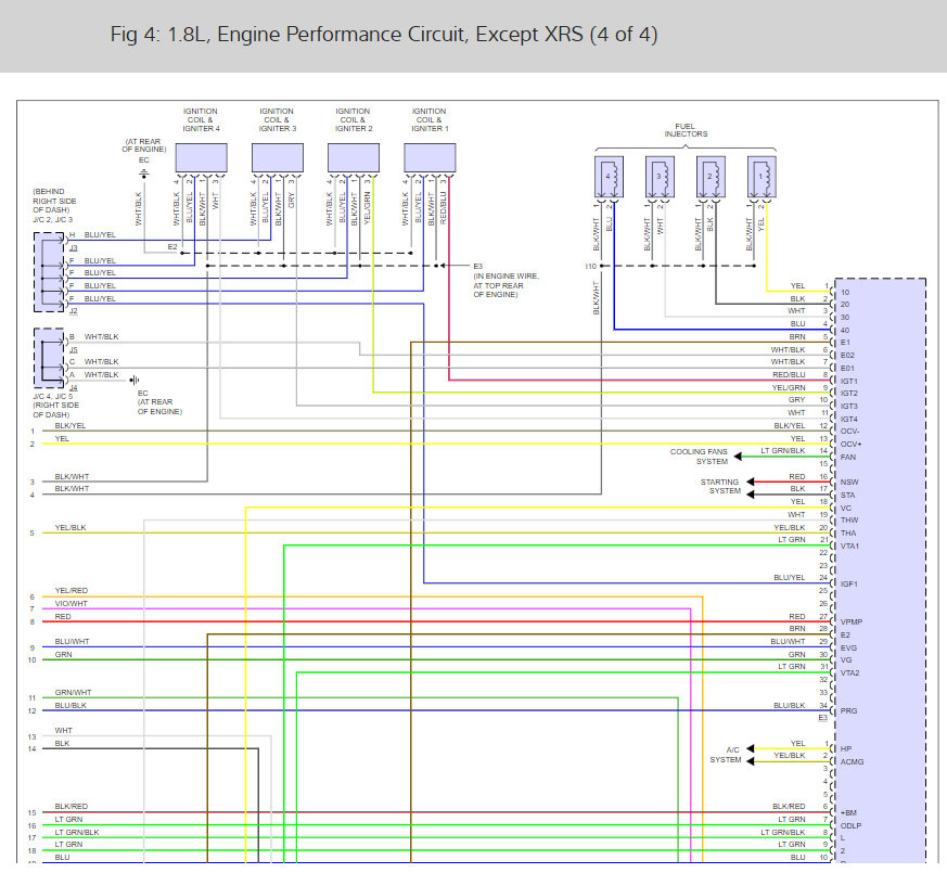

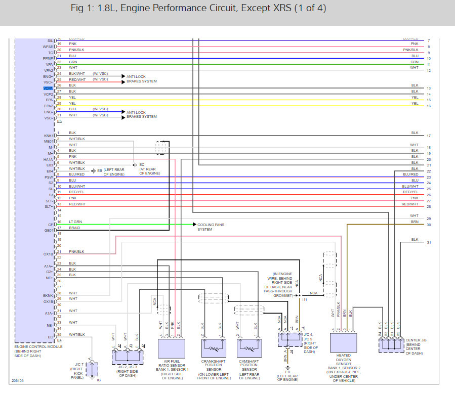

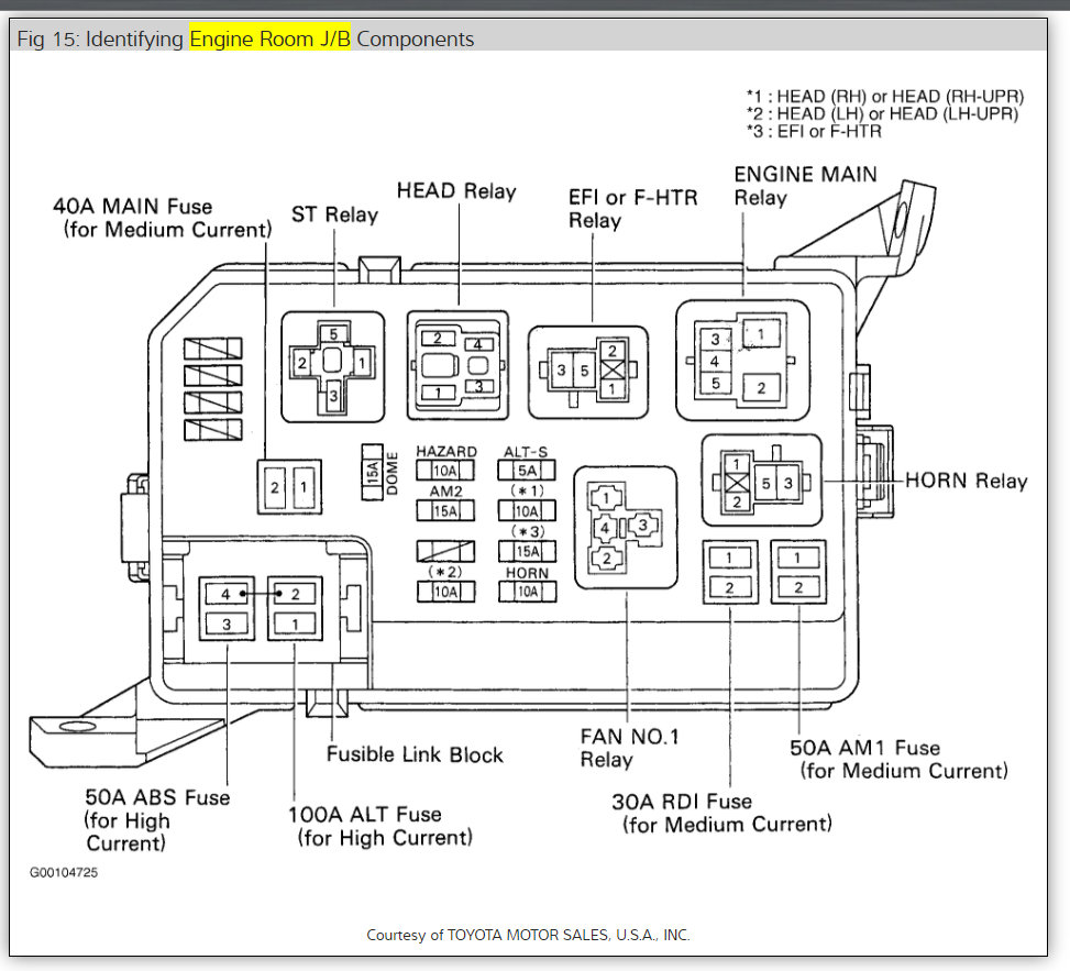

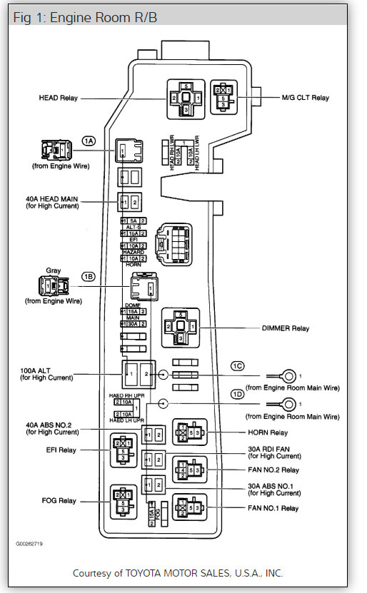

The last ECU sounds like it should work. Can you hear the fuel pump running in the tank and the security light is not flashing? Because the scanner will not communicate makes me think the EFI relay is not working here is a guide to show you how to test it and the engine wiring diagrams so you can see how the system works with the relay location as well.
Check out the diagrams (Below). Please let us know what you find. We are interested to see what it is.

  • 110,248 POSTS
That honestly doesn't make sense. Pin 16 should be hot all the time. If it only gets power when cranking, I have to ask where you are getting ground. If you are using the signal ground, then we have a problem with the chassis ground. If you are using a known good ground location on the vehicle, then we have a problem in the fuse box. If you look at the pic I attached above, you will see an OBD fuse. That should always provide power. Do me a favor, check the fuse and confirm there is power in and out at all times.
Jun 25, 2021 at 10:11 AM (Merged)
