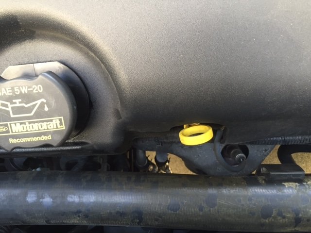

Please explain to me what might be the reason for the "Check Engine" light. Thanks!

KATTMANDU
Is that my bank2 O2 sensor right below the oil dipstick?

KATTMANDU
Thanks! I could change the O2 sensor (bank 2) myself, but anything beyond that I would prefer to take it in.
Friday, June 3rd, 2016 AT 1:36 PM
MHPAUTOS
  • 31,937 POSTS
You can change the sensor, but they can be often seized in the exhaust and often the thread comes out as it binds up, so if you try and remove, do not force it, if you can get it to move it will either come out easily or it will fight you all the way, if the latter take it to an exhaust repairer so they can heat it up and hopefully break the seize.
