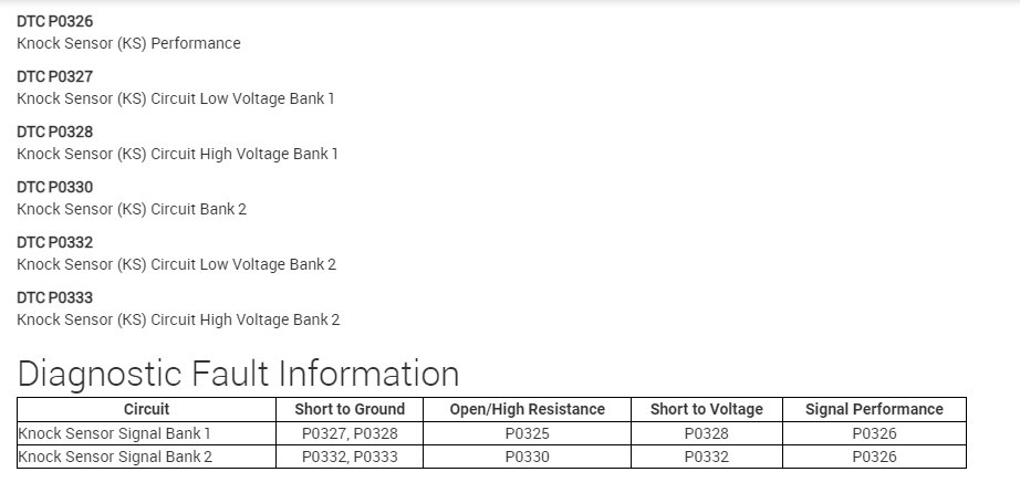

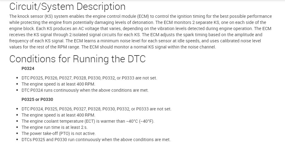

I replaced the knock sensors with ACDELCO parts. The check engine light came back on a few days later with the same code.
Jan 24, 2023 at 7:09 AM
  • 110,244 POSTS

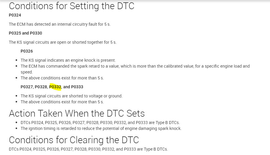

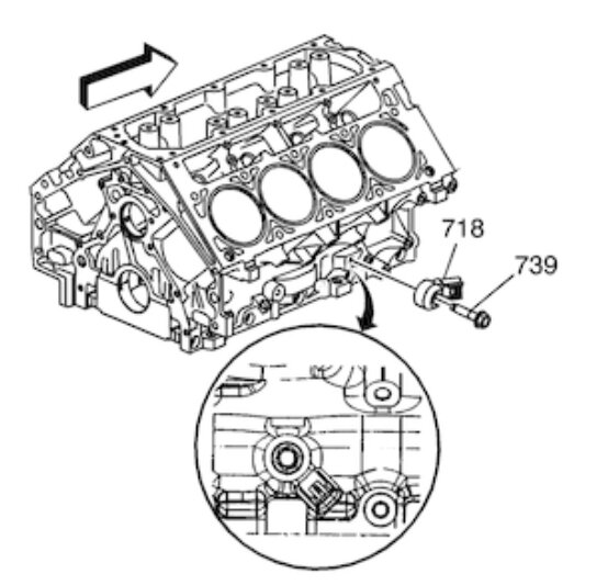

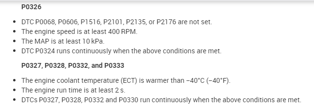

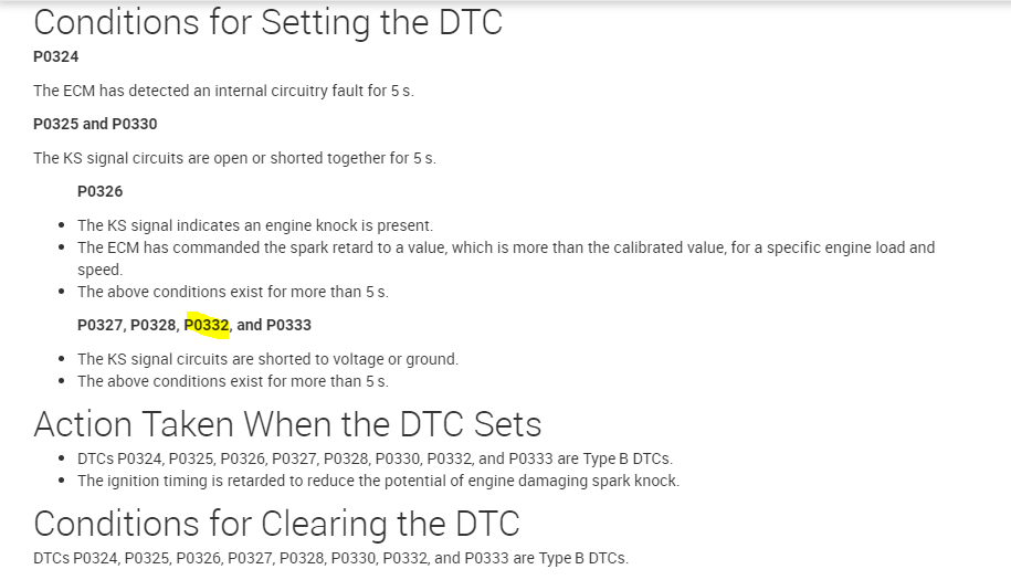

The code is specific to bank 2. See pic 1 below. Did you replace the one on the passenger side of the engine compartment or were both replaced?
Next, when you tighten the new sensor, it is important that it is to specification. It should be tightened to 18 ft/lbs. Is that what was done?
See pic below.

I changed both. and can't recall if i torqued it or not. probably not. this was over 2 months ago.

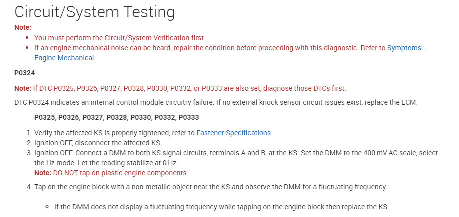

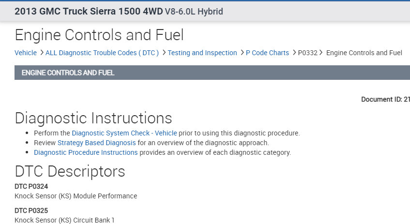

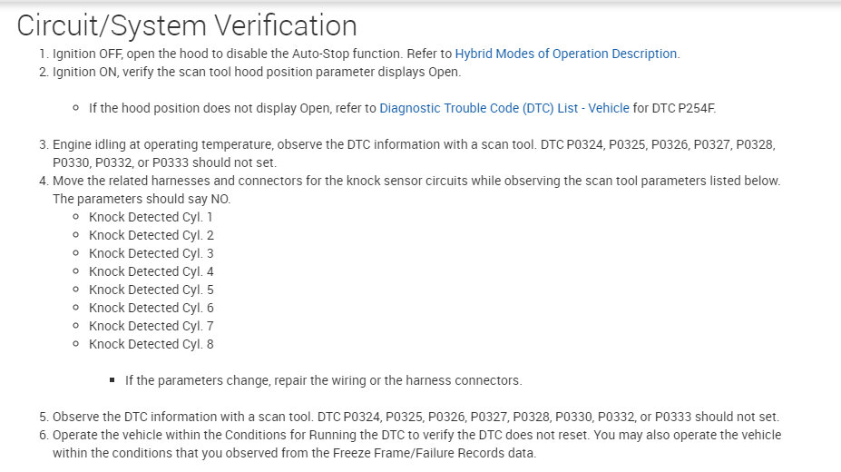

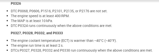

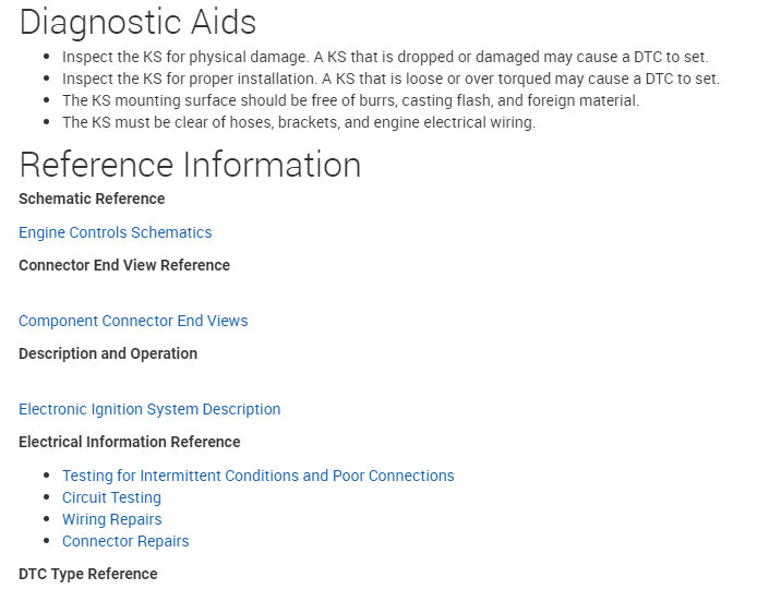

If by any chance they came loose, it will cause issues. Do me a favor. Take a look through the description and the diagnostics below. Let me know if you feel comfortable performing them. Also, if you need any other info on how to do it, let me know.

i torque the sensors but i don't have a meter that measures hz.
Jan 28, 2023 at 1:21 AM
  • 110,244 POSTS
I'm not sure what you mean by Hz. Hz stands for hertz. It is a unit of frequency used to measure sound waves.
The torque specs for the sensors is 18 ft/lbs. Let me know.
Take care and feel free to let me know if I can help.
Jan 28, 2023 at 12:43 PM
RONALD DEVOLD
  • 134 POSTS
Sorry for the delay, but I performed a circuit test by connecting the multimeter leads on the knock sensor and set the meter to HZ and the reading fluctuated while I was tapping on the side of the engine.
Jun 16, 2023 at 9:56 PM
  • 110,244 POSTS
Hi and welcome back,

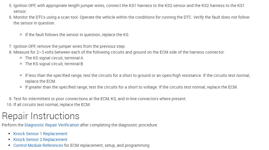

It sounds like it is working. Were you able to perform the diagnostics above? If the sensor is working, there is likely an issue with the wiring.

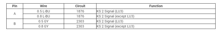

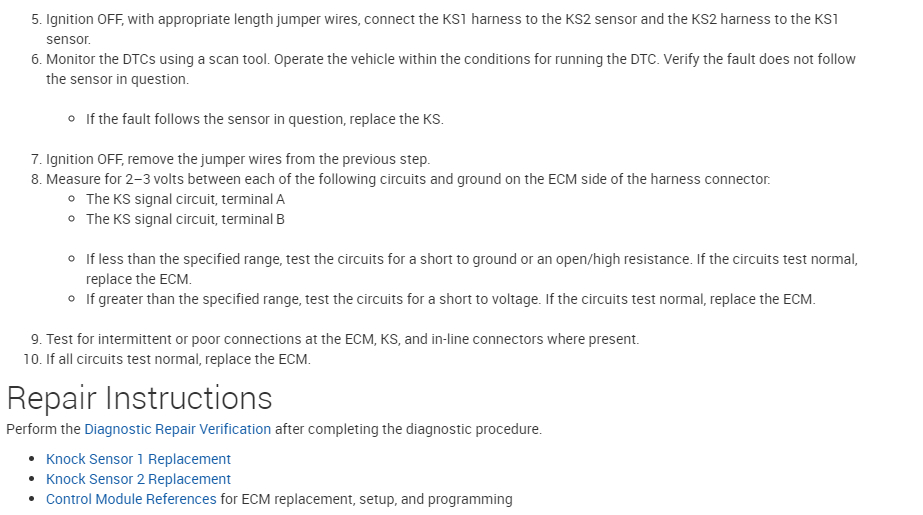

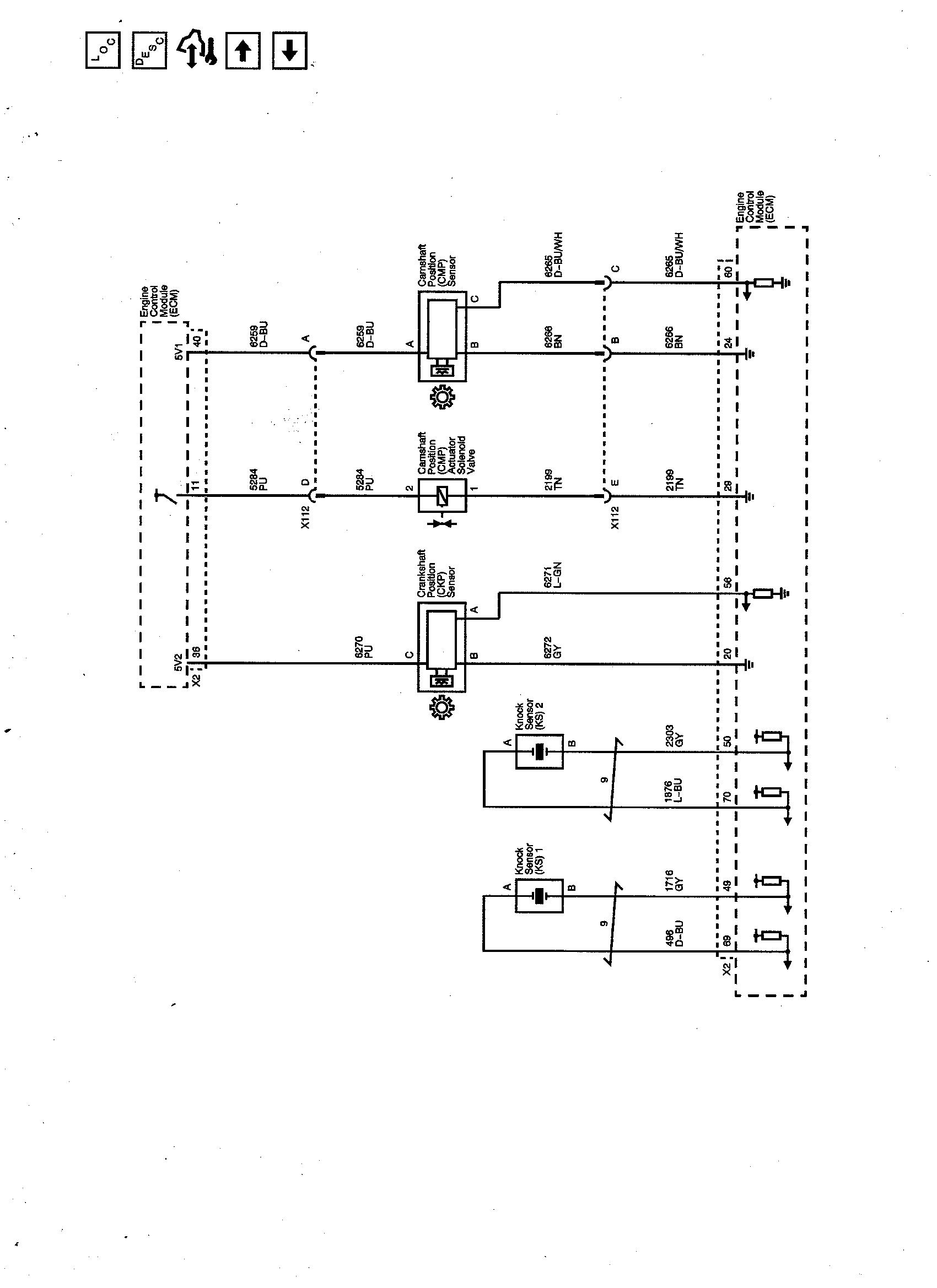

Okay. i printed the wiring diagram and I 'm trying to understand what am I testing . is it low voltage reading going from the sensor to the ECU? I've attached the diagram that I am using.
Jun 21, 2023 at 8:52 AM
  • 110,244 POSTS

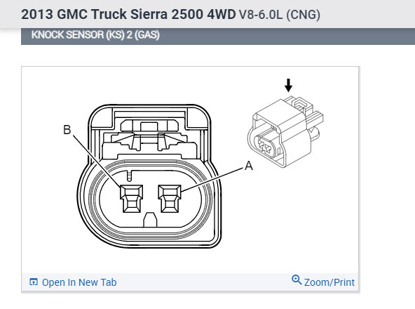

Pic 8 above explains how to test the sensor. Confirm it is good. Also, I attached two pics below. One is the sensor connector identifying the two pins. The second is the identifies the pin.
Let me know if this helps.
