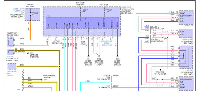

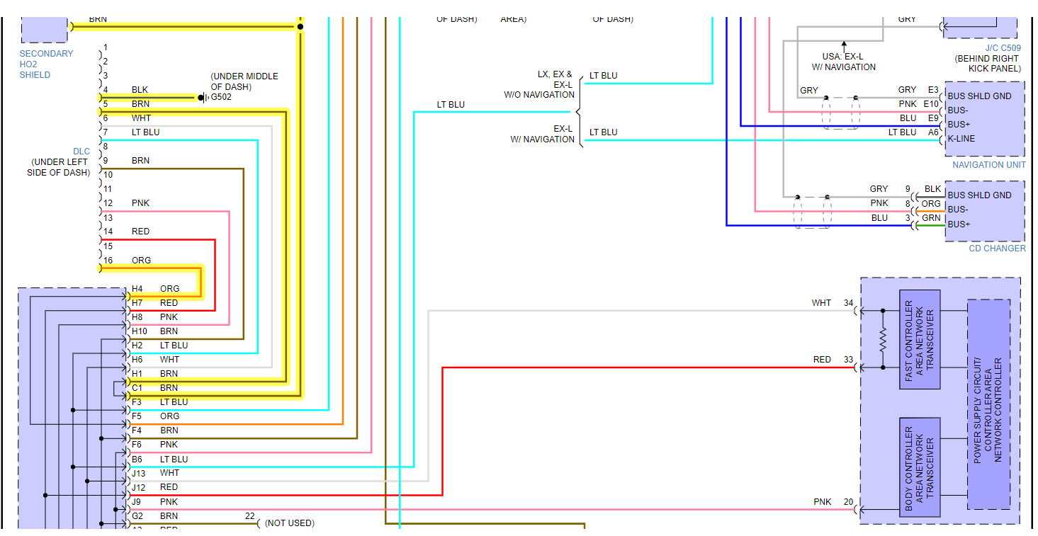

Can you tell me where the fuse location is, which powers the OBD2 port and which fuse is it? Thanks
Dec 20, 2021 at 3:52 AM
AL514
  • 5,668 POSTS

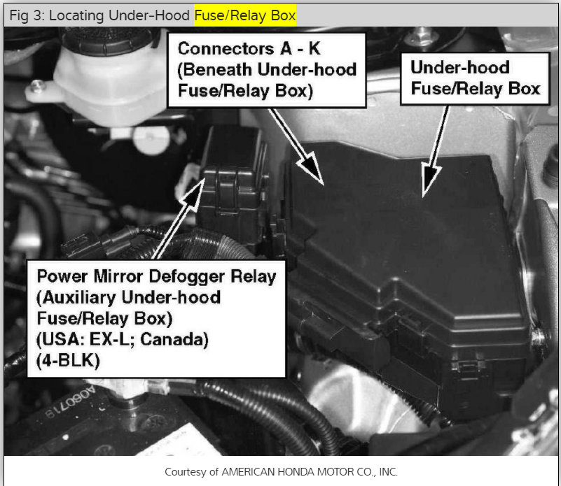

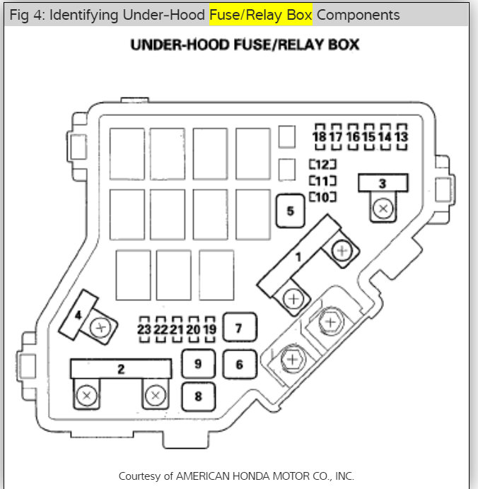

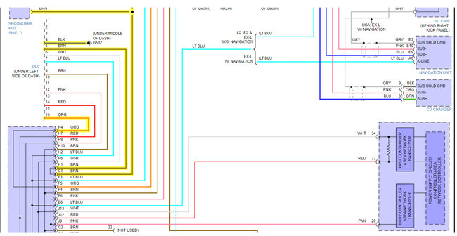

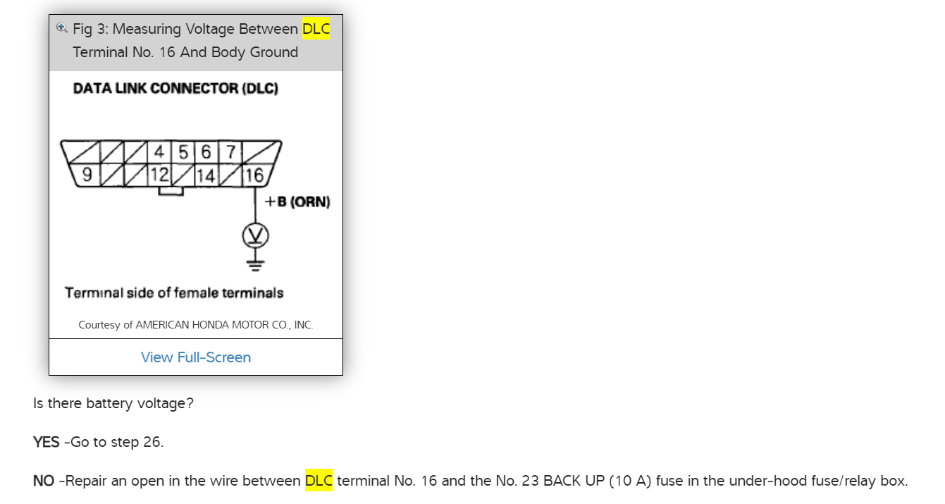

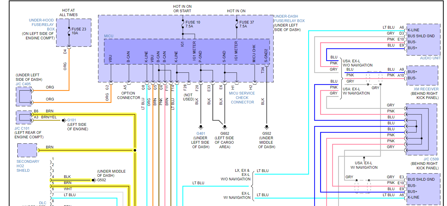

Hello, Pin 16 of the Data Link Connector is 12-volt power, Pins 4 and 5 are Grounds. The power for Pin 16 comes from Fuse 23 Back up (10Amp) in the under-hood fuse panel. The other pins on the DLC are data lines.
