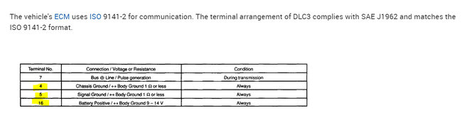

Hello, i have try to use a obd2 code reader for my car but does not respond to it, it will only tell me the voltage on the battery. i hope you can help. thank you
Oct 28, 2023 at 1:03 PM
  • 110,244 POSTS

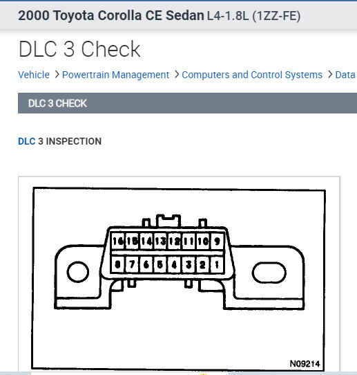

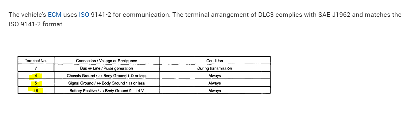

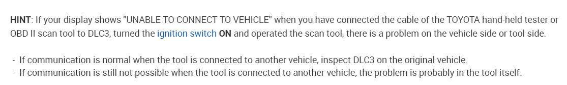

Does the scan tool power up? If it does (it sounds like it does), then we need to check the chassis and signal ground pins for ground. I attached general info below.
Take a look at the pics below and let me know what you find. Check grounds and confirm pin 16 has B+ voltage.
