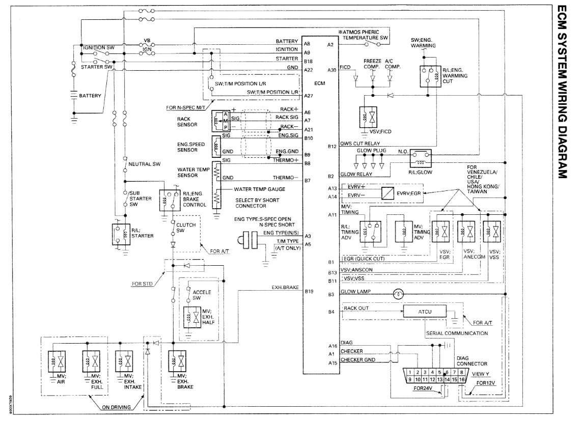

OBD2 not communicating with the computer. it has power and grounds just to communicating wire not working.
Feb 16, 2019 at 2:43 AM
  • 55,673 POSTS
Can you make sure #16 terminal has power? Here is a guide to help and the engine wiring diagrams below so you can see how the system works. Does the scanner work on other cars?
Check out the diagrams (below). Please let us know what you find.
