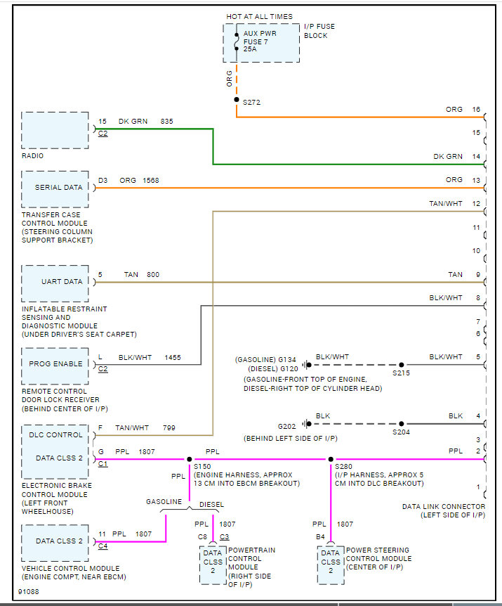

i have power to my obd2 port, but it will not turn on my Foxwell scanner, the scanner works on all other vehicles.
Sep 12, 2024 at 4:07 AM
HUNTER0307
  • 13 POSTS
i did check all fuses and chased wiring.
Sep 12, 2024 at 5:16 AM
  • 55,423 POSTS

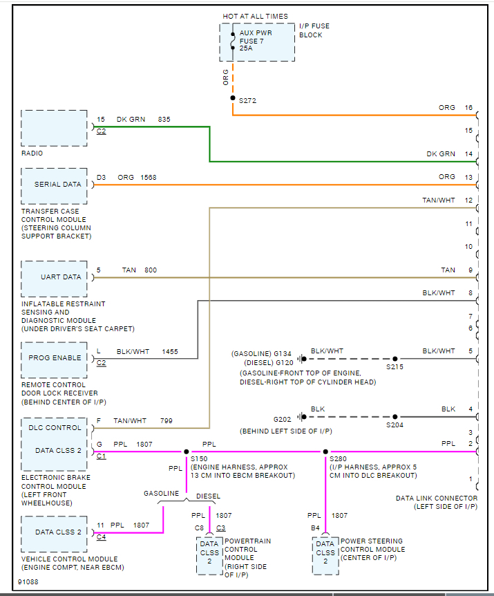

Did you check for power grounds at the data port connector? This guide can help you test it, and I have included the data port wiring so you can see which wires to test.
There are two grounds and one power. Check out the images (below). Please upload pictures or videos in your response of any problems so we can see what to help you with.
