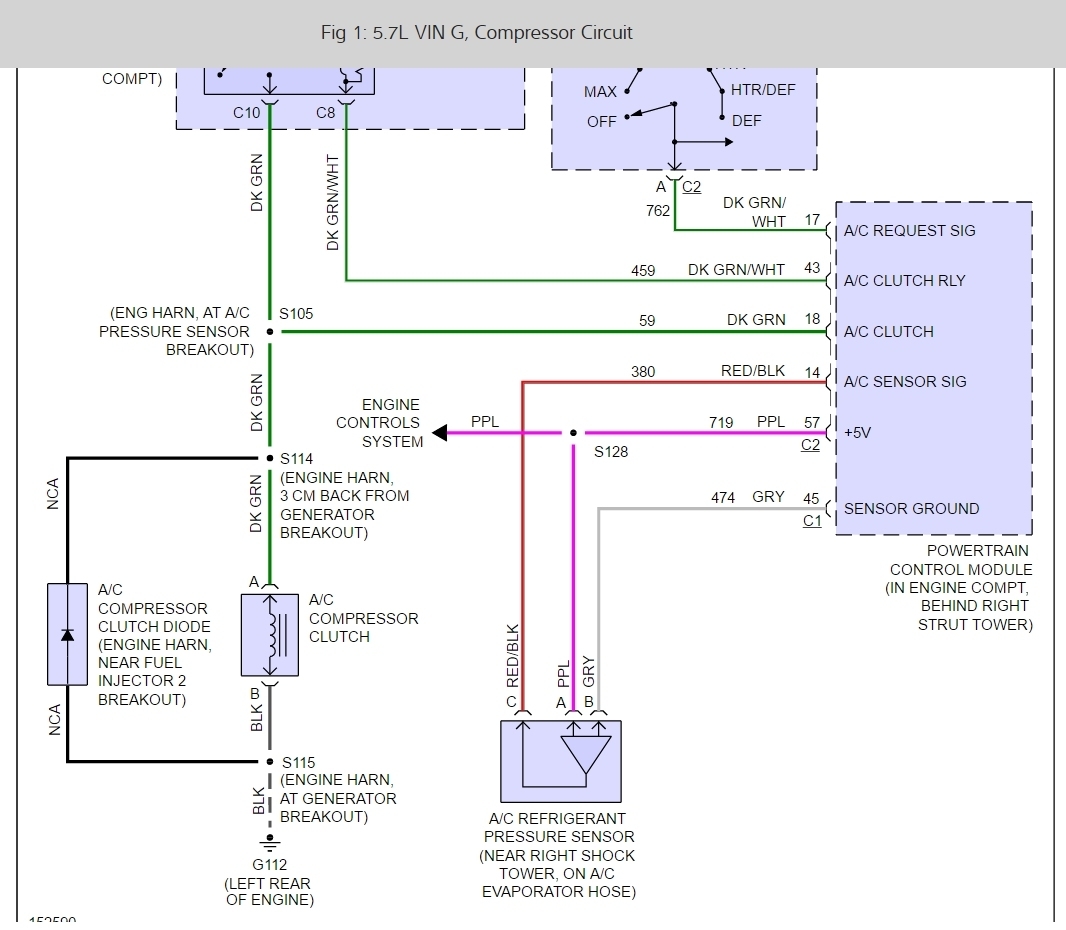

i'll get a code P1369 ever once in a while then it goes out 5 volt ref. 2 circuit? what is this?

i mean P1639

that is for the a/c circuit check all your grounds, for pcm, battery to body, engine to battery etc.

If I may but in here, I found that the P1639 is a pressure sensor out of range for the air conditioner. Here is a wiring diagram that lets you know where it is located.

ken i don't see any diagram./ is it orange located on high side ac line?

Sorry, here you go.

thanks i can hear something cutting on and off cut it isnt the compressor

It is probably the control relay which is controlled by the sensor.

just fixed you were right
