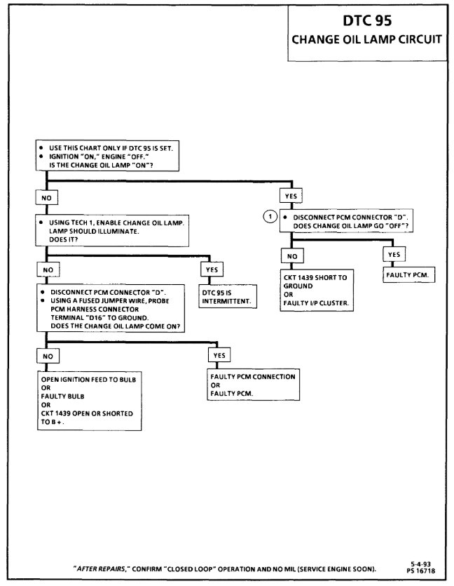

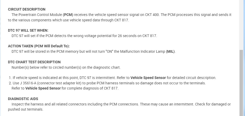

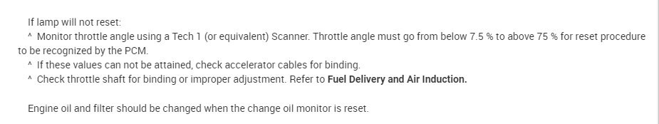

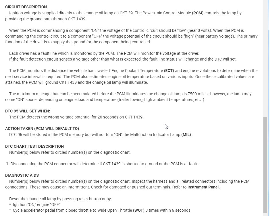

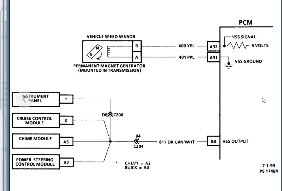

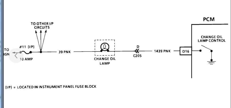

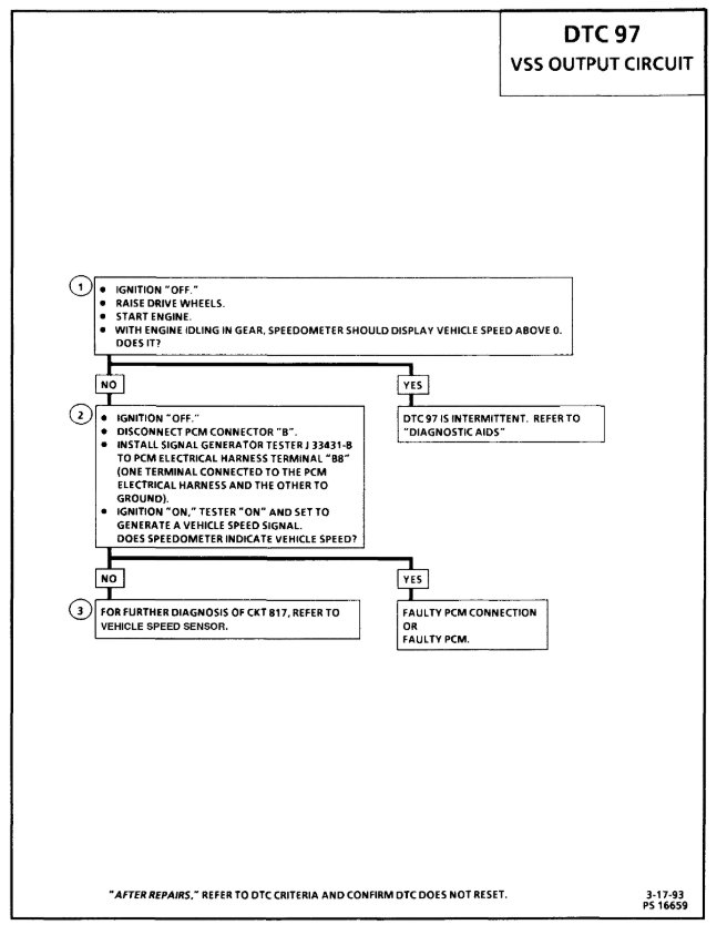

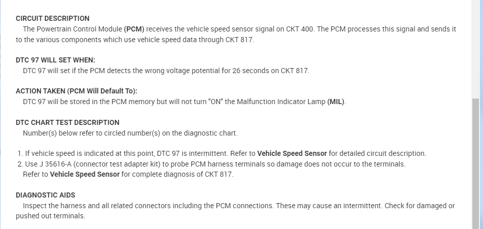

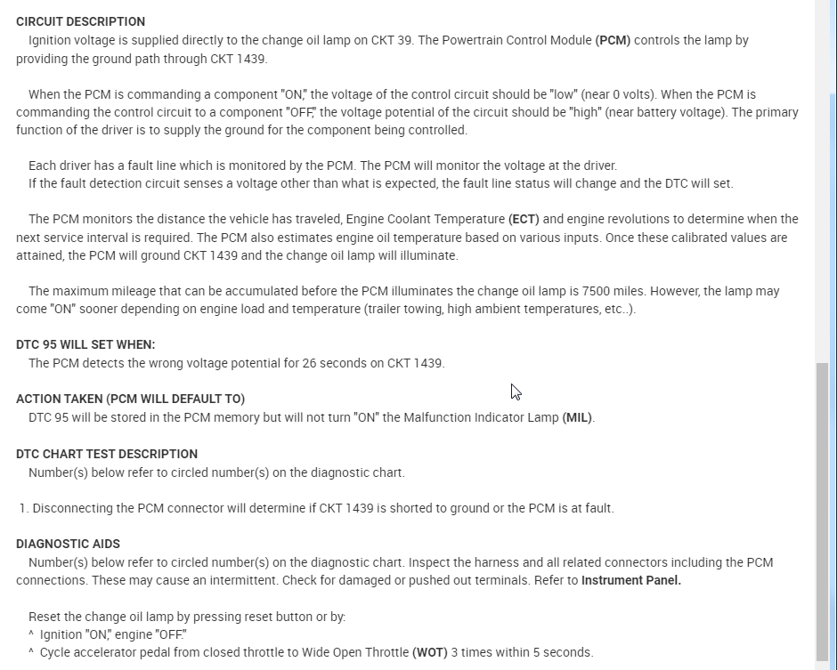

I have installed this engine and transmission into a 1951 Chevrolet. I am using the stock computer and am getting trouble codes 95 (oil life) and 97 (4K pulses). I can find no other information for either code or how to keep them from reappearing. Can you help?
Jun 15, 2020 at 11:34 AM
Without knowing what all you transferred over it is hard to answer your question. However, I attached the info and testing about these codes.
Let us know if you have questions as you work through this.

I now understand the wiring that causes these codes. Thanks.
