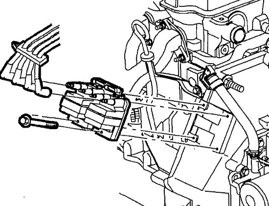

Is the engine misfiring? I have seen the coil pack go out and cause this issue, but there are different types can you please upload an image of yours? Does it look like this? Check out the images (below). Please upload an image or a short video in your response, so I can see what's going on. Ken

It does not misfire at all. We replaced the ICM about a month ago because of an ignition fuse that would blow. Once replaced, the engine ran great!!

Ken, We we're able to solve the mystery. Found that the back plate for the Newly replaced ICU did not have the DC4 compound applied to protect against the heat generated by the engine block. That explains why, when at operating temperature, the fluxuating RPM would occur. We replaced the ICU, after applying the thermal barrier compound, no more code or check engine light!
