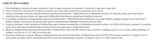

code 03, how do I trouble shoot that?

see picture for instructions. it is a distributor problem or wiring/ECM you may have to replace the distributor.
