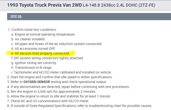

You are likely correct with your thoughts. If there is an exhaust leak pre-catalytic converter, it can draw air into the exhaust and cause the oxygen sensor to indicate a lean mixture. As a result, the PCM will add fuel.

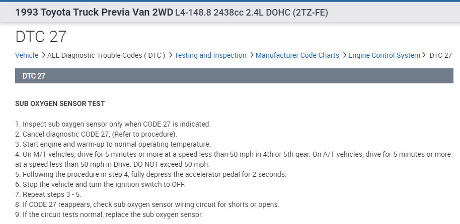

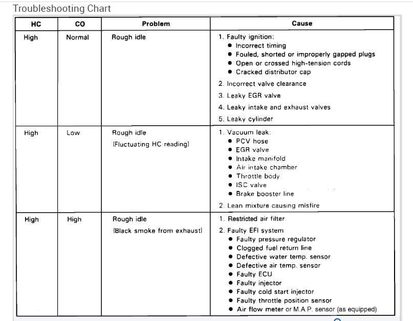

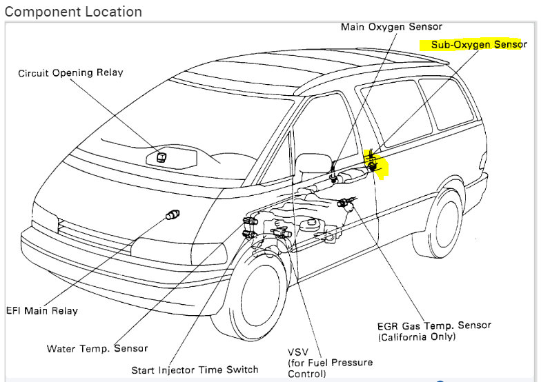

I attached the diagnostics for both codes below. However, I feel if you would repair the exhaust leak, it will likely resolve the issue. Also, an engine vacuum leak can be the cause as well or the sub-oxygen sensor located right after the catalytic converter. See pic 4.

Thank you, Joe. Will attempt to locate the exhaust leak and repair and check the rear O2 . The 25 and 26 codes rich and lean at the same time I hope will disappear.
