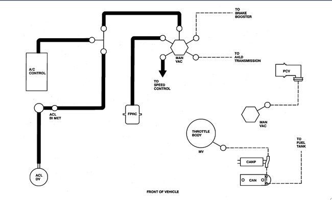

So my SUV is running like straight trash right now. From a dead stop as I accelerate it is seriously sluggish up until about 2,500 RPM's, when it finally coughs up a bit and decides to go faster. Sometimes, I can't get it to go above 20 mph, in which case I have to throw it in neutral and rev the engine up again until it feels sorta normal. I initially thought that once I replaced my fuel filter it started running rich, but I pulled codes and found out it was running lean. I got codes 181, 185, and 189, but I am not the most mechanically inclined person and I am learning as I go while I'm trying to fix all the little things on this car myself. I was going to clean out my throttle body and see if that helped alleviate some of the rough driving right now, but after getting these codes I am wondering if that will even help. What I need to know is what these codes specifically mean, and where the appropriate o2 sensors for those codes are located before I dive in to buying parts I don't need, or the wrong parts entirely.

So after looking over the pinpoint tests for these 3 DTC's, which are quite involved and require a lot of specialized tools, I would recommend looking over your vehicle's vacuum lines and air intake tract, especially the intake manifold for leaks. In the diagrams down below I have included a diagram of the vacuum lines for your vehicle. I have also included a link below explaining how to look for vacuum leaks. Pay special attention to the intake manifold portion of it.
Please go through these guides and report back when you are done. We can go from there.
