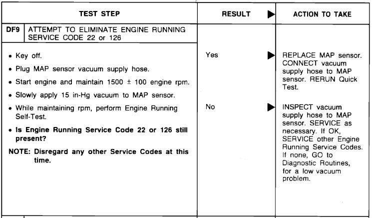

I was having my check engine light come on and i was reading the code and it threw code 2262 and i cannot find any where. if there is any way you can help it would be appreciated.

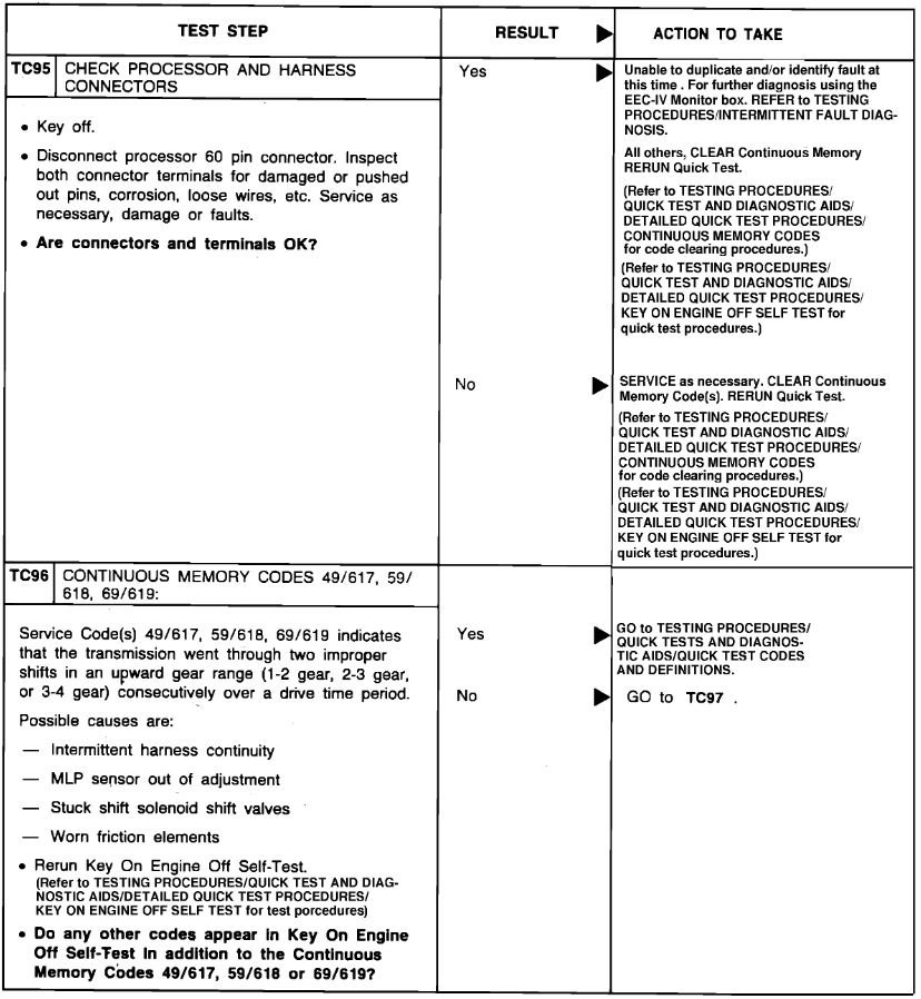

Those would be a code 22 and a code 62. Ford only used 2 and 3 digit codes at that time.

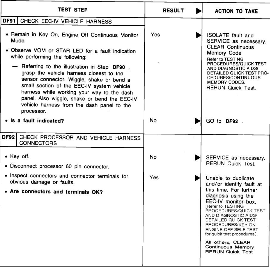

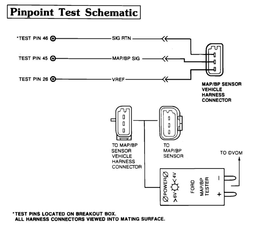

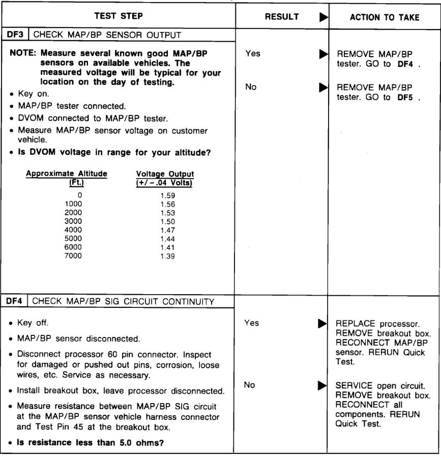

There are 3 different test states used by Ford. Key On Engine Off, Key On Engine Running and a Continuous code.

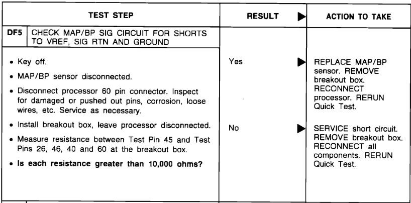

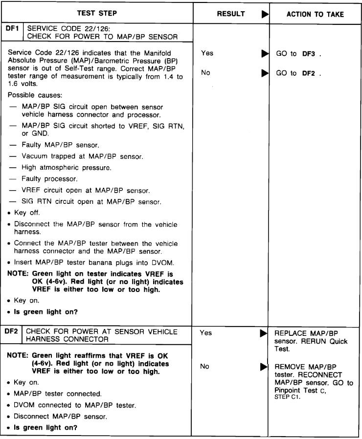

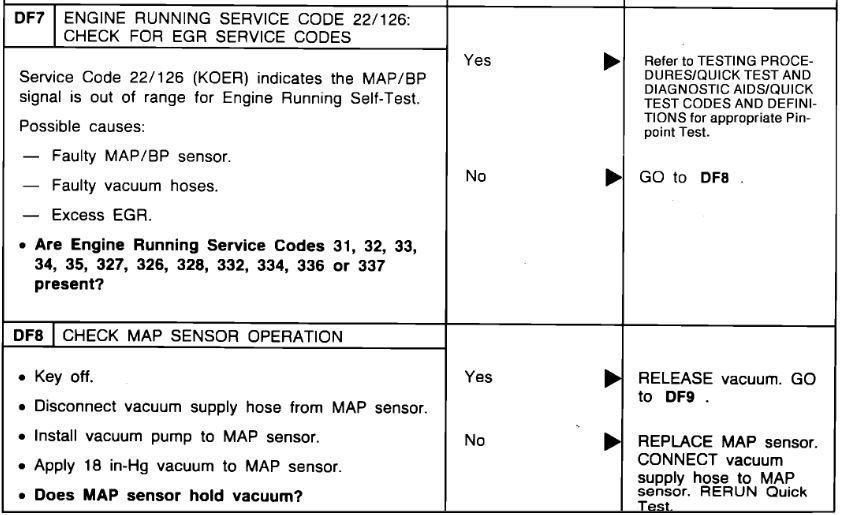

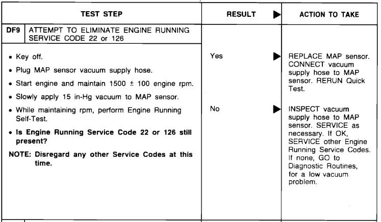

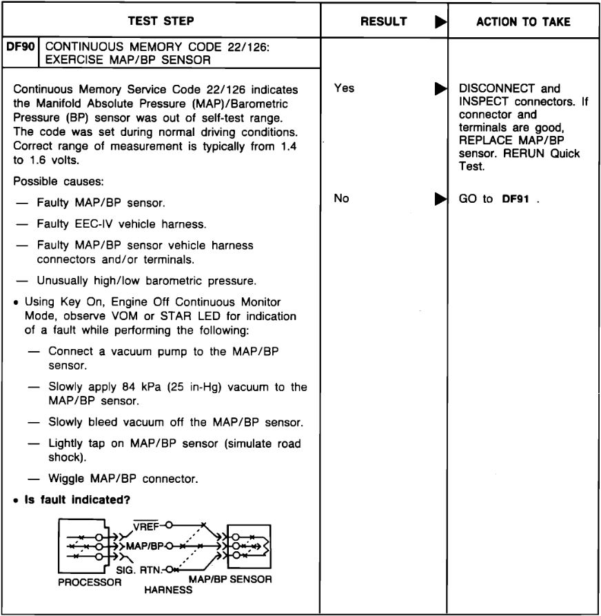

For the code 22 there are all three versions and they use the tests attached. The first three are for KOEO, then the test pinout, then 2 for the KOER test and then the DF90 and up for continuous memory codes.

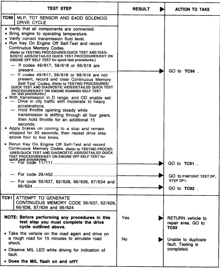

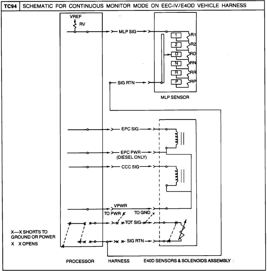

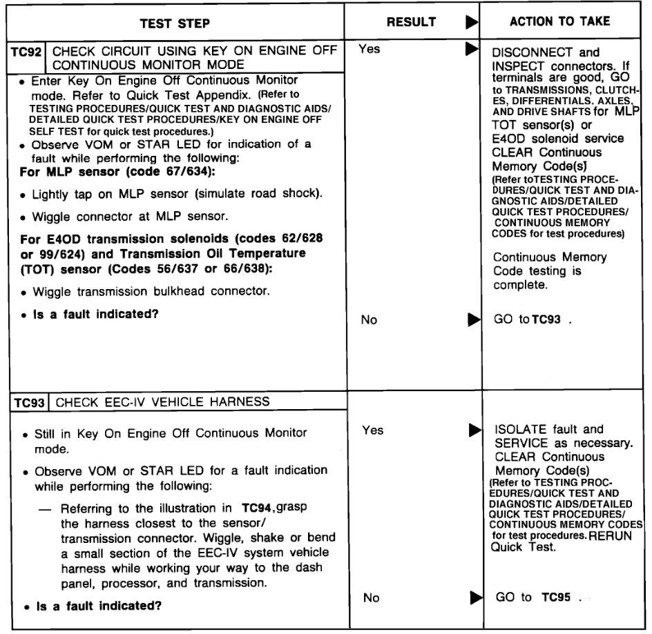

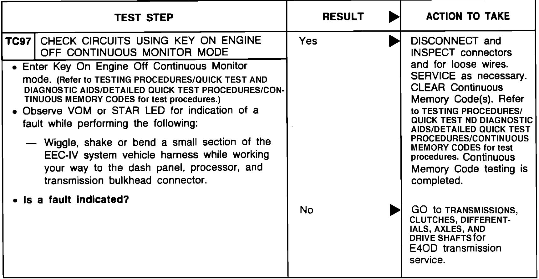

For the Code 62 as it's transmission related you use the TC tests as shown below.
The summary on the code 22 is basically replace the MAP sensor after you test all the connections if they all test good.
For the Code 62 it will depend on what the tests show. It could be a one time code as well.
