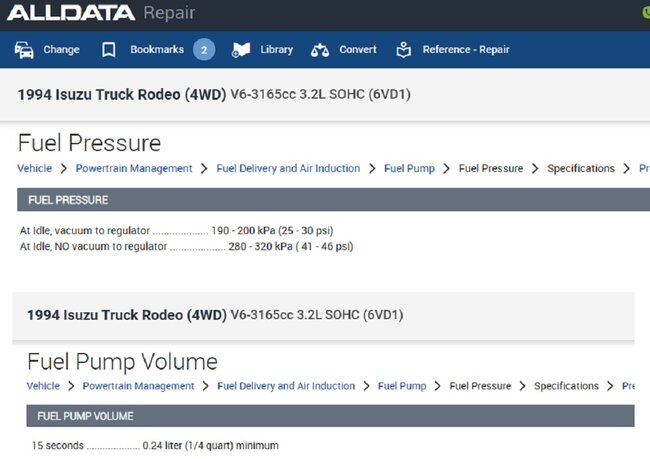

Okay, I'll just check Ignition timing first, Fuel Pressure 2nd. Do you have the specs? 94 Isuzu Rodeo 4x4. Thanks
Monday, April 22nd, 2024 AT 1:35 AM
CARADIODOC
  • 33,908 POSTS
Remember, the spec for timing isn't the issue. You're looking to see if it's bouncing around or cutting out.
Monday, April 22nd, 2024 AT 5:20 PM
DANNYBOY5474
  • 11 POSTS
Okay, thanks. I'm renting a fuel system pressure test tomorrow and I'll get back to you with the results.
Monday, April 22nd, 2024 AT 5:34 PM
DANNYBOY5474
  • 11 POSTS
So, I check everything today. The fuel pressure was within spec. When I hooked up a timing light it only bounced around like 2 degrees. By the way this motor has no distributor, Just 3 coils. Anything else I should check? Thanks.
