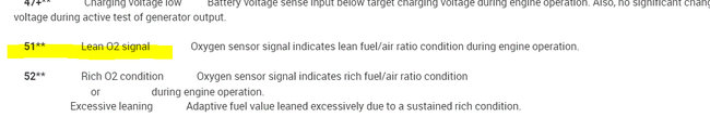

The code is related to the air/fuel mixture. However, to be more specific, it indicates a lean fuel mixture based on oxygen sensor signals. (See pic 1 below)
A lean mixture is usually the result of either an engine vacuum leak or a low fuel pressure issue. Here is what I suggest.

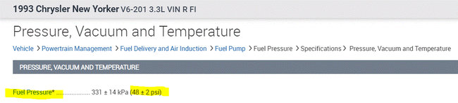

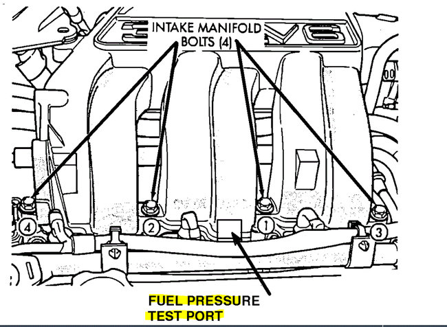

If nothing is found, confirm the fuel pressure is within the manufacturer's specifications. Note the test port is at the front center of the fuel rail. See pic 2. Pic 3 provides the pressure specifications.
Here is a link that explains how to test pressure:
