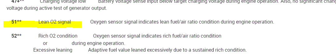

It pulled code 51 after I reset codes via the battery disconnect method wouldn't run on the first few startups it acted like the TPS was bad. Then every start after that was fine, then rough idle when cold, no vacuum leaks, new fuel filter, cleaned throttle body and cleaned idle air control motor it was carbon all over it. code 51 for Chrysler just says air/fuel at limit don't know what it could be or what that meant it also has small exhaust leak at muffler.

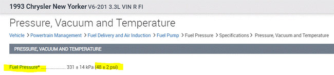

The code is related to the air/fuel mixture. However, to be more specific, it indicates a lean fuel mixture based on oxygen sensor signals. (See pic 1 below)
A lean mixture is usually the result of either an engine vacuum leak or a low fuel pressure issue. Here is what I suggest.

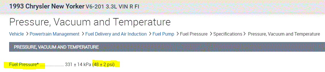

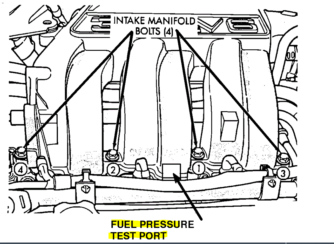

If nothing is found, confirm the fuel pressure is within the manufacturer's specifications. Note the test port is at the front center of the fuel rail. See pic 2. Pic 3 provides the pressure specifications.

Let me know what you find or if you have questions. Please remember, the fuel system will be under pressure, so cover the port with a rag and have the engine cool when connecting the pressure gauge. Also, protect your eyes.
