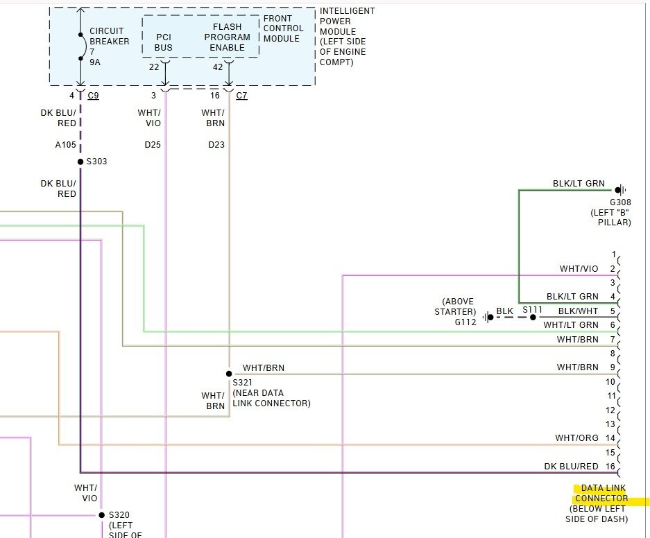

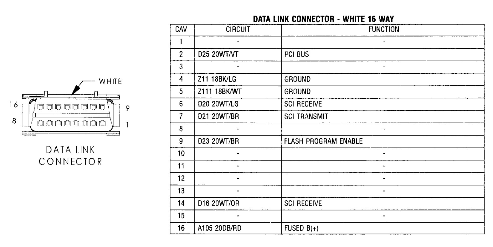

Can i get a diagram of the wires going into the back of the OBD harness?
2001 CHRYSLER TOWN AND COUNTRY
215,000 MILES • 3.8L • 6 CYL • 2WD • AUTOMATIC
MIKE GARREN
I need a picture of the wires going into the back of the OBD harness, The pins in mine all came out and i need to put them back in the right place.

Hello, yup we have a diagram for that, you'll need to adjust the tabs on the wire connectors if they fell out. Give me just a minute.
Sep 11, 2024 at 3:54 AM
AL514
  • 5,670 POSTS

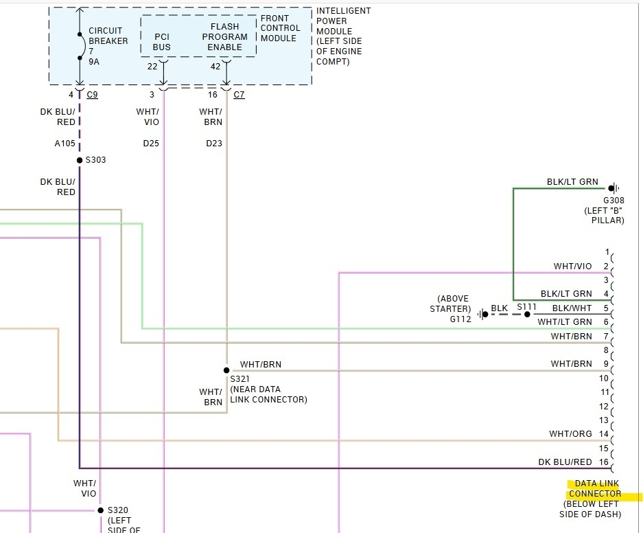

The 1st diagram is the Data link connector pinout, and the 2nd diagram is the wiring diagram going to it so you can verify the wire colors. Pin 16 is battery power and 4 and 5 are Grounds. Thats the basic OBD2 setup.
