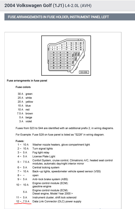

Hi there, i cannot connect to the OBD scanner because port don't have power. which fuse is it for OBD on car listed above 5?

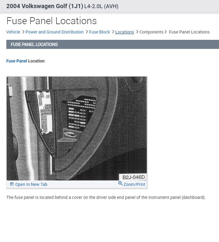

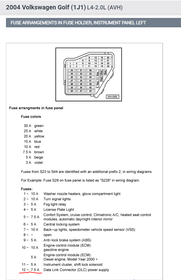

Look at the fuse panel on the left side of the dash.
It should be number 12, 7.5A fuse.
I have attached diagrams below.
