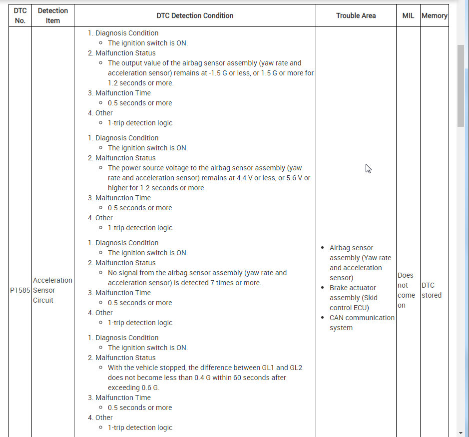

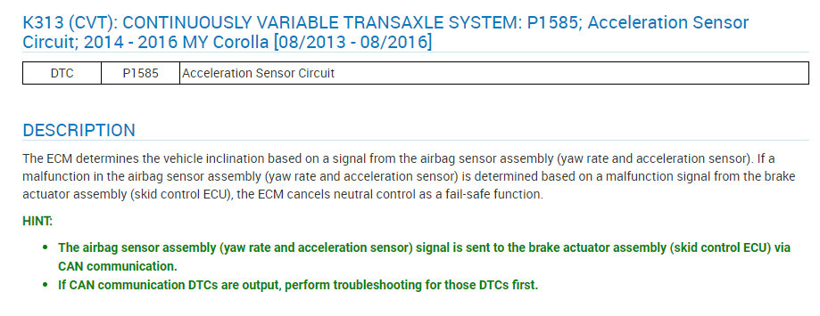

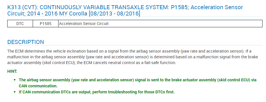

Morning KASAKENNY1. Well, in other threads in this web site I talked about transmission problem in my Toyota Corolla. the codes I have is P1585. When I Put P to D or R it is hard to move. I have dash lights ABS, check engine.

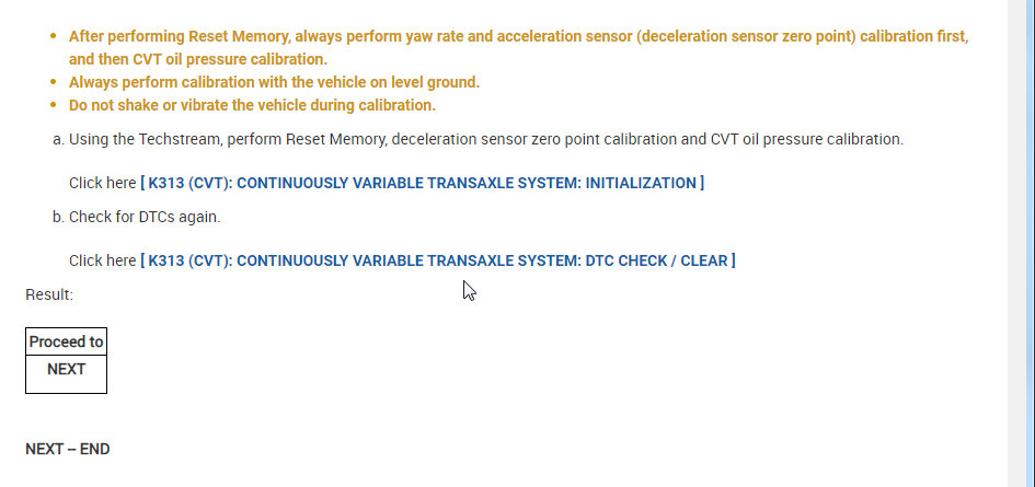

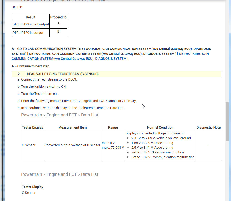

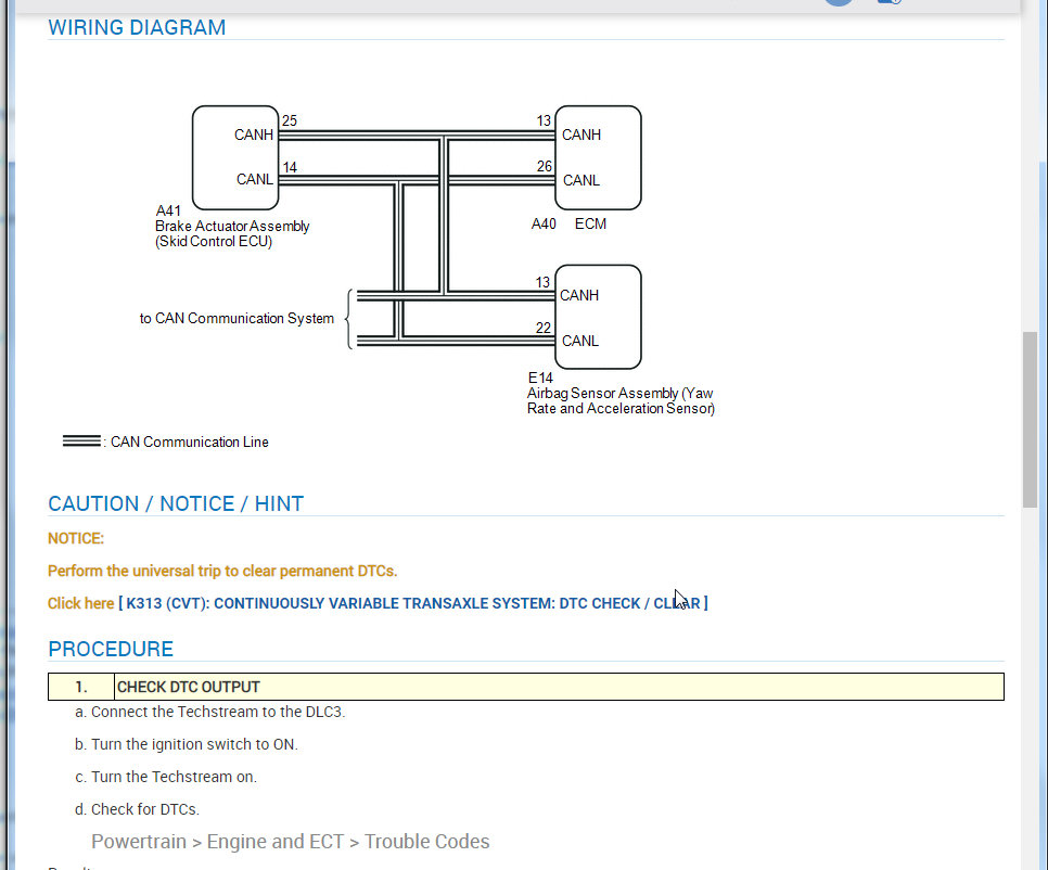

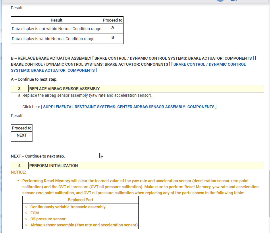

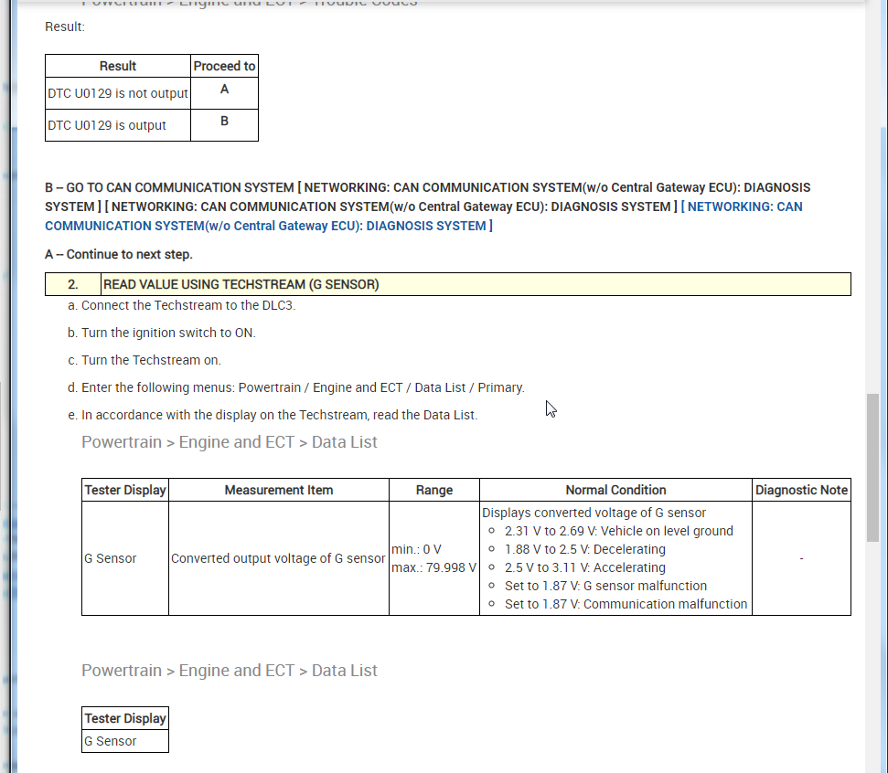

Okay. So, if this related to the other post where you found corrosion in the connector and this was under water then I suspect you have other connectors like that.
If this is the only code you have then we need to follow through this testing and determine what the issue is. You do not need a scan tool that can read the CAN to figure this out. It is related to the CAN network but that tool is not needed.
Run through this testing and let me know what questions you have. Thanks
