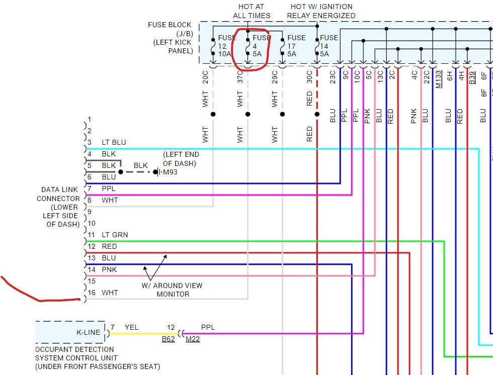

OBD port has no power. What fuse do I check?

Pin 16 in the DLC is powered by fuse 4 in the fuse box in the left kick panel. That fuse is also the power for the door lock control module.
