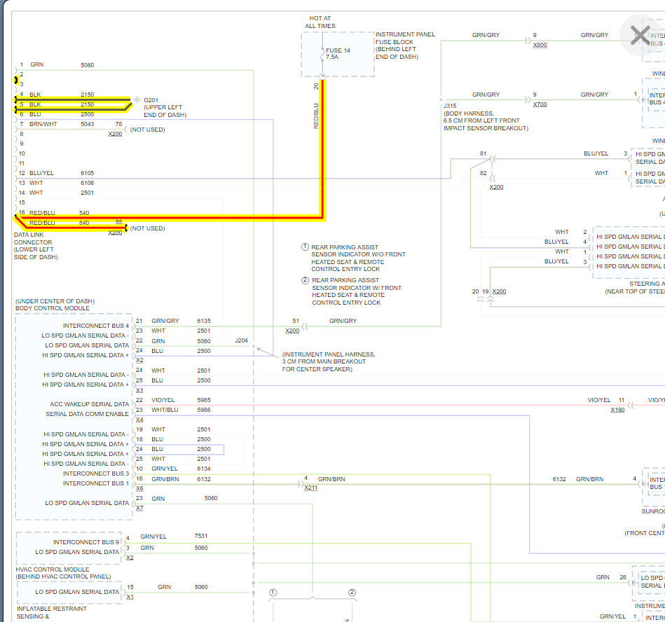

The previous owner tried to piggyback off OBD power line, clipped through the cable, leaving 1/8" stub. Replaced OBD port, re-soldered all wires, have power, but got message that it is not connecting to ECU. (OBD program (Torque) sees chip code for OBD reader, shows power to reader.) What else could be wrong?

Let's start with the DLC issue and then we can get a new post started for the performance issue. Clearly we need to fix the DLC issue first then tackle the others once we can use the scan tool. We need to keep each post to one issue so that others can find the issue if they have the same one and they won't find that under a different heading.
Let's start with checking power at the DLC to find out if we are in fact getting voltage on the wires shown below.
Here is a guide that will help with this:
https://youtu.be/6Tlg3JmgNSQ
However, it sounds like you have power if the tool comes on but not communicating. Can you get a picture of what this is saying because I am not sure I understand what you mean by a chip reader code.
Is this a code saying that the PCM has a chip in it?
If so, then I suspect you have an issue with the ECM and scan tool compatibility. This is normally caused by someone adding a performance program to the PCM.
Are there other alterations to the vehicle?
Let's start with this and go from there. Thanks
