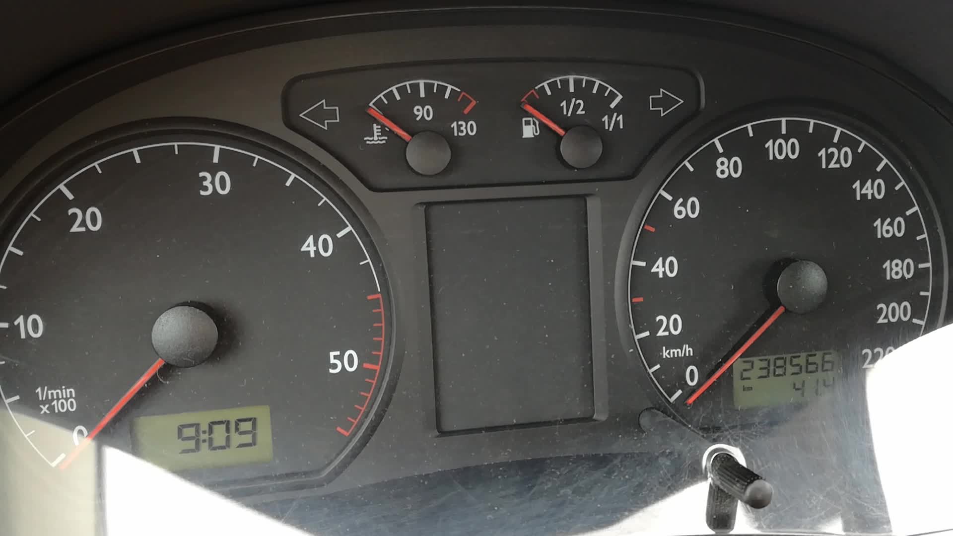

Hello everyone.
I have problem with OBD port. When I plug in an elm32 or different type of diagnostic tool it does not communicate. I have checked it for blown fuses but they all are fine, even the cigarette lighter fuse. I opened it and saw that it use ports 4,6,7,14,16.
Please help!
Thank you very much.

I do not have a wiring diagram for the Volkswagen Polo. If the scan tool, etc., is powering up and the check engine light does come on for bulb check, then make sure the wire from the engine control module to the pin at the DLC is okay, so disconnect the plug at the ECM, using an ohmmeter check the wire for an open or short to ground. The rule of thumb is the wire should be under five ohms placing one ohmmeter test lead at the DLC pin and the other ohmmeter test lead at the same color wire at the disconnected ECM plug pin. Do not forget to also check to make sure the wire is not grounded also, so attach one ohmmeter lead to one end of that wire and the other ohmmeter lead to a good metal ground, then the reading should be infinite.
If the scan tool will not power up, make sure the pin from the fuse at the DLC has power when the key is on run/engine off. If the check engine light does not come on for bulb check, make sure the ECM fuses are not blown and check the ECM grounds for being loose.

The check engine light does not come on as you can see at the video. Now I am trying to find the ECM grounds and to check them as well. I will keep you updated.

Hello guys
Finally I figured it out where the problem was that my OBD2 port wasn't working, it was a loosen fuse, no.29 related to DLC, AC and telephone.
