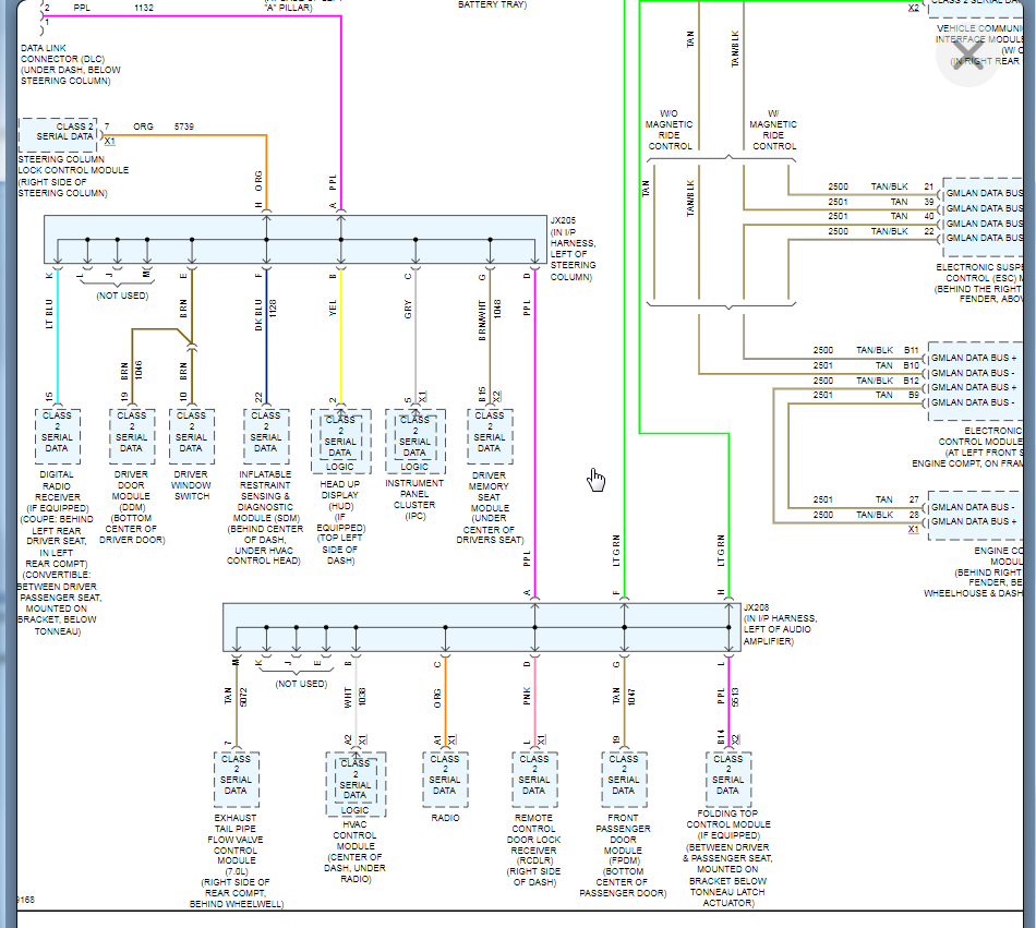

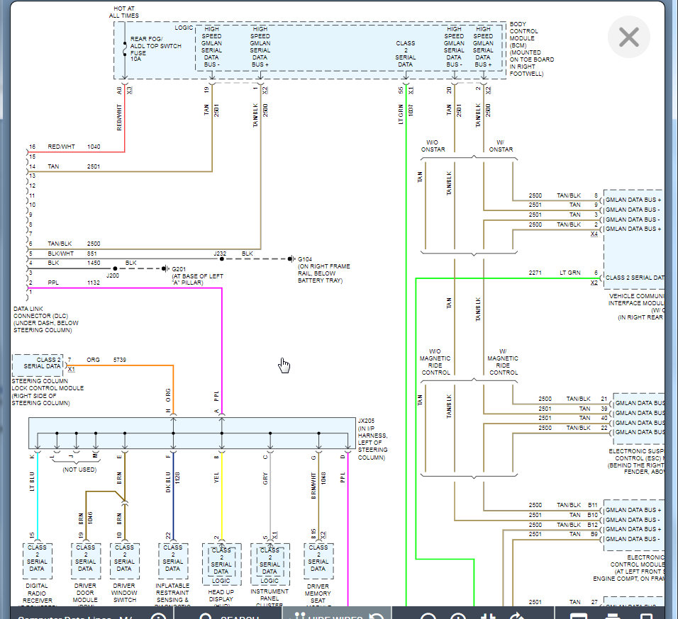

OBD2 when connected and key on, I get communication error. car turns on and runs, I get check engine light when there is a problem.
might need a diagram or something. :)
May 17, 2021 at 12:57 AM
i assume you meant it was a Corvette and not a Chevette?
Sounds like there is a communication/wiring issue with the BCM so we are going to need to start with checking the voltage to the DLC just to make sure it is not a wiring issue with just the DLC.
Here is a guide that will help with testing the wiring:
Basically the way this works is the DLC and scan tool communicate directly with the BCM and then the BCM communicates with the other modules.
So we need to see what the voltage is on pin 6, 14, 16 and that there is a good ground on 4.
Please let us know what questions you have.
