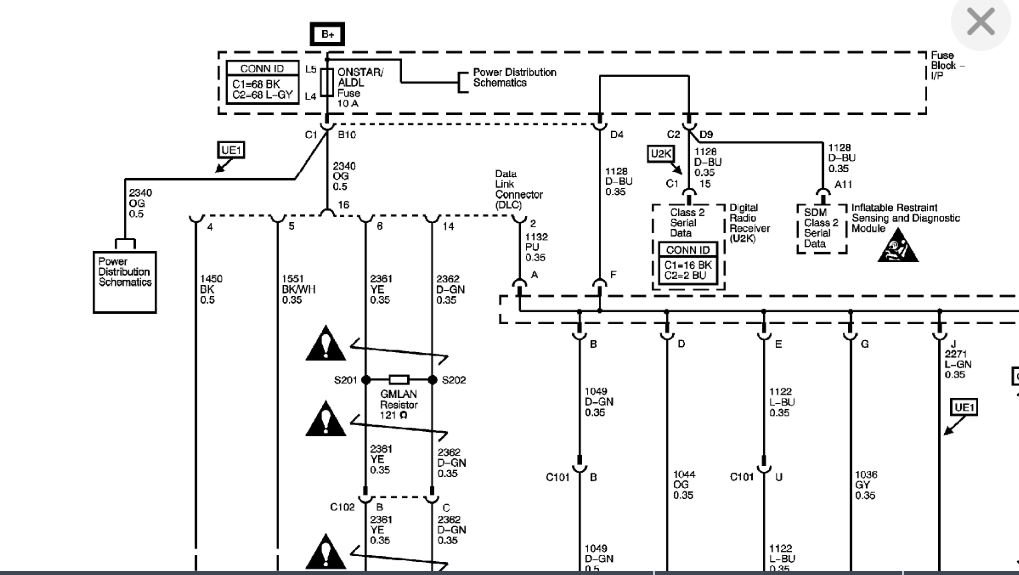

The DLC is powered by its own fuse in the inside fuse block in the car. Check for the fuse block on the end of the dash when you open the door. You have to pull off a cover.
I attached a wiring diagram for you to view on what it says for the fuse.
What concerns me is why it failed. Fuses blow for a reason. If you do not find the reason it will continue to fail.

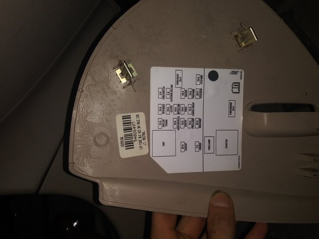

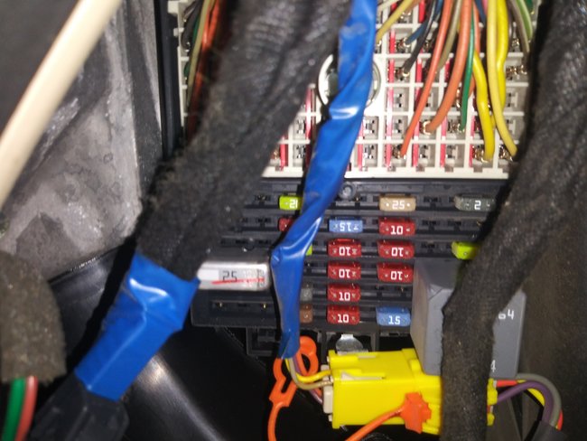

I have a different diagram for the fuse box on the end of the dash for a 2006 Buick LaCrosse.
Aug 13, 2018 at 2:59 AM
DENALIWONTSTOP
  • 6 POSTS
I attached pictures of the diagram and the fuse box. Thank you.

Did you use a test light and verify power to fuses and power on both sides of the fuses?

New one in what? Did you check for power on pin 16 of the DLC?

The fuse is not under the hood it is in the interior fuse block as listed.
Did you verify power on all the fuses on both sides?

I changed the cigarette lighter fuse under the hood, but I do not have the DLC fuse on the diagram.
Aug 13, 2018 at 6:51 AM
Again, the cigarette lighter fuse is not the fuse.
It is the OnStar fuse in the interior fuse block as indicated in the diagram.
If you have power on both sides then you have a wiring issue between the fuse block and the DLC.
