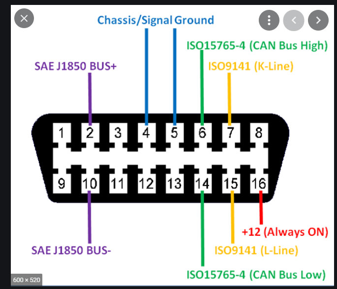

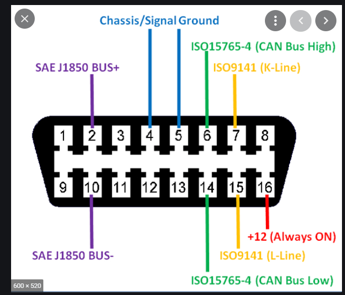

Engine light on, scanner check no power. I check the terminal got ground through system got voltage through system. Used my ohm meter. Battery post 2 port got reading ground 3 ports got reading?
Jun 26, 2021 at 5:28 AM
Good afternoon,
I attached a diagram of the diagnostic port for you. Pin 16 is the power for the connector. Check the voltage there. It should have voltage all the time. Pin 4 is the ground.
I attached a diagram of the port for you to view. Check pin 16 for power.

Used jumper from positive post 2 #16 key off had power. Ohm meter on ohms got reading on terminal 3 and 4 how can a scanner show nothing?
Jun 27, 2021 at 1:00 AM
Forget checking for ohms. You do not use that as a check.
6 and 14 are the serial data line that should have 60 ohms but if the scanner has no power then it is a moot point.
Did you check pin 4 for ground? If you did, then it may be your scan tool not working. You should have the scanner to light up with 4 and 16 workings.

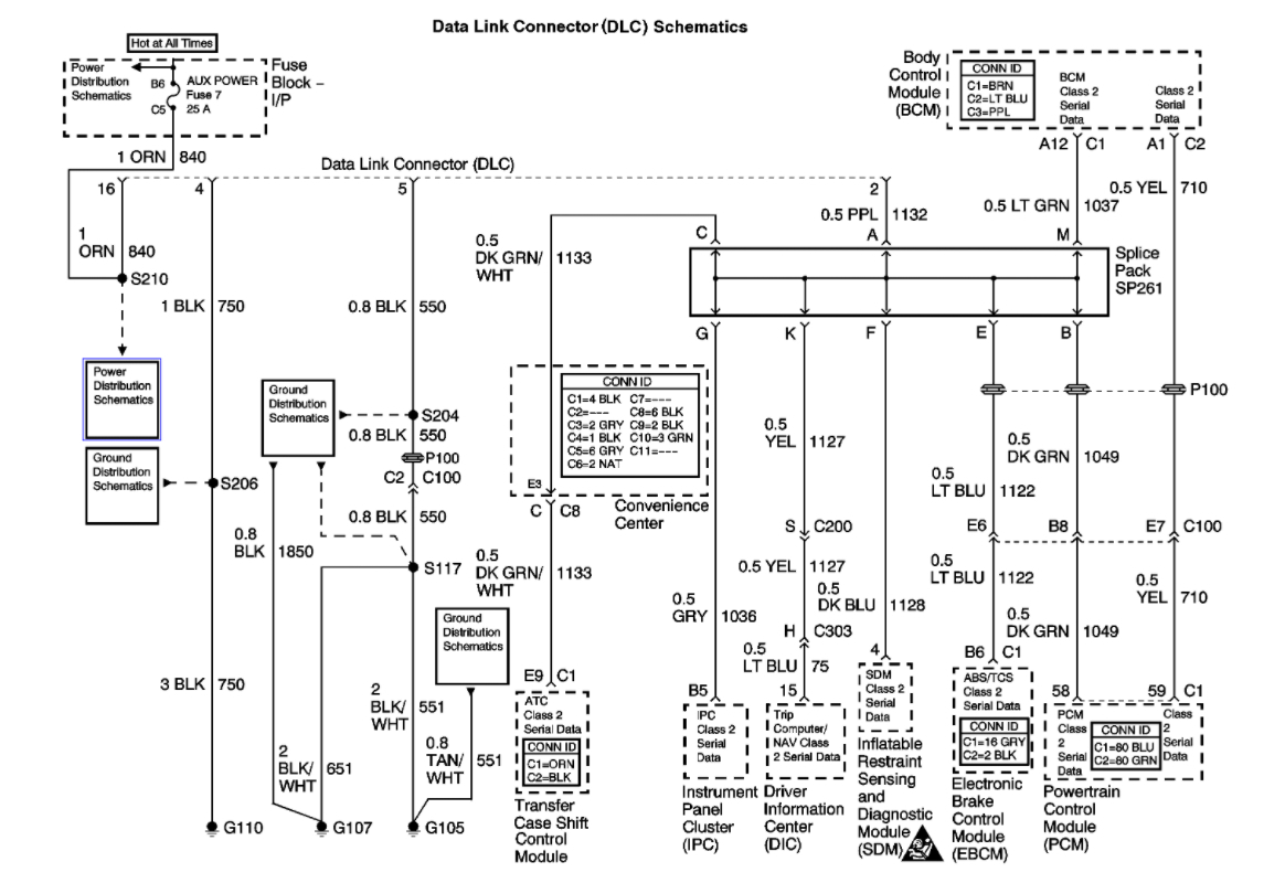

I went and had OBD port checked with 2 different scanners still no power. The cigarette lighter fuse feeds the OBD so when I checked the main cigarette lighter had power 2 aux lighter had no power the fuses are under the dash. l will get around 2 pulling them later. do you think possible short or can they just blow over time????
Jun 29, 2021 at 5:19 AM
There is either a wiring harness issue or a short. Make sure the lighter is not shorted internally. Disconnect it and check for power to the fuse.

Traced problem blown 25 amp fuse which is the aux power. 2 check 4 short I took my test light disconnected positive post clipped my test light 2 positive cable put the other 2 positive post light came on. This must power 2 aux cig lighter which didn't work. If I put a fuse in will pop?? How would go about trying 2 trace wire???
Jun 30, 2021 at 7:13 AM
Put the fuse in it. I would disconnect the wire behind the power port and see if it holds.

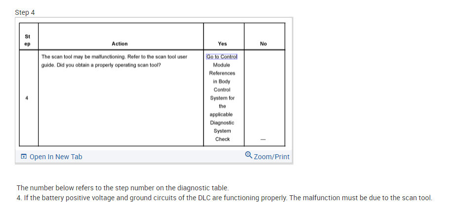

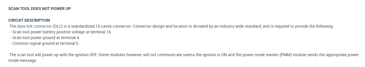

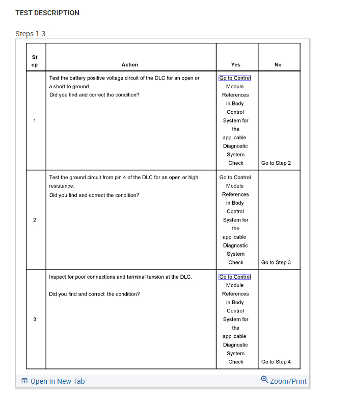

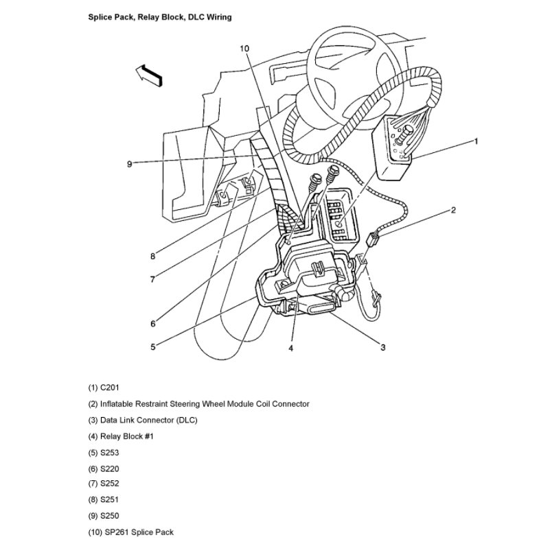

We fixed the code problem bad fuse replaced holding. My OBD works new prob. It states a fault in bank 2 sensor 1.? Is where is it located and how many????
Jul 2, 2021 at 3:57 AM
I found additional information on the data link connector. I attached them below for you to view.
Jul 2, 2021 at 5:05 AM
