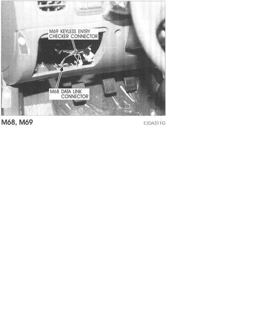

Where is the OBD port located? I looked everywhere and cannot find it!
May 18, 2018 at 12:16 PM
CARADIODOC
  • 34,373 POSTS
For all 1996 and newer U.S. models, it is standardized and it is supposed to be near or right under the steering column. Looks like they tried to hide it from you, but we are smarter than the engineers! Here is the picture showing its location.

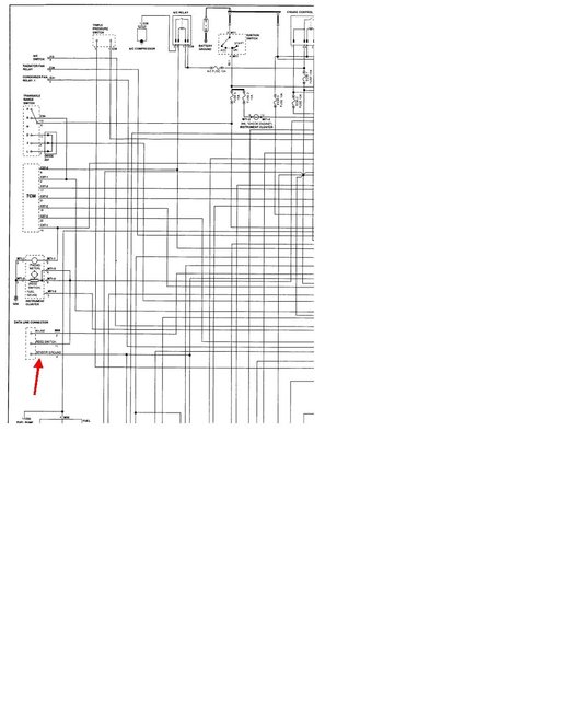

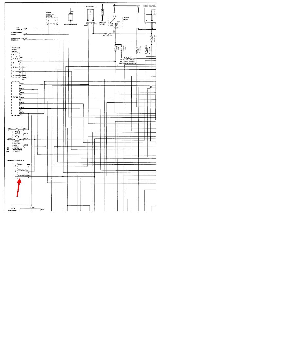

So, you are going to make this difficult! :-) Here is part of a circuit drawing I stumbled upon that shows the Data Link Connector, but there are things shown here that are under the hood, inside the car, and at the rear. There is no connectors shown so there is no way to know where things are unless you just know.
What I can add is I have read on occasion of people finding these connectors near the center console, and even under the hood yet on some early 1996 models. Be aware these are supposed to be easily available in case they are used for emissions testing in some areas of the country. Test operators will not put up with having to disassemble a customer's car to perform the required tests.

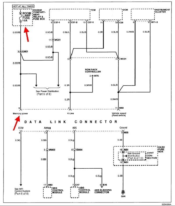

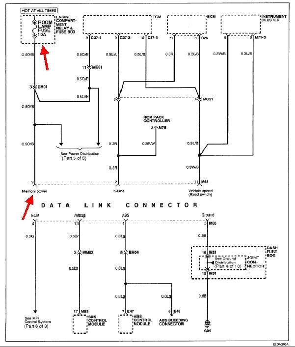

I found this diagram of the Data Link wiring. It shows power to the plug comes from the interior lights fuse, a 10-amp, in the under-hood fuse box. That feeds the transmission computer too, so if it is blown, you should be having shifting problems.

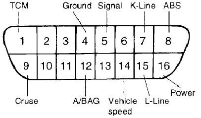

There are two other things to consider. The first is the ground circuit, terminal #5. Check that one for continuity to ground. The second is while these terminals were supposed to be standardized among all car brands and models, there were some terminals left open for use as seen fit by the manufacturers, and there have been some cases where they did not follow the standard. To add to the confusion, I found the diagram showing the connector terminals, and this one lists the ground as terminal #4, not #5. In the first diagram, terminal #9 is shown as the power terminal, and in the second drawing, terminal 16 is the power terminal. Check both of them for twelve volts.
