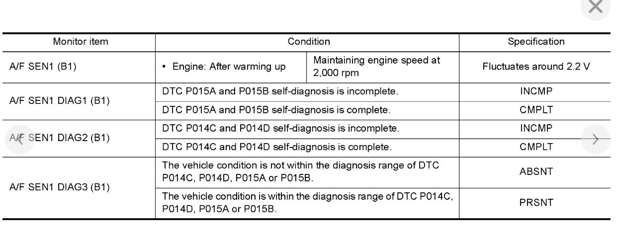

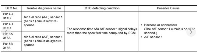

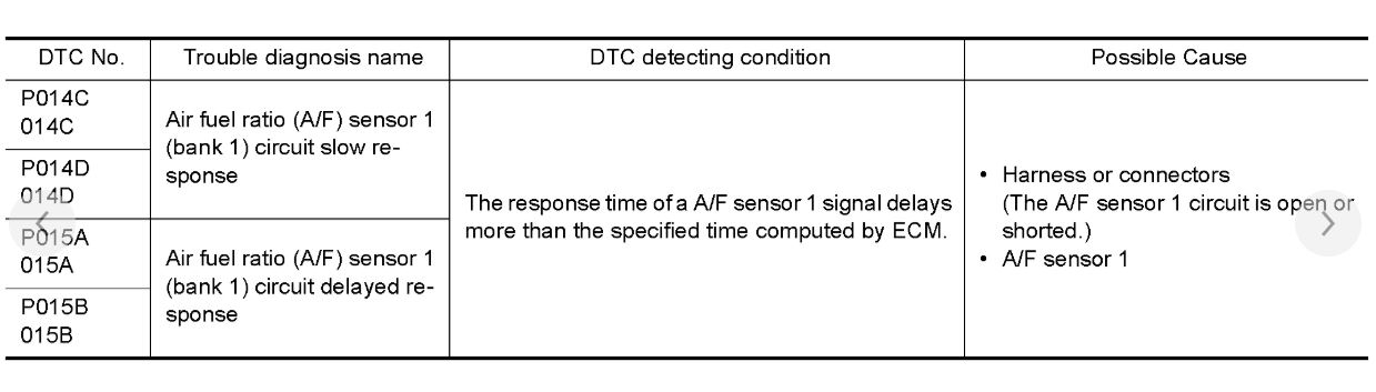

Good evening.
The code for an air/fuel ratio sensor. When this code sets, the main input for fuel control is not working. Running for 1,300 miles is a long way with no fuel control. This could cause damage to the catalytic converter as well as fouling out the plugs.
Remember, the guy at the parts store is a salesman, not technicians.
Below are the possibilities.
P015B
Descriptor
California Emissions
Except California Emissions
Probable Causes
Air Fuel Ratio (A/F) Sensor 1
Air Fuel Ratio (A/F) Sensor 1 Circuit Open or Shorted
