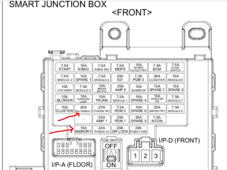

OBD port is not working because it has no power, and the center media as well.
Dec 16, 2023 at 9:17 AM
  • 55,433 POSTS
So, these both get their power from the SJB (smart junction box). I would start by checking the fuses which are under the dash on the left side.
Here is a guide that will help and a guide to help you check for power:
See if the memory fuse 10 amp and the multimedia 1 fuse has power. Please test with the systems on. If the fuses do not have power, then the SMB has gone bad and needs replacement. Check out the images (below). Please let us know what happens.
