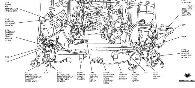

I replaced the solenoid valve and all the vacuum hoses. After a few miles the fault code returns and I need to get this car inspected.
Mar 2, 2019 at 4:11 PM
Good evening,
The code is for the EVAP system purge flow.
The most common issue is the purge valve. I attached a description and a flow chart for the code.
The Evaporative Emission Purge Flow Sensor is located at the lower RF of vehicle, behind headlamps.
