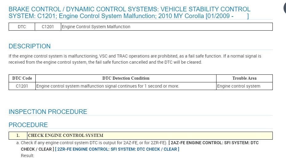

Code C1201. I've jumped #4 and 12 on the OBD slots, reset the codes. Car still has "VSC" Flashing on my dash as well as check engine light on.
Apr 19, 2020 at 3:20 AM
Good morning,

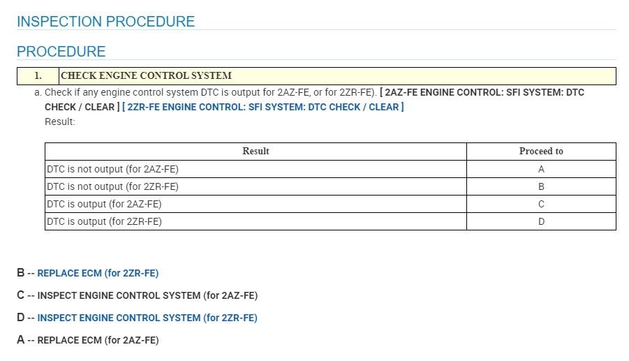

I attached the possibilities and the flow chart below for the code. I could be the engine ECM but depends on the motor that is in the car.
Does the car run okay?
Why did you jump those 2 pins?
