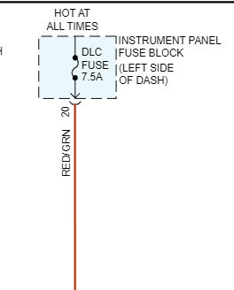

OBD scanner is not working. Which fuse does the OBD port use on my car listed above?
Aug 16, 2023 at 5:24 AM
Experienced Mechanic
55,562 POSTS

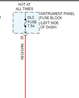

It is the DLC 7.5-amp fuse in the interior fuse panel.
Here is a guide to help you check it:
Check out the images (below). Please let us know if you need anything else to get the problem fixed.
Image (Click to enlarge)
Aug 16, 2023 at 9:27 AM
SANFURDT
MEMBER
2 POSTS
Thank you for the information. I found it and it was blown.
