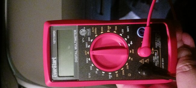

I went out and got a multimeter but can't figure out how to use it (the setting it should be on). Can you please tell me which setting to turn it to for each prong and what the meter number is supposed to be at?
Update: After watching a video, I think I did it correctly. I set it to 20 in the upper left of the meter and checked 16. It came up at 12.70. I changed it to 200 directly on the bottom of the meter. 4 was at 2.1 and 5 was 1.7. I think those are supposed to be at 0, right?

Sure, here is a guide you can go over to help understand the voltmeter, but I would use a test light which is easier, please go over both of these guides:

Yep, it was 104 in my computer office, so I was in a hurry. To check ground just use the continuity setting and listen for the beep. Use one lead to ground and the others on the blk and blk/wht and you should hear the beep. This means the grounds are working. Does the car start and run?
