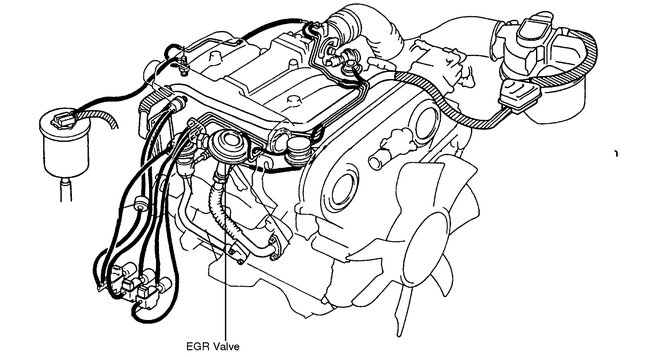

I am getting #52 (knock sensor) and #71 (EGR system) codes. I can’t find solutions for these repairs, any suggestions?
Feb 18, 2023 at 3:38 AM
  • 55,256 POSTS
Hello James,
These codes come up when the EGR valve or ports that feed the valve are clogged or the valve is not working, I would remove the EGR and use a flashlight it inspect the ports also while the valve is off. use this video to test the valve. Also check the vacuum line to the valve:
https://youtu.be/DqUCbbKdWf4

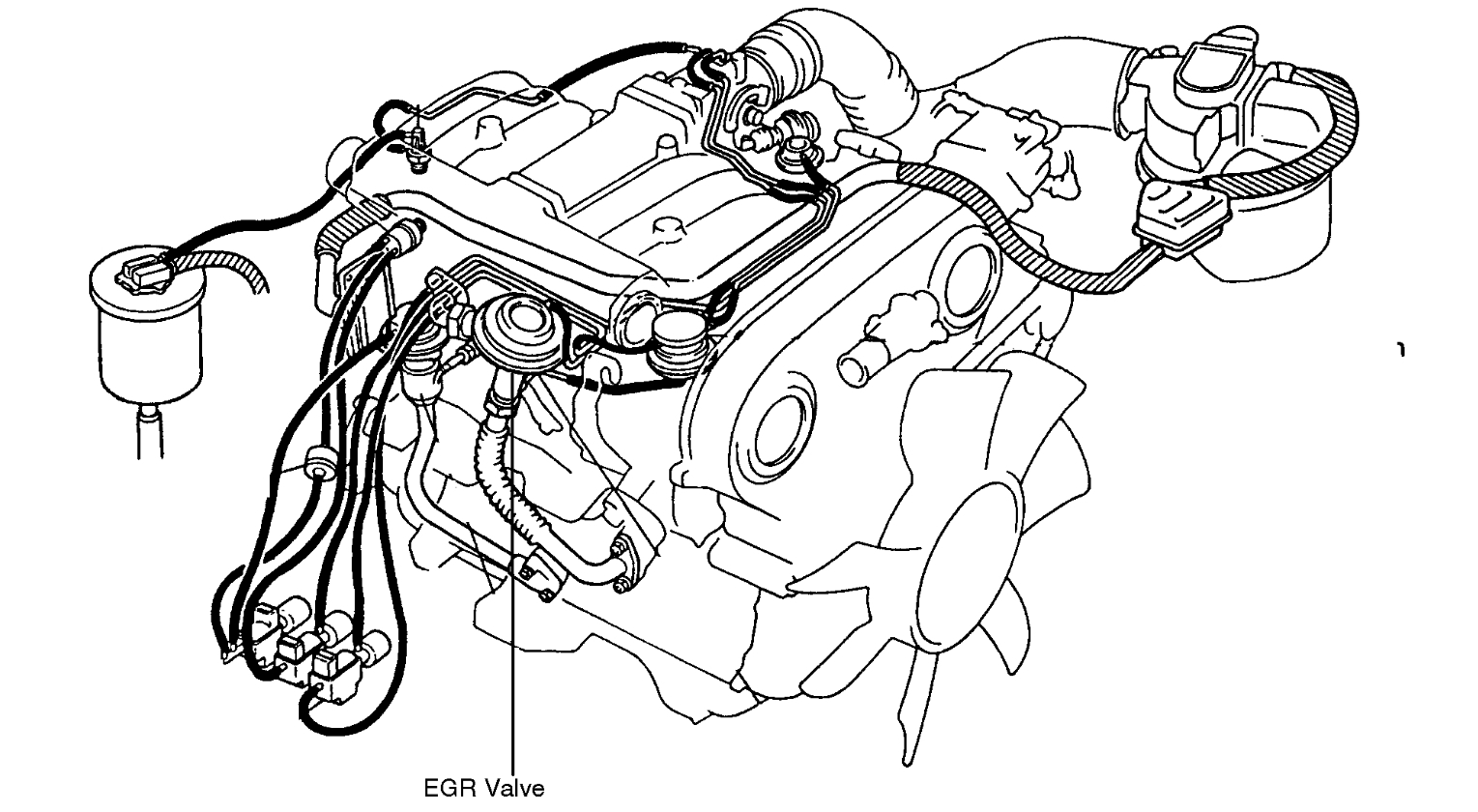

Here is the location of the valve in the images below. Please let me know or upload images of the problem.
