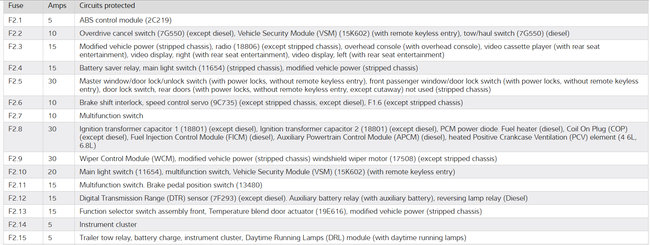

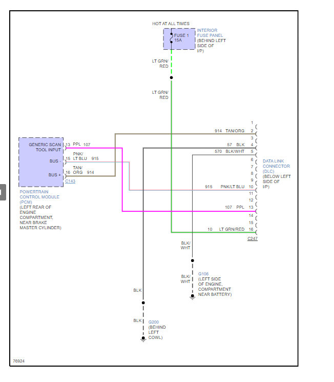

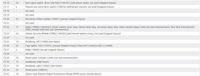

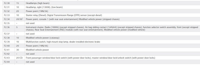

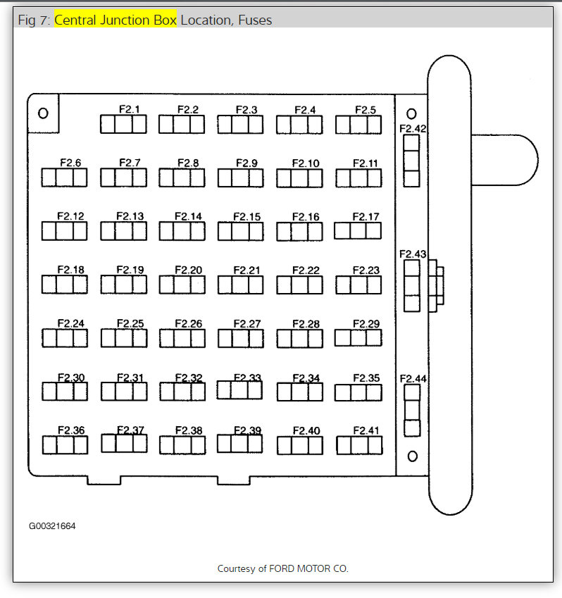

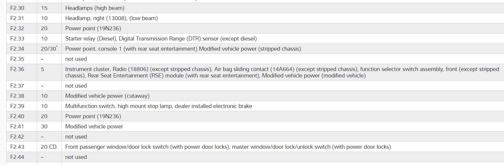

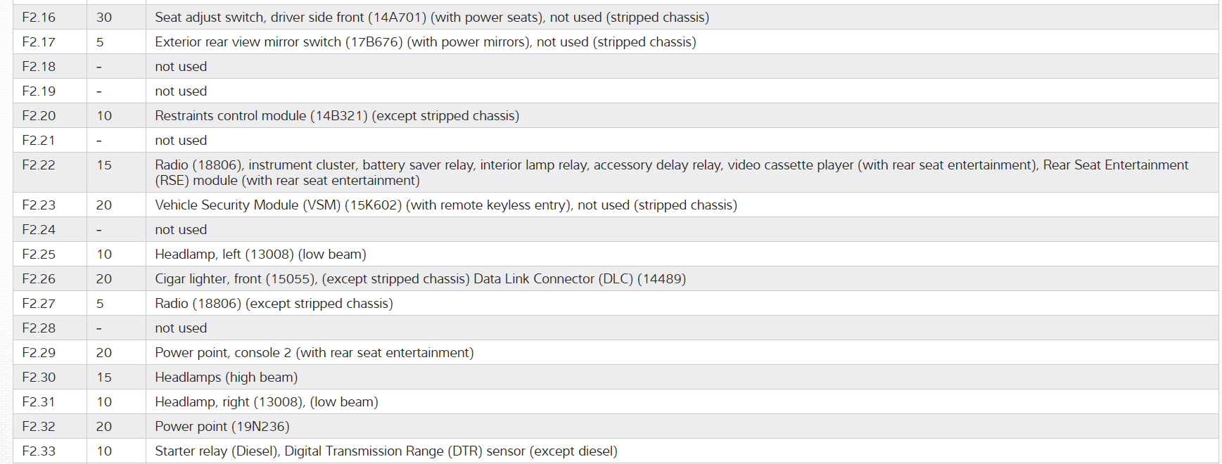

The fact that the engine stalls out when throttled is telling me a fuel delivery issue could be the problem like a clogged fuel filter, weak fuel pump, bad gas. We should run the codes though to see what comes up. Let's check the fuse # 1 - 15 amp in the interior fuse panel. here is a wiring diagram for the OBD2 connector so you can see how the system works and a guide to help you check for power at the fuse:
Check out the diagrams (below). Please let us know what you find. We are interested to see what it is. Check the ground for the ALDL as well.

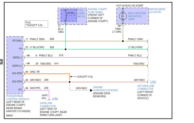

I agree 100% with your fuel system diagnosis and that was why I was trying to read codes. My research says that 1996 Fords above 8500 lbs are obd1. Mine is 9100. When I connect to the obd2 (Innova 5410 scanner) all I get is a "cannot connect to the computer " message. When i connect my ford OBD1 scanner to the obd1 connector I get nothing, and the vehicle does not go into the test mode described in the tester manual (Innova ford obd1 tester).
I have replaced the MAP and the TPS
I will check the fuses to see if I have a blown fuse, but you power the obd1 test directly from the battery. I should have checked continuity to the ground, but I didn't (yet). I need access to the computer. It seems that the transmission also is trying to start in second gear. I have to manually select first to get the van to move. I plan on finding a fuel pressure gauge to check fuel pressure, but I need codes.
I will reply again after I check the fuses and grounds, if I can find the grounds.

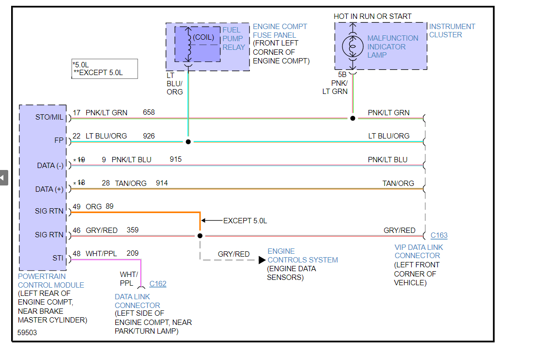

I found the OBD1 connector wiring diagrams so you can see what to test and how it works. Check out the diagrams (below). Please let us know what happens.

Okay. Fuses and grounds and everything else I could think of to check was checked. I have a parts van of the same year, model and engine. I pulled the computer from it and installed it in the "good" van. Same basic part number but the sub numbers are different. My assumption was that the basic engine parameters would be the same and if it ran, that would tell me that the computer was the problem. Well, it runs properly with the other computer and the code reader shows no problem codes. My question now is, do i get a "proper replacement" or run with the substitute and see what works and what doesn't?
Can I damage anything is my biggest question now?

I don't think you can damage anything. I would run it with the new computer and see what happens, if it has good power and no codes you should be okay. Use 2CarPros anytime, we are here to help. Please tell a friend.
