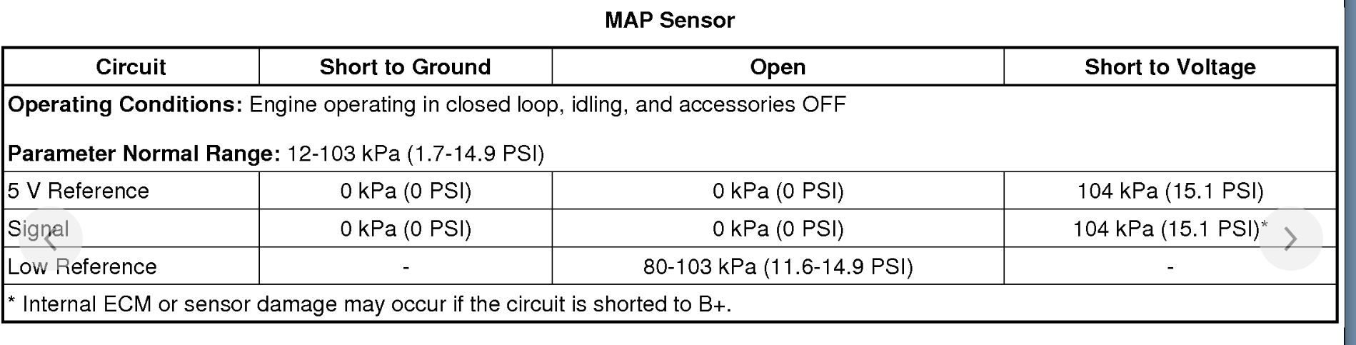

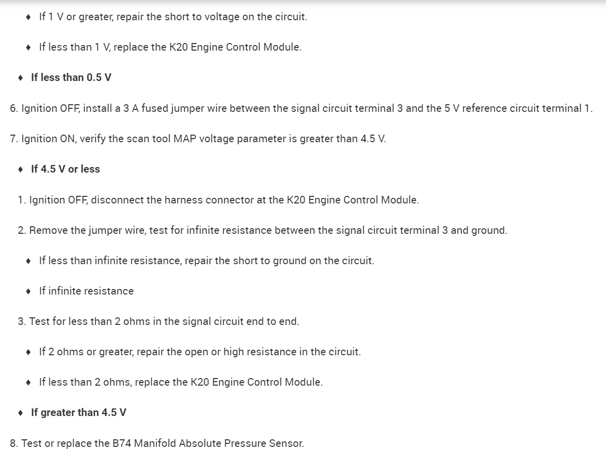

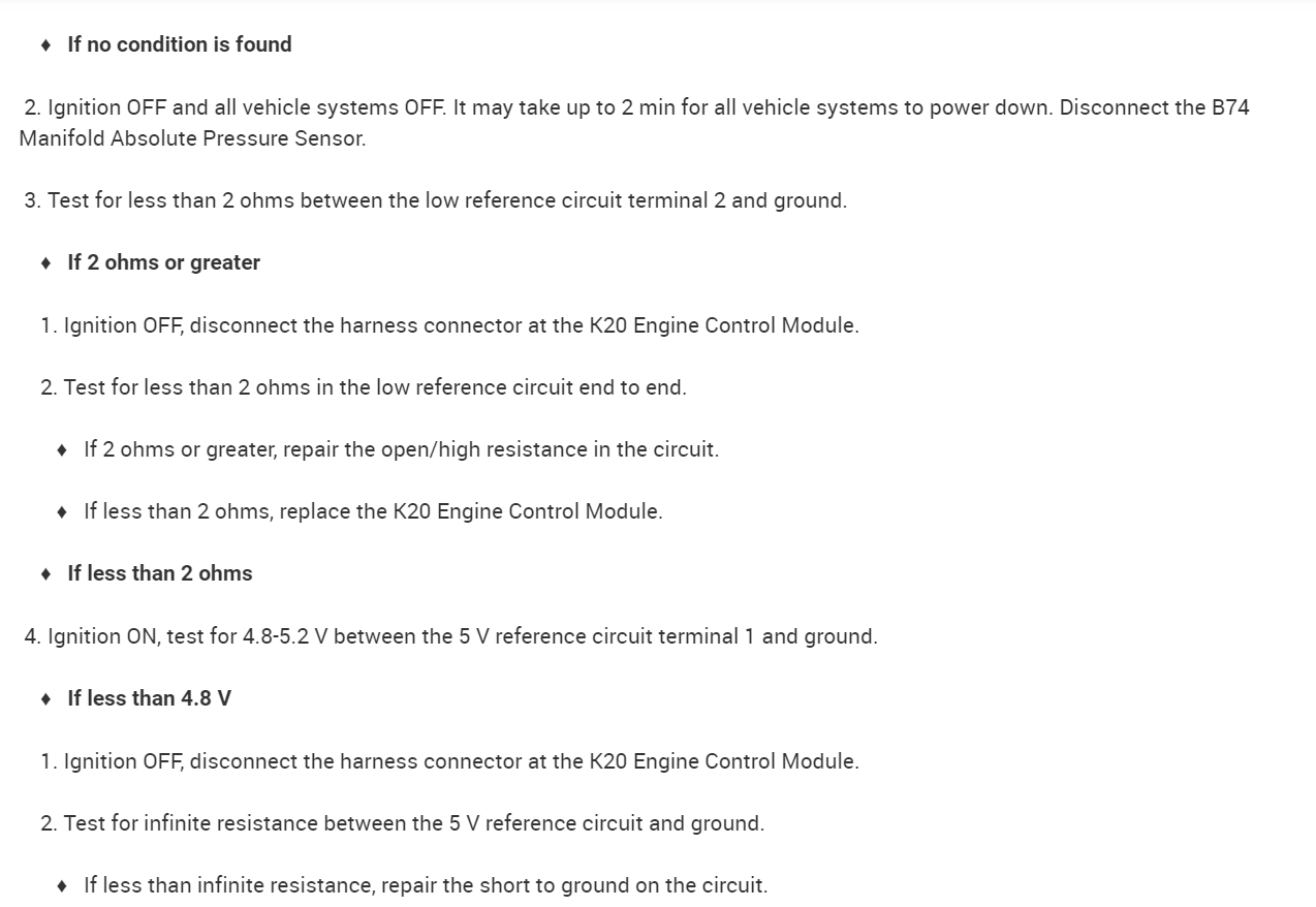

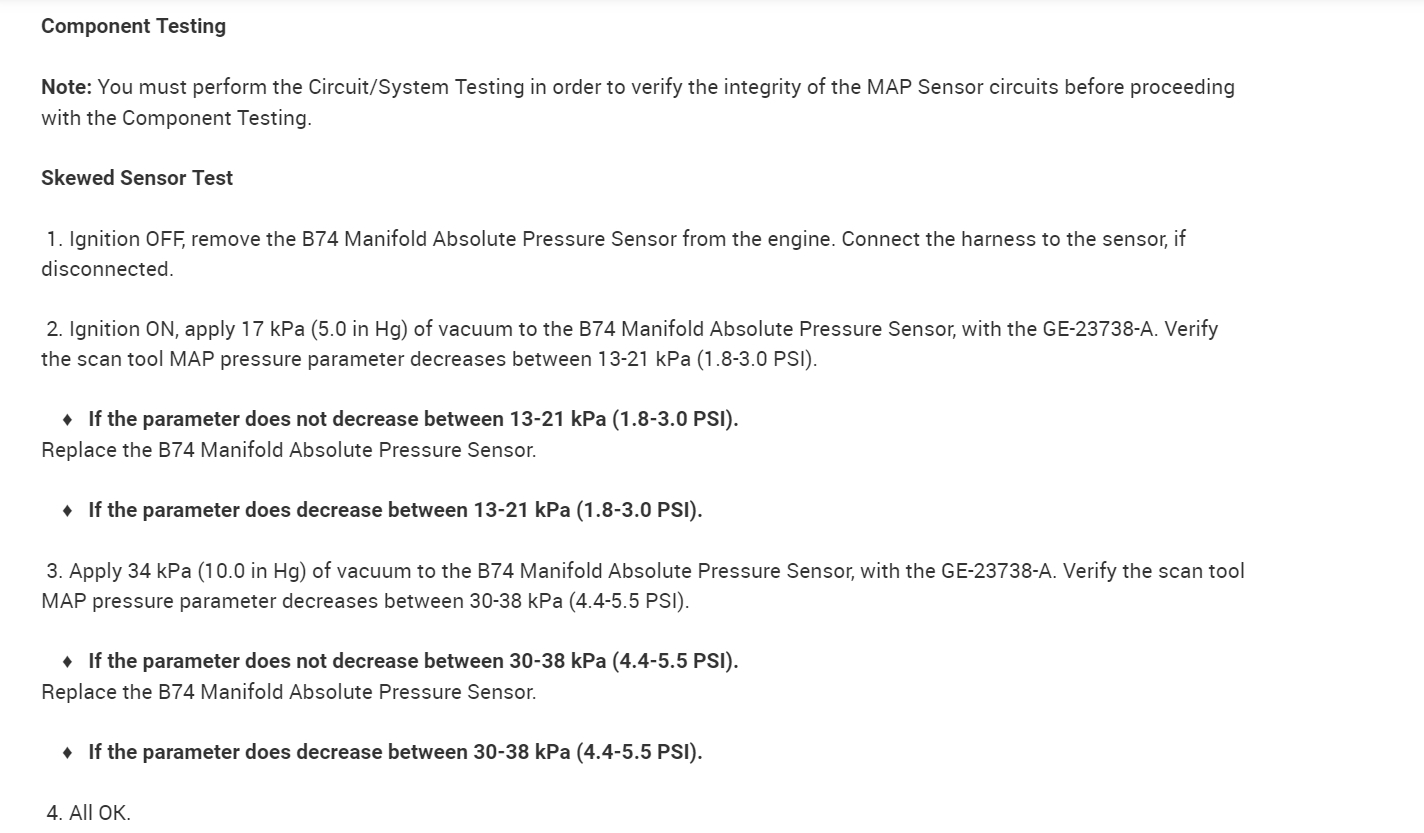

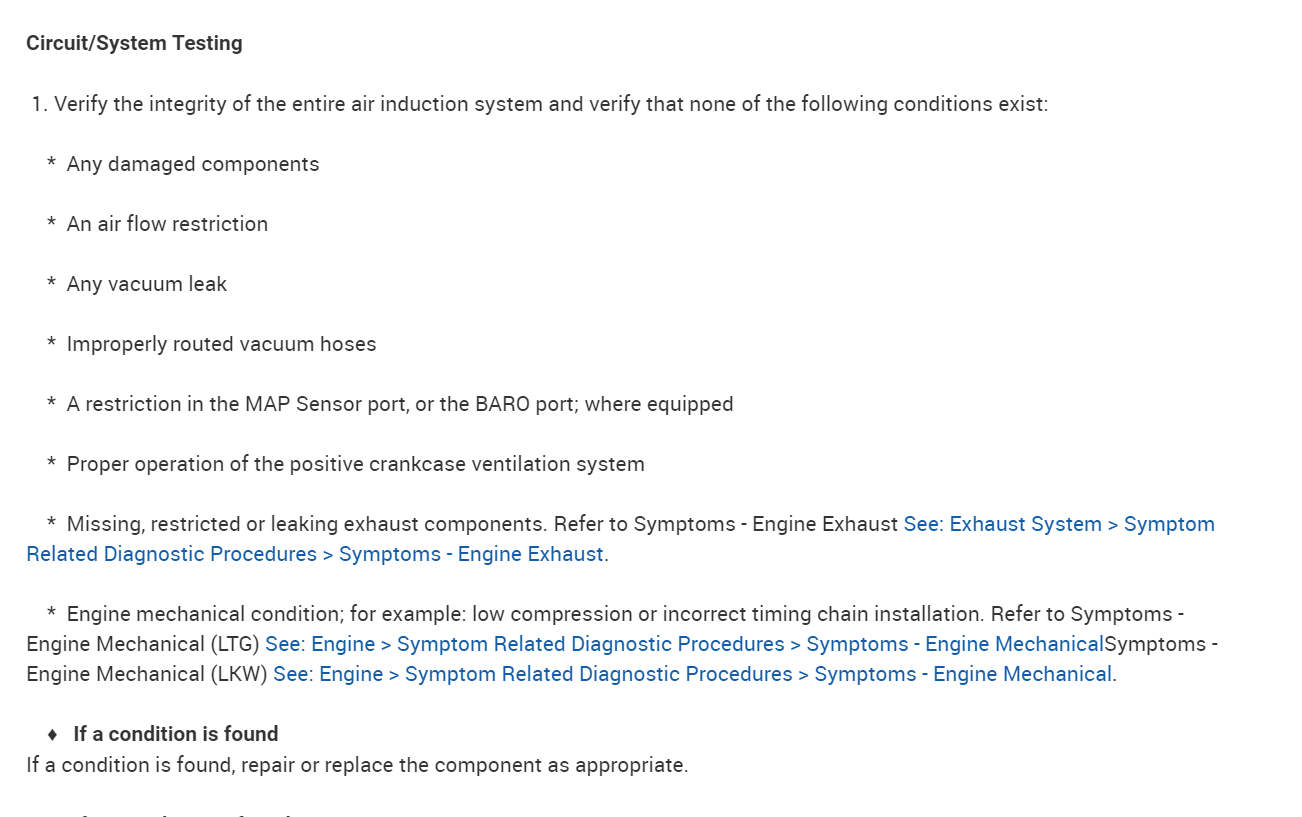

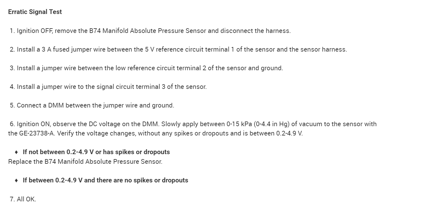

Have a P0106 code and just changed the vacuum pump. what should I try next?
Jun 17, 2019 at 10:22 PM
SCGRANTURISMO
  • 4,897 POSTS

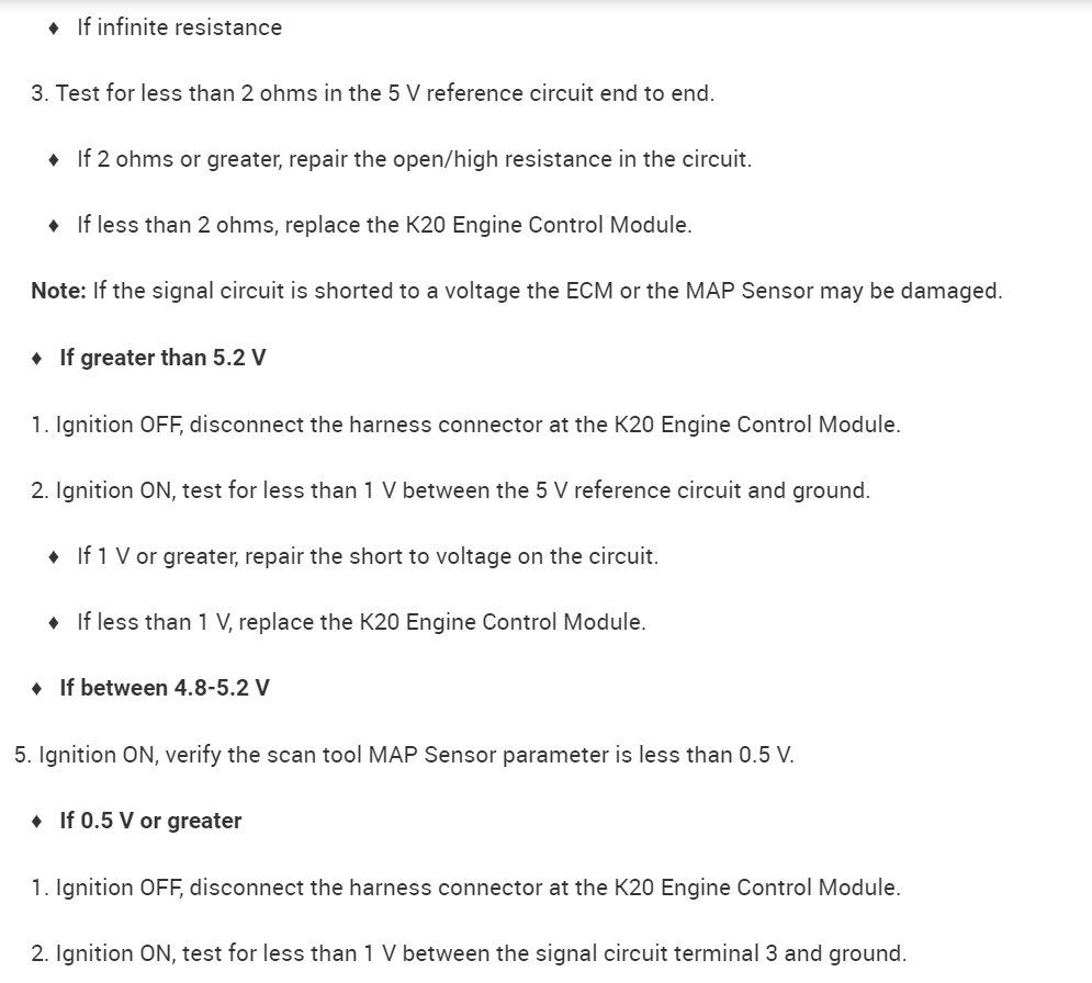

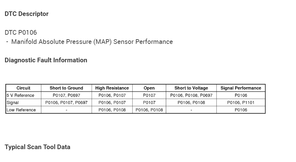

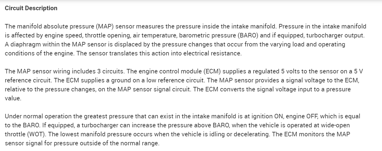

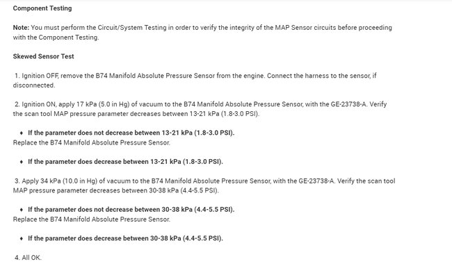

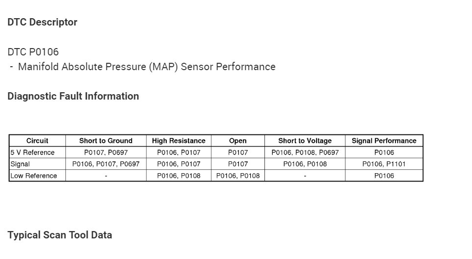

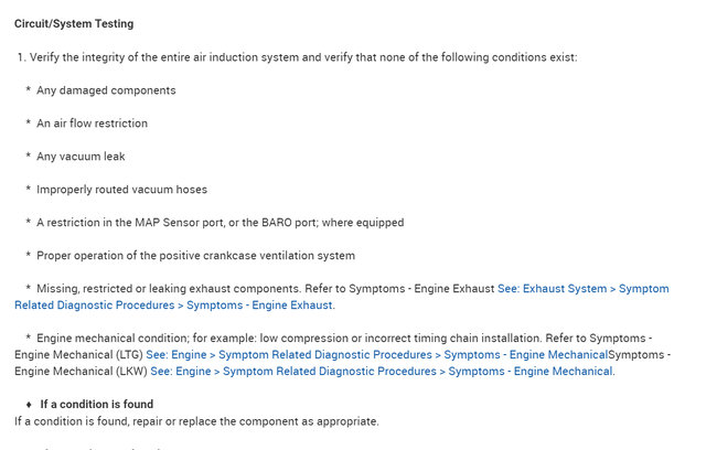

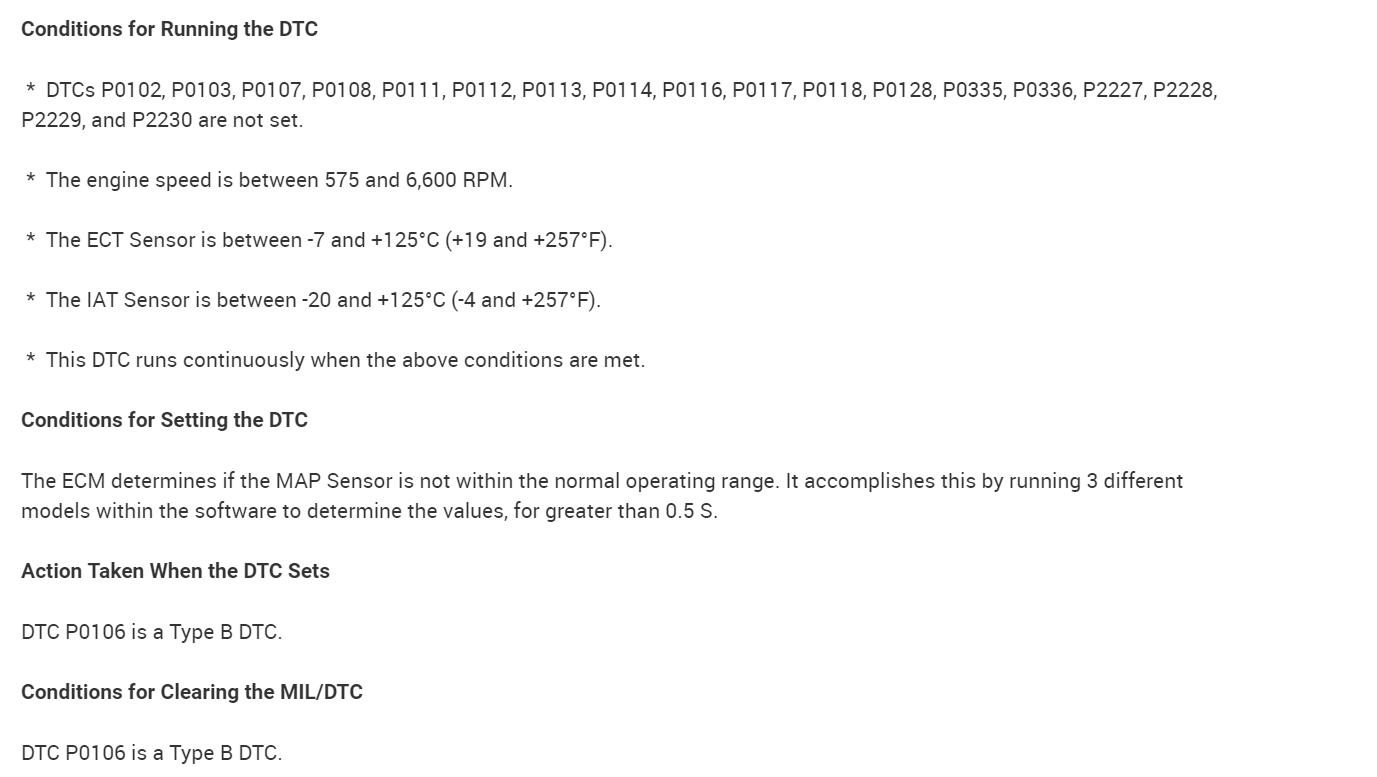

In the diagrams down below I have included the diagnostic troubleshooting guide for your vehicle for Direct Trouble Code (DTC) P0106. Please go through this guide and get back to us with what you are able to find out.
Thanks,
Alex
2CarPros
