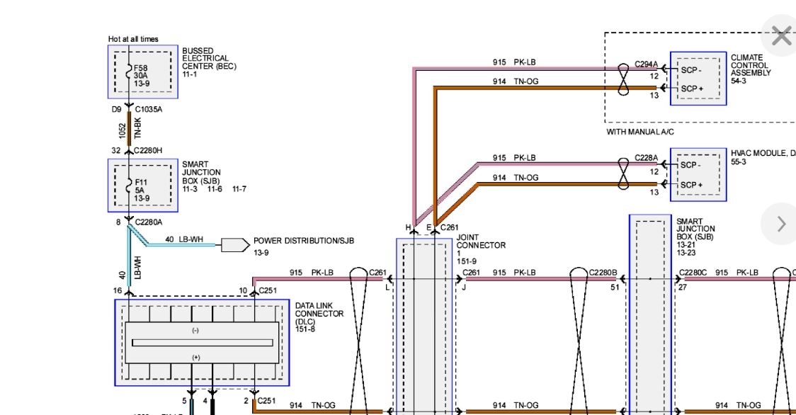

The obd connection is not working.
Nov 8, 2018 at 8:16 AM
Experienced Mechanic
52,796 POSTS
Okay.
I attached a diagram of the connector. There are two fuses that control power to the connector pin 16.
Check those fuses for power on both sides with a test light or voltmeter.
