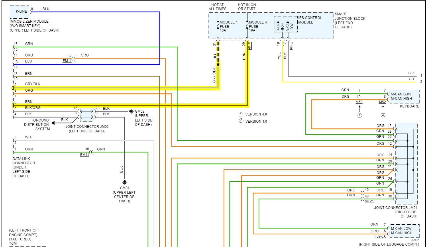

Where can i find the fuse that controls my OBD?
2019 KIA OPTIMA
95,000 MILES • 2WD • AUTOMATIC
RICH2FLY
I’m not getting power to it.
Jul 21, 2022 at 6:50 AM
AL514
  • 5,587 POSTS

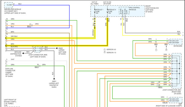

Hello, what model is this and what engine size? It's not a Hybrid I assume, and which pin are you checking for power at the Data Link Connector? This diagram is for a 1.6 Liter Turbo, non-Hybrid model. The highlighted wires are the power to the DLC and also remember pins 4 and 5 are still Ground, so if you have a no communications error, when checking for power, check the two power pins using the two ground pins and make sure all four are working. Pin 16 is no longer the power pin, it's part of the medium speed CAN bus now. Just don't spread the females pins in the DLC, there have been some aftermarket scan tools causing an issue with this.
